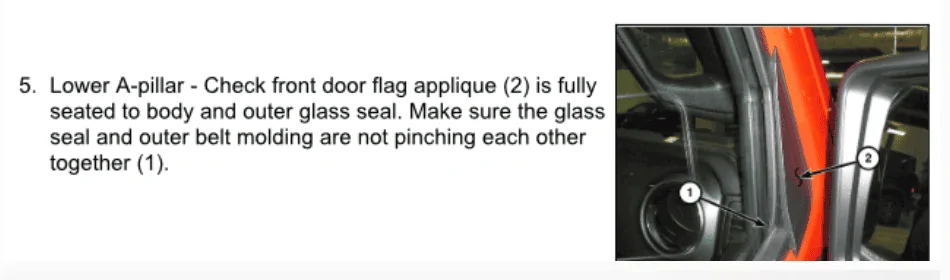

Finally think I got the wind crackling noise solved!!!
Driving this last week the noise was driving me nuts, so I took the time to lean in close while driving at highway speeds, listening to where noise is. Determined source of my driverside crackle noise seemed to come from the door around where the side mirror is. Looking through FCAs documentation, they mention the flag piece (black triangle plastic trim piece). I removed it (by the way two different spring clamps, the top one could possibly fall inside door, mine did) and slightly bent the flag piece so that it sat more flush with the driver door. Since then, no more crackle!
Ndrogo
Nick
Apr 7, 2018
67
Syracuse
Jeep Grand Cherokee
Can you send a pic of what you mean ?
