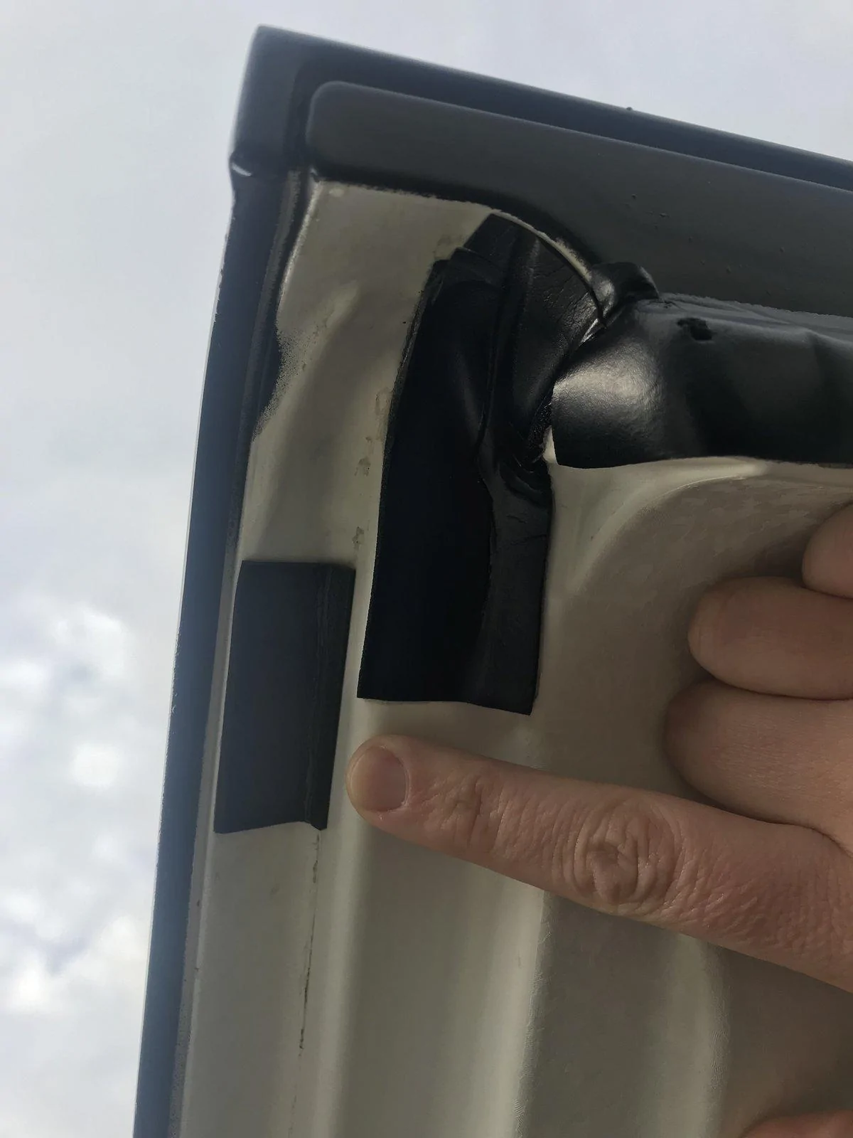

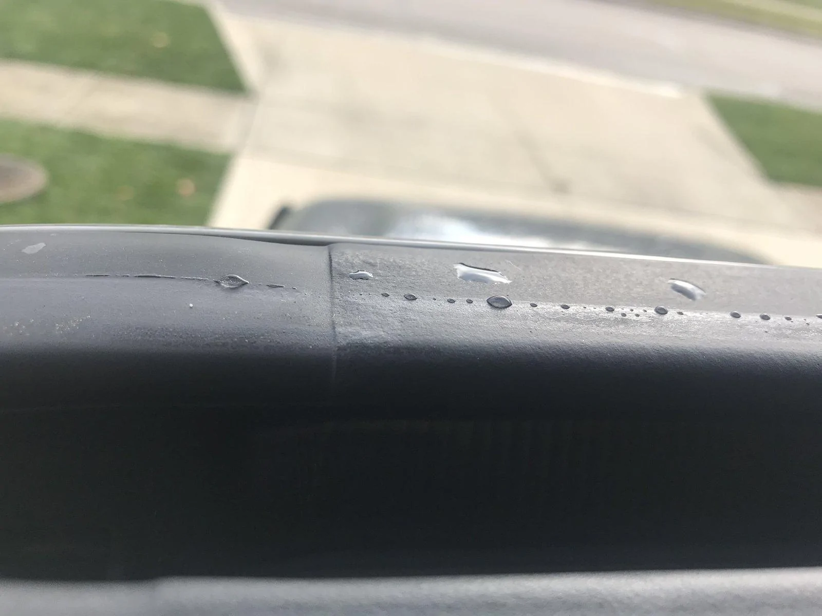

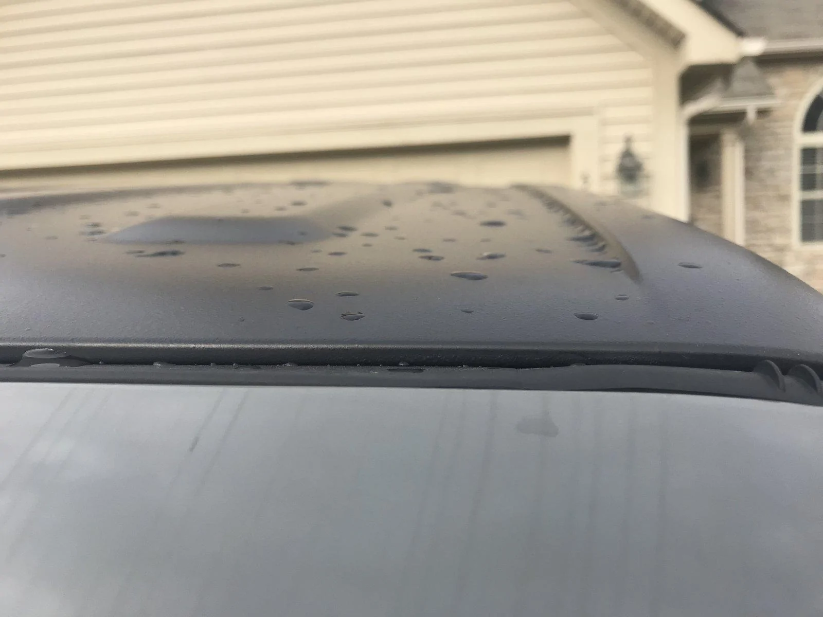

Here's some pictures:
This is the 2" strip of sound tape
Jeep Wrangler JL Hard top wind noise IMG_1203
and Here's the Header Seal transition
Jeep Wrangler JL Hard top wind noise IMG_1204
and here's the dip I mentioned
Jeep Wrangler JL Hard top wind noise IMG_1205

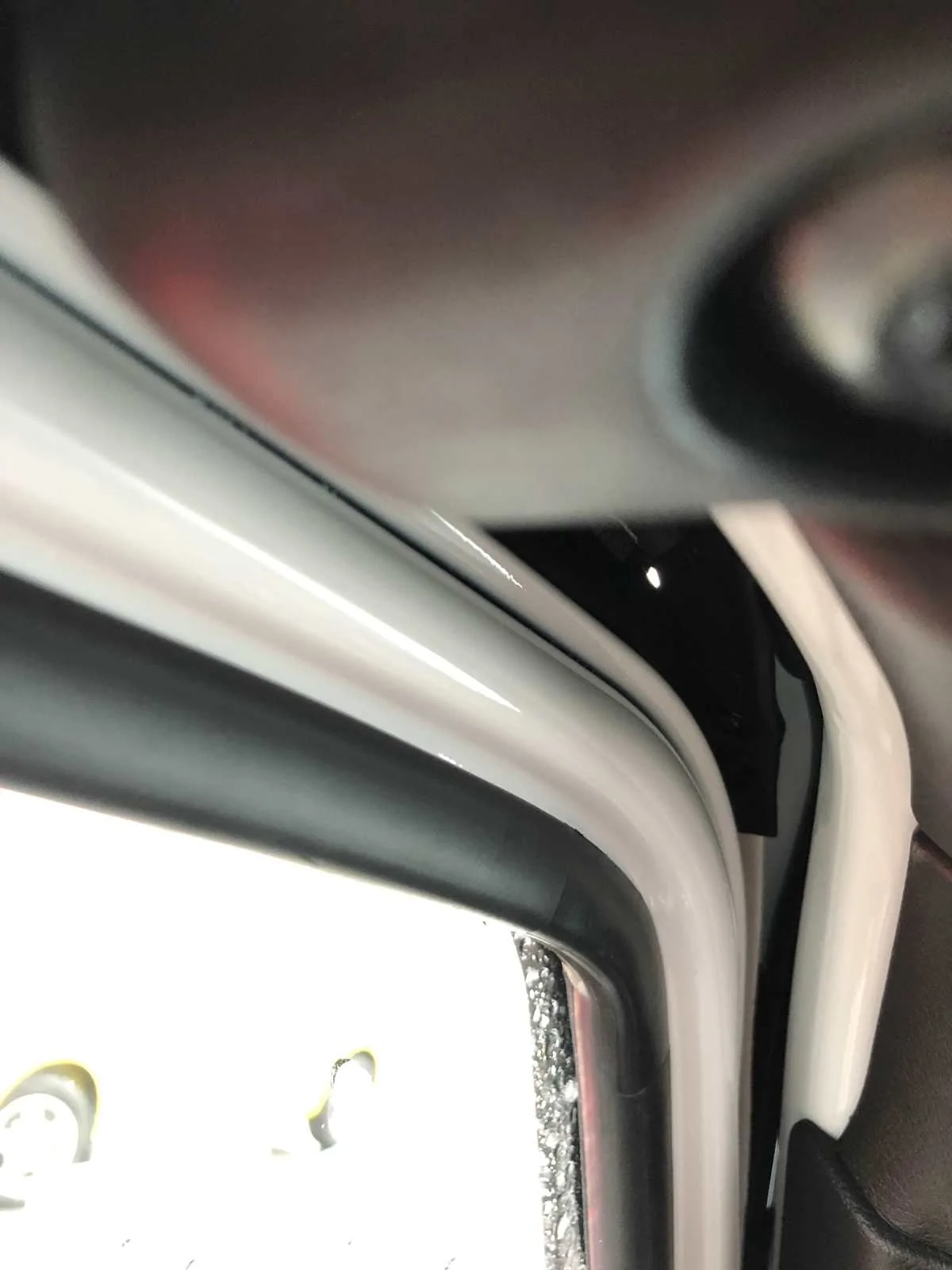

Took delivery of my 2019 JL 2 door sport(soft top) the day before thanksgiving, and the wind noise was driving me insane. Sounded like I had a window cracked.
I looked at the driver side window seal from the inside(where the noise was) and I could see light! This is with the door completely closed.
Jeep Wrangler JL Hard top wind noise ZX5r9R7
I folded the windshield down, loosened all 4 hinge bolts on the back of the windshield, and pushed the windshield toward the gap. It broke the paint free on the windshield and everything moved about 2mm toward the driver side(based on the old paint mark).
Now the wind noise is completely gone and there is no more gap!

How did that pass the dreaded water test?

ya that looks bad. Water is definitely getting in there.
Funnily enough, it was pouring down rain right before I took this pic. That was while I was driving at 65 on the interstate. When I got to work and took the pic not a drop inside the cab or the door seal. No clue how.

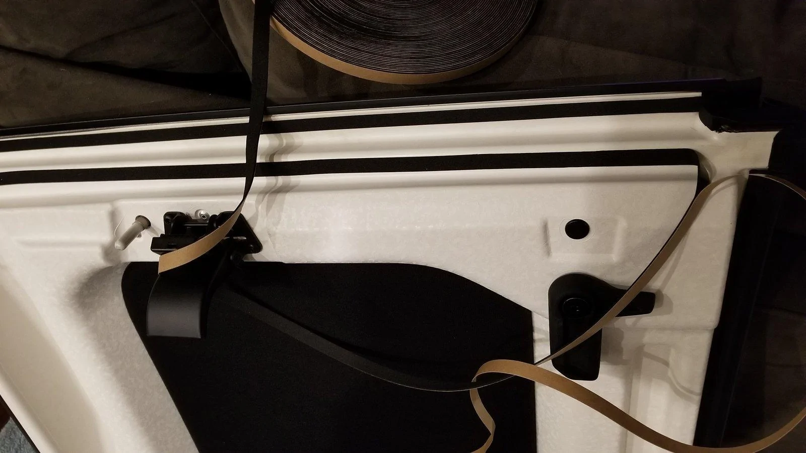

I put some neoprene foam tape across the leading edges of the freedom tops and it's helped the wind noise quiet a bit. Not a luxury sedan quiet, but I like the improvement. @seguerski is on the right track there.
Jeep Wrangler JL Hard top wind noise 20181127_185509-jpg
Now I'll look for something to help the latches as @landj pointed out.
