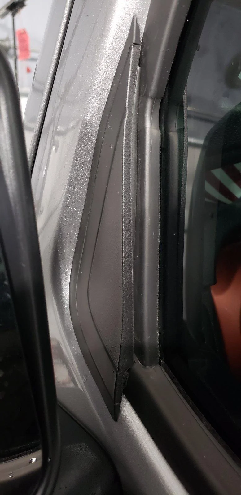

Finally think I got the wind crackling noise solved!!!
Driving this last week the noise was driving me nuts, so I took the time to lean in close while driving at highway speeds, listening to where noise is. Determined source of my driverside crackle noise seemed to come from the door around where the side mirror is. Looking through FCAs documentation, they mention the flag piece (black triangle plastic trim piece). I removed it (by the way two different spring clamps, the top one could possibly fall inside door, mine did) and slightly bent the flag piece so that it sat more flush with the driver door. Since then, no more crackle!
Seguerski many thanks, this was one of my issues. I loose the top clip, but i think it doesnt hold the flag. I did the same plus a small joint of black urethane on the vertical edge, no more noise from the flags.
Also the dealer will change my door seal, its not seating properly between the two hinges. I think when i got the new seal in place then i will be able to remove my ear plugs...

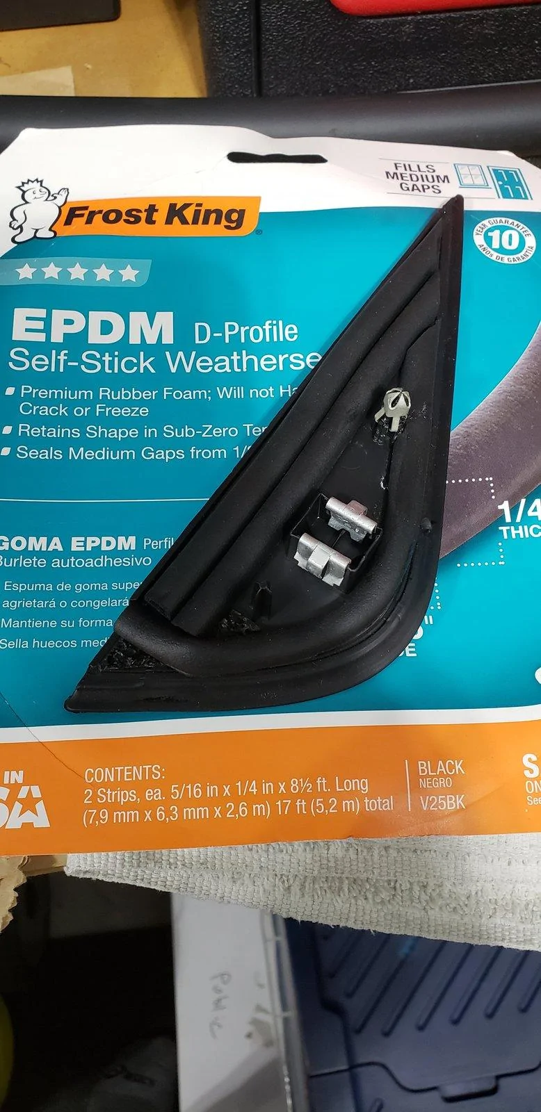

This is how I fixed mine. After removing the "flag" on my driver door, I applied Some 5/16 x 1/4 inch "D-Profile" self stick weather sealant (see images below). 100% of the air leak was gone immediately after doing this. You can see how I applied the weather sealant.
I did have to retrieve the clip from inside the door which only involved 4 screws and fishing the clip out of the bottom of the door with an extended magnet wand.
Very simple mod. Kudos to @seguerski for resurrecting the service manual page.
PS: I did bend the hell out of the top section to ensure it sat as close to the window frame and window as possible.

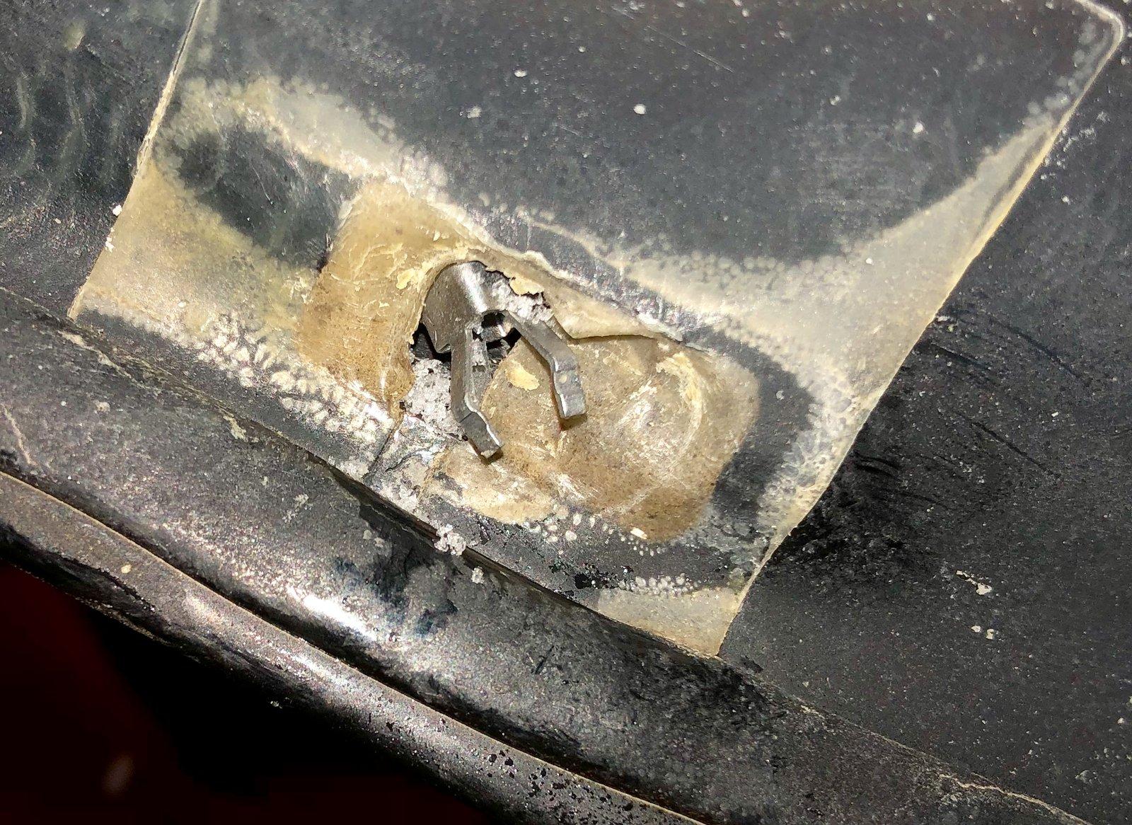

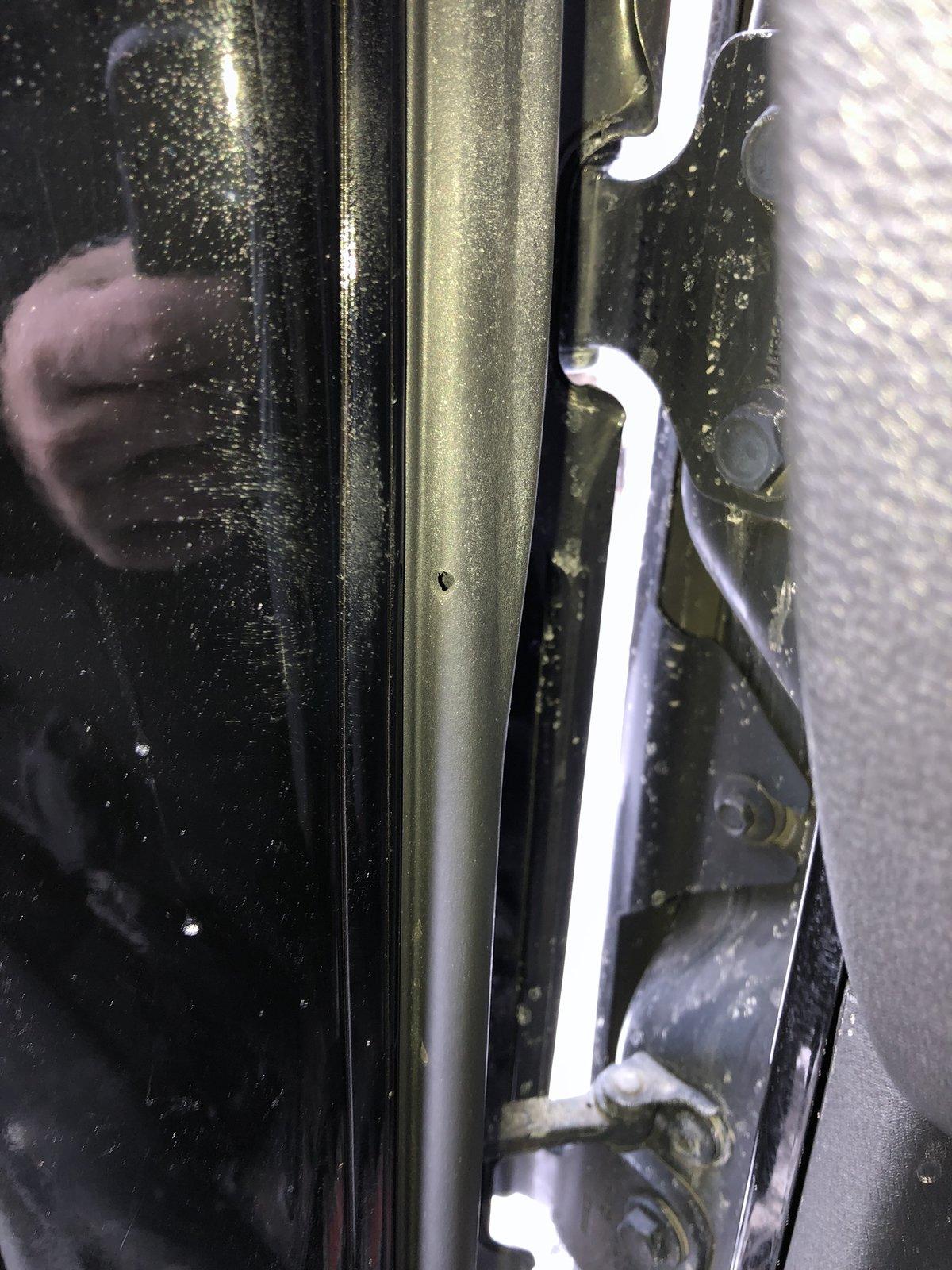

Ok i manage to retreive the flag clip by sweeping a strong magnet outside the door close to the joint (doors are in aluminium) and get it out by the door water drain, 2minutes job. Holes are covered with a flexible tape. No need to remove anything.
