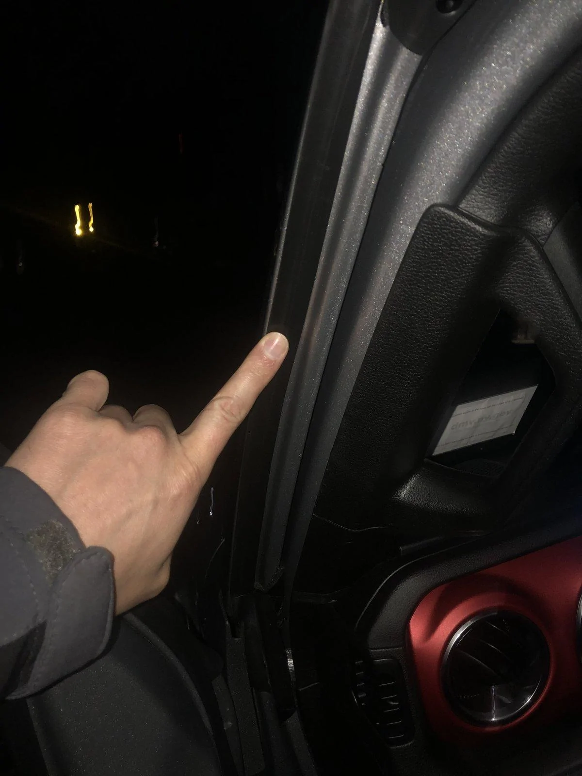

I figured mine out... very easy fix... open the door, look at the channel on the windshield frame, there’s a small gap runs down the window, I added electrical tape running down and it’s all quiet now I’ll take a pic
Interesting that the gap you have between the windshield and the "hoop" is not there. On my 19 there is about a 1/4" gap between the hoop and the windshield frame. Put my tape over this gap and the wind noise abated to the point where I could hear tire noise and the radio was set to 15 and could be heard at highway speeds and with a 20 mph or so cross wind.

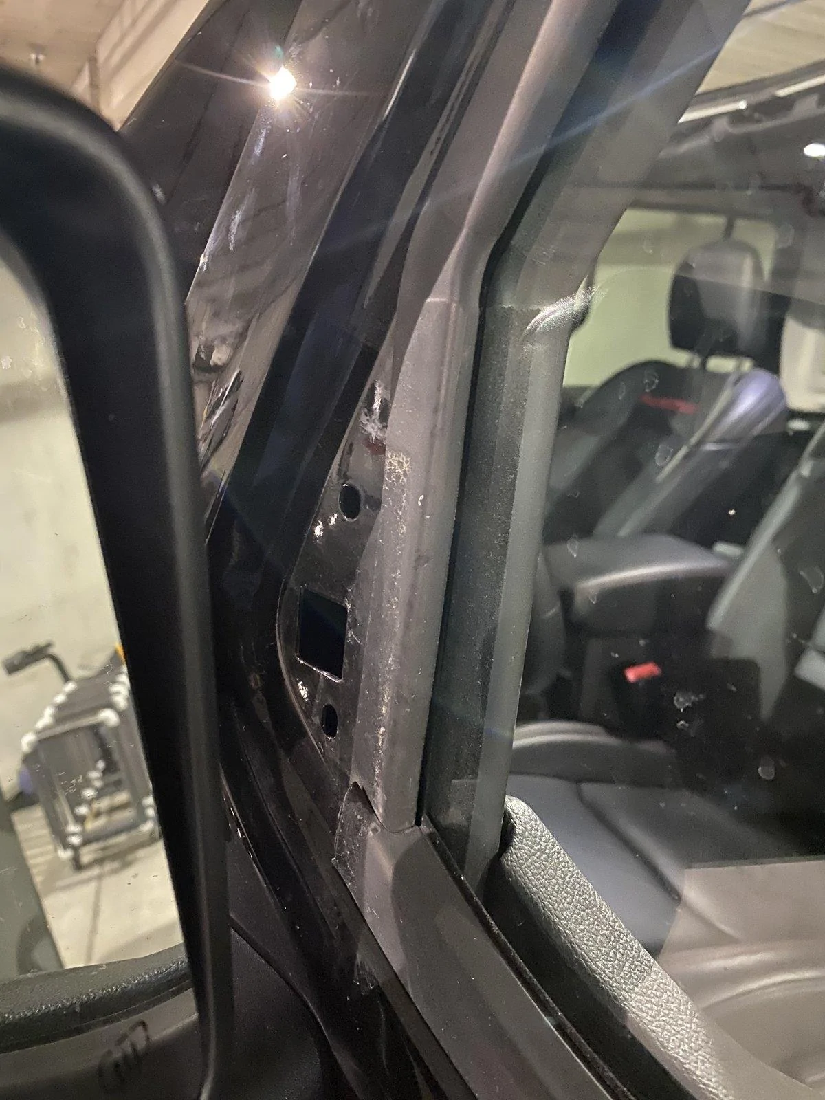

Anyone know this part number - driver side door corner window seal? My JLUR sounded great until this flew off on the highway!

It’s 100% not a Jeep thing. I’ve owned a 2010 and 2014 JKUR’s and the were very quiet compared to my 2018 JLUR. I just fixed it myself by using strips of painters tape over each gap on the hard top 1 at a time starting with the front window working my way back until the noise goes went away, the. I replaced that seal.
