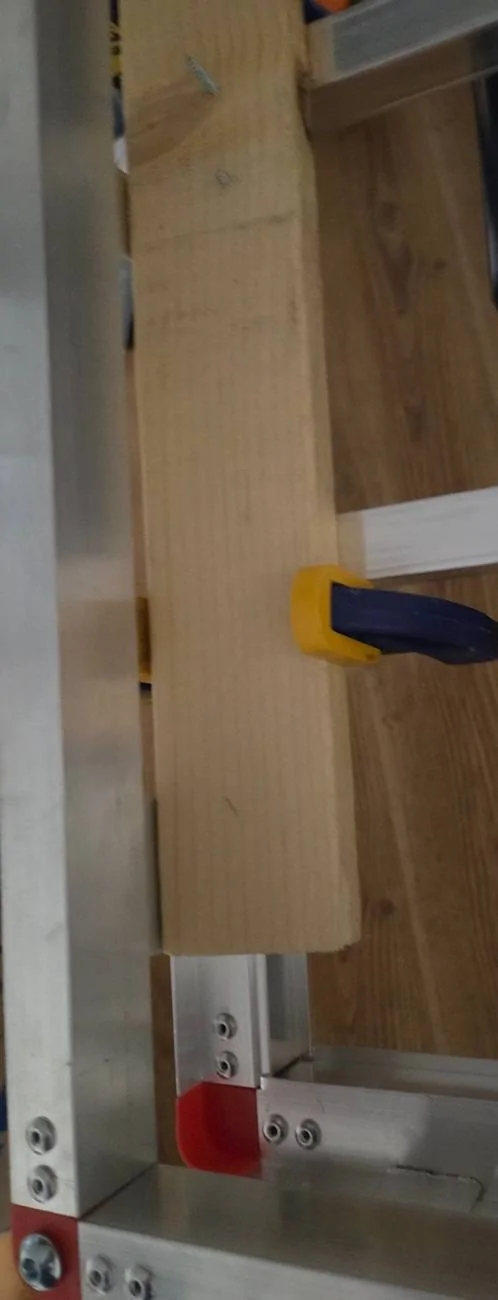

After cut top and placed it back on I used a board and a clamp to push the piece I cut against the edge and used a 3/16 drill bit to drill threw hole that was still there into the freshly cut piece. Then just put the bolts and nuts back on.
