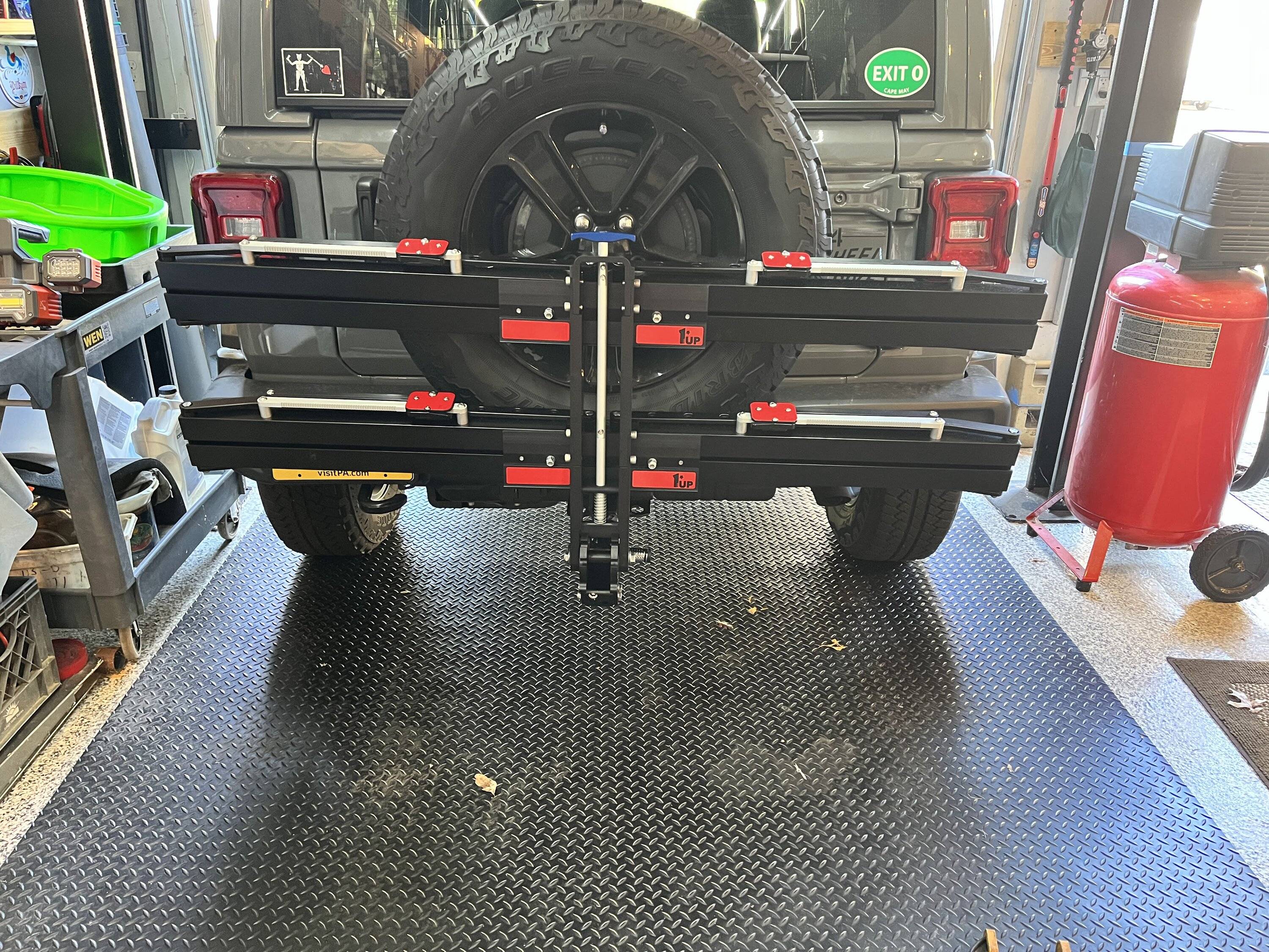

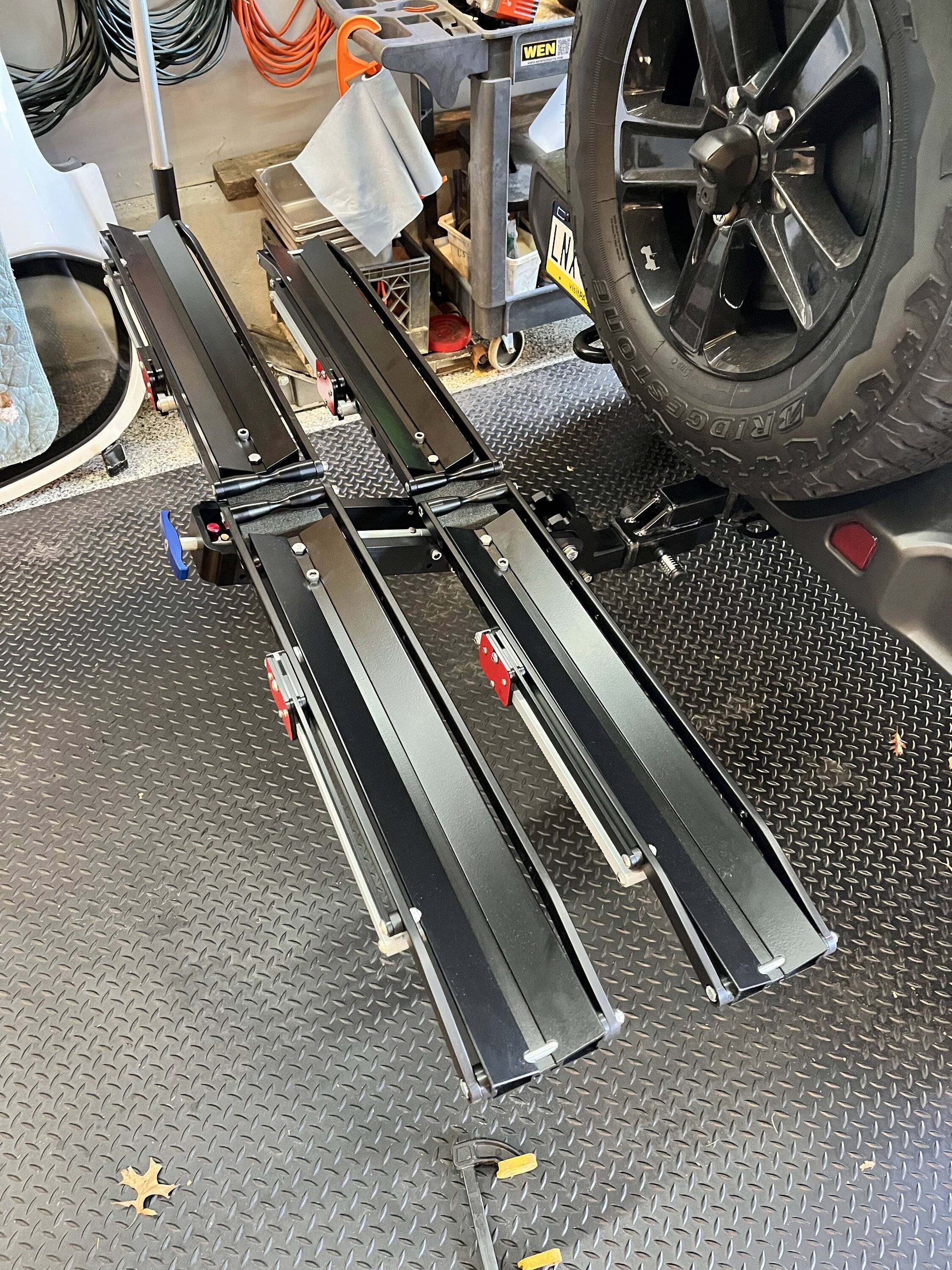

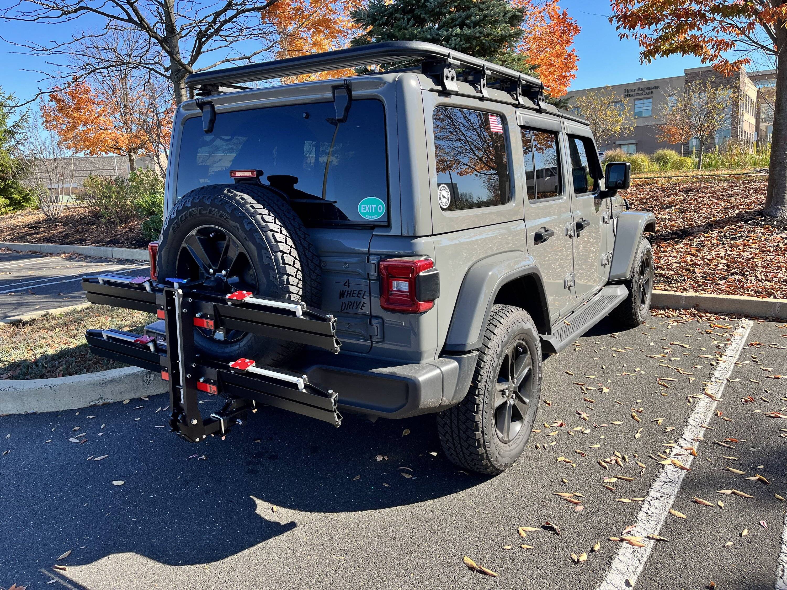

Finally pulled the plug on the 1 up rack thanks to this thread, went with the Equip-D single, with a second bike add on, so when me and the bride are road tripping we can haul 2 bikes, but for the bulk of the year I can remove the add on an just have the single for taking my ebike to the trails (which the wife doesn't do) and with the single the back up camera is not blocked. Really solid unit, built like a tank.

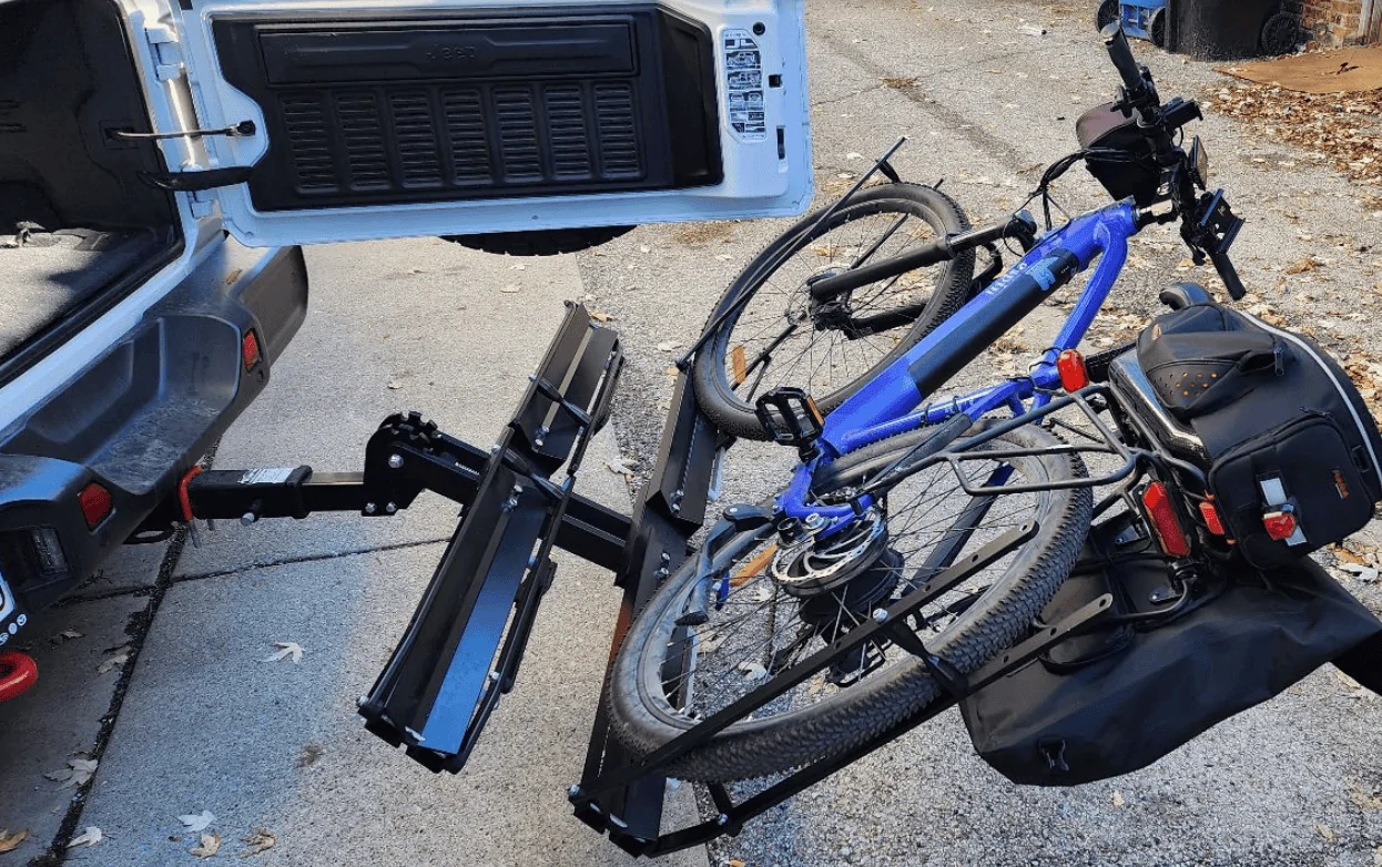

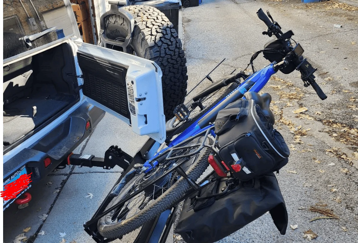

I like to keep the "add-on" on even with 1 e-bike so it allows be to fully open rear gate....

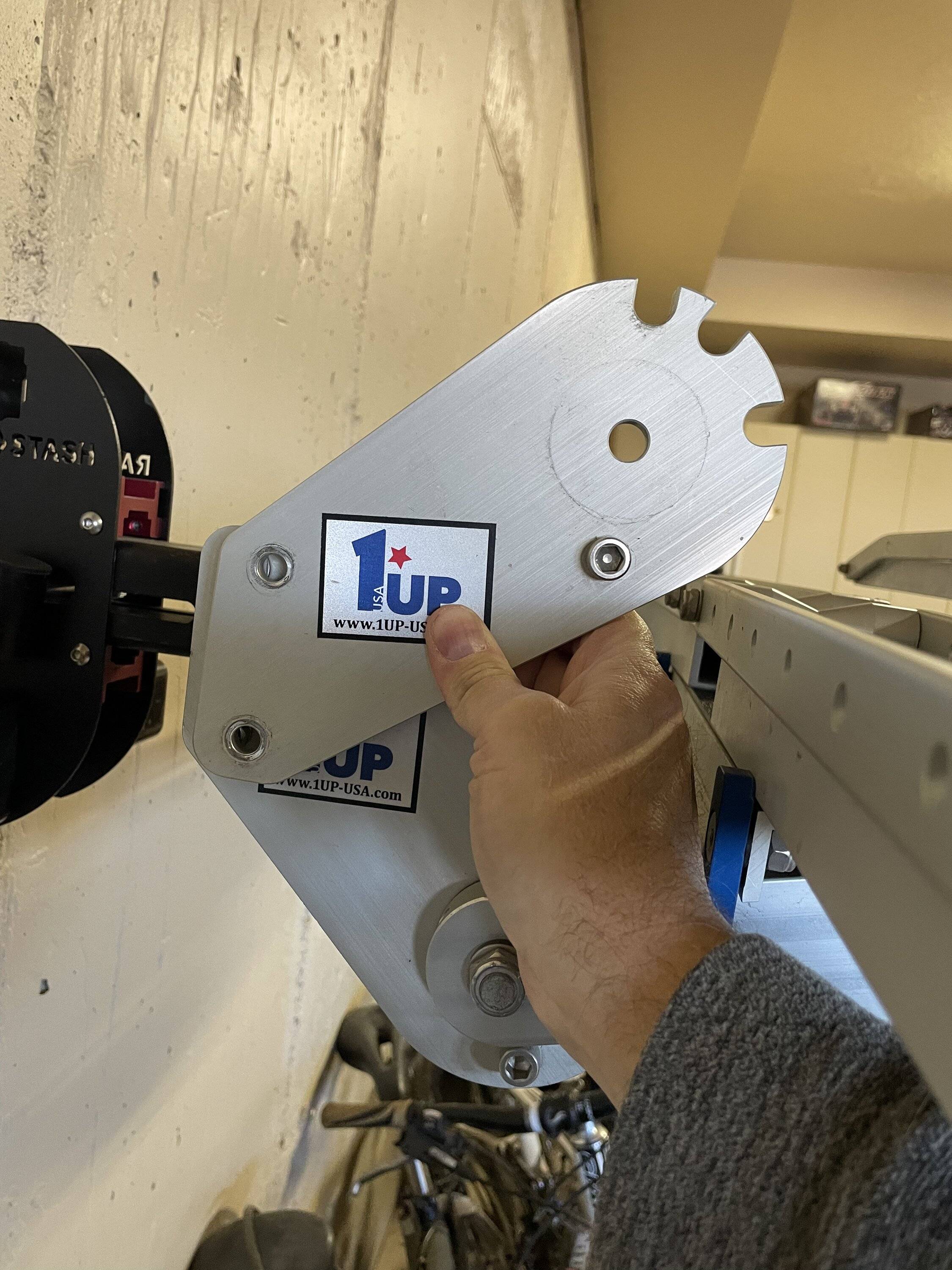

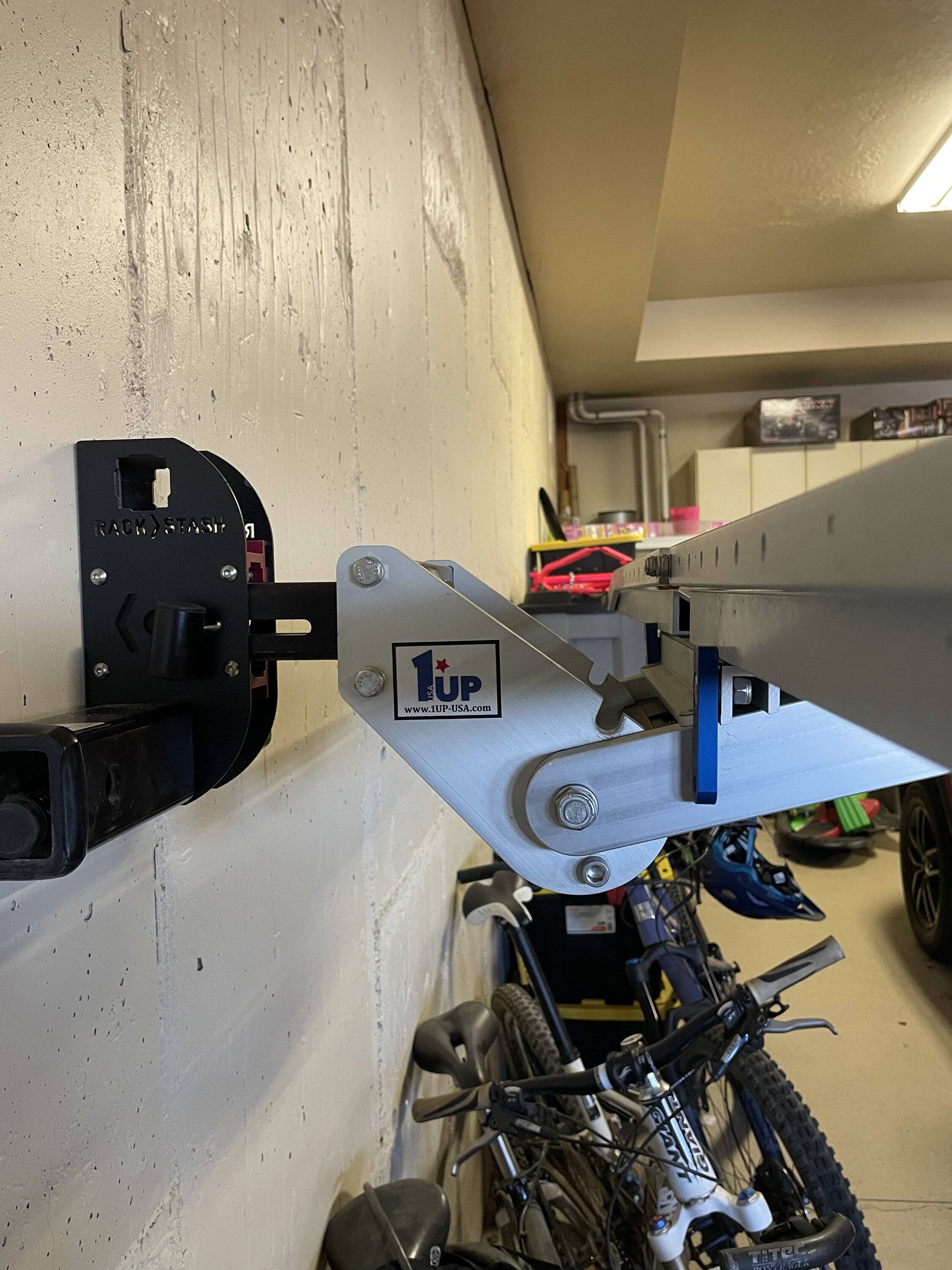

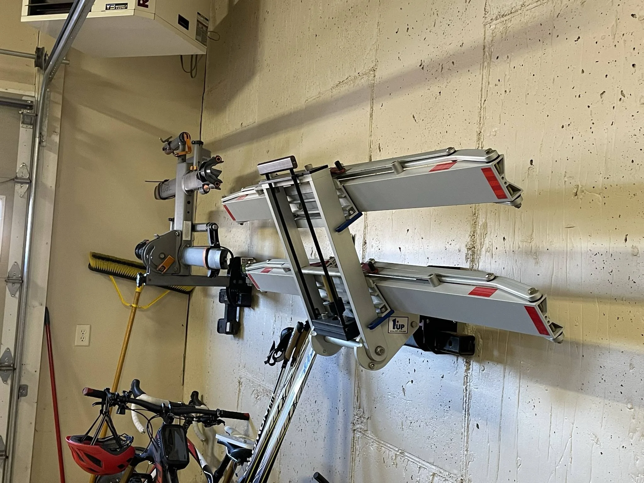

any pictures possible of the the reversed side plate ? Not following the change it makes.....
SGTZn
Jul 7, 2019
84
Park City, Ut
2018 JLUR, 2013 F250 Platinum
Also you can see with rack sits back( vs straight up and down) when in stored position.

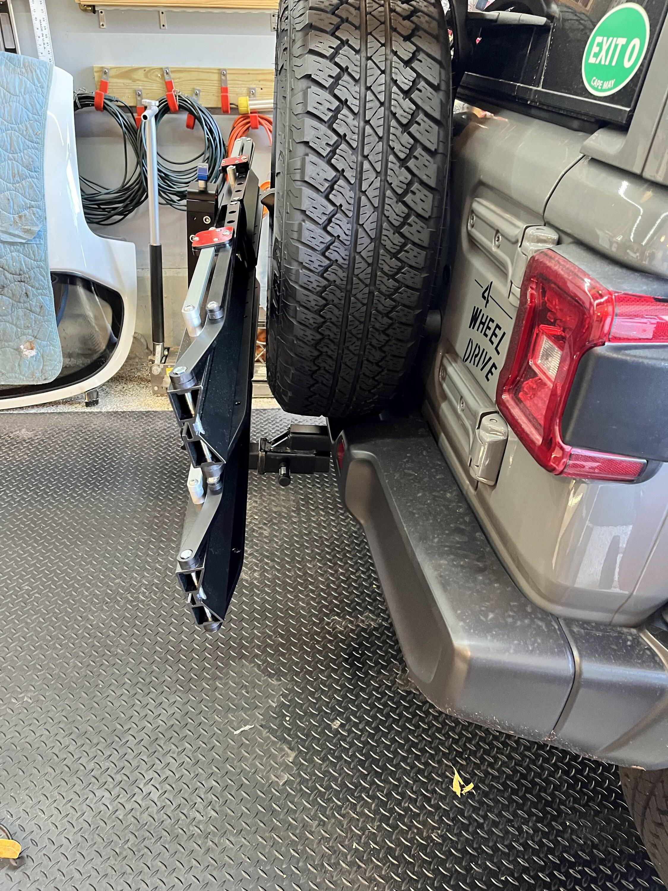

Yeah, that’s the reason I went with the drop hitch, the additional angle would have ruled out parking in the garage. I went with the equip d as it has the lowest bracket, but still about a 1/4 inch too high with out a drop hitch, and that is with a stock tire. Close but no cigar!
