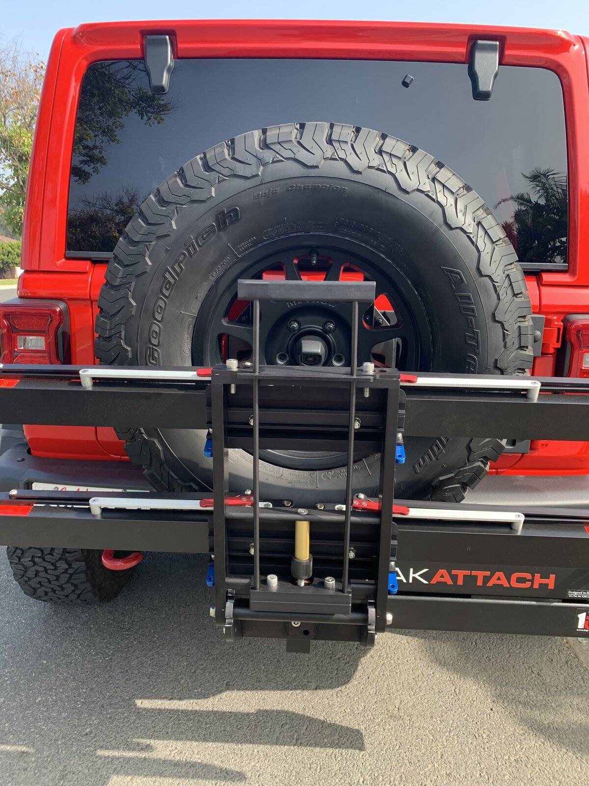

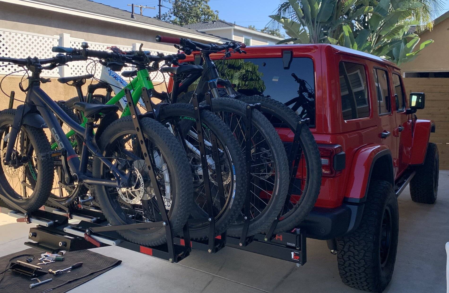

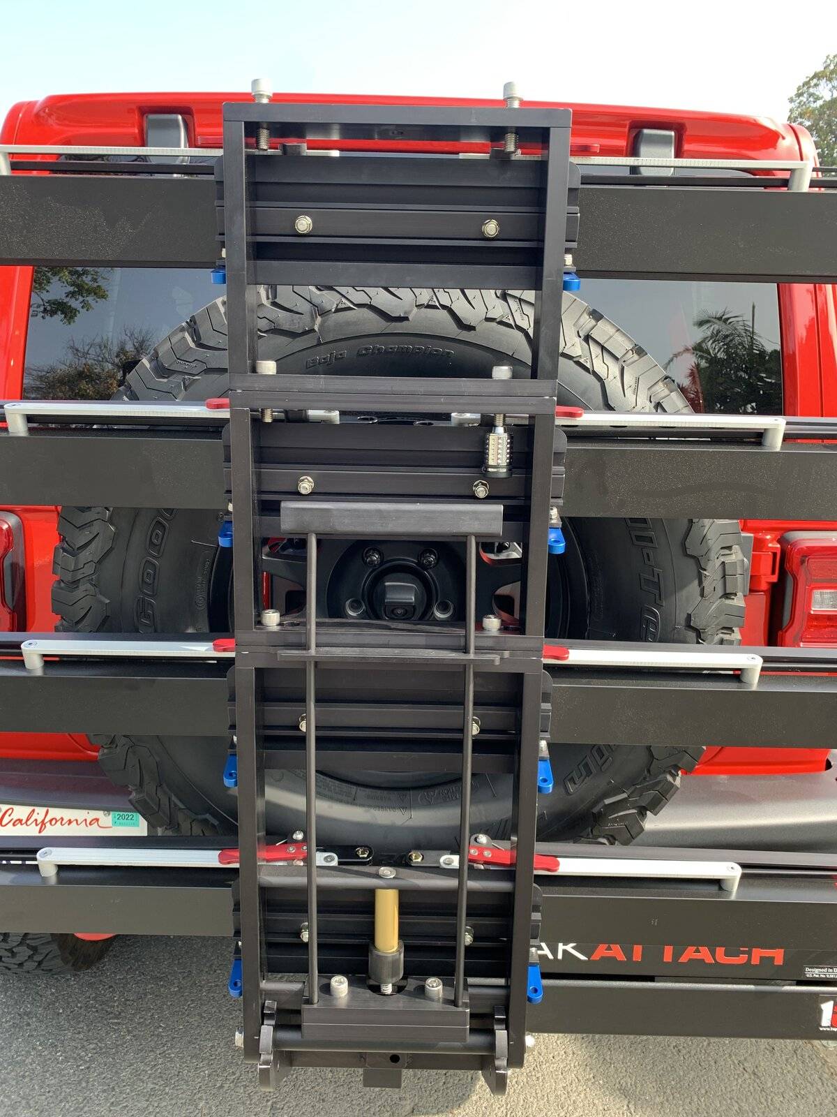

I bought a 4 bike EZ pull. I totally recommend EZ pull, even if you only have 2 bike rack. Not so much to help with reach but to ensure you pull on the latch evenly. 1up notches have tight tolerances and if you don’t pull evenly it’s hard to tilt.
Initially i wanted to leave rack on all the time, but it blocked rear camera so I had to figure out how to remove the rack in parts (in 4 rack configuration it’s an effing beast).
I ended up trimming my 4 bike configuration EZ pull to what I call a 2.5 EZ pull ? and sandwiching the rod guide plate for EZ pull betw double rack and first add on (I was confident this was ok to do but gave 1up a call anyway and they said any length EZ pull works). I left it so handle of EZ pull is about half way betw 2nd and 3rd rack.Works great!
1. Can use same EZ pull in any rack configuration 2,3 or 4)
2. Can remove two add ons easily without swapping EZ pull
3. Handle is about chest height as opposed to forehead height (rack is on lifted Jeep w big tires) so easier physically to engage (particularly for the mrs who’s only 5’2”).
4. Gave me the extra space I wanted to get my whole hand around handle (originally there was prob an inch or so betw handle n back of rack)

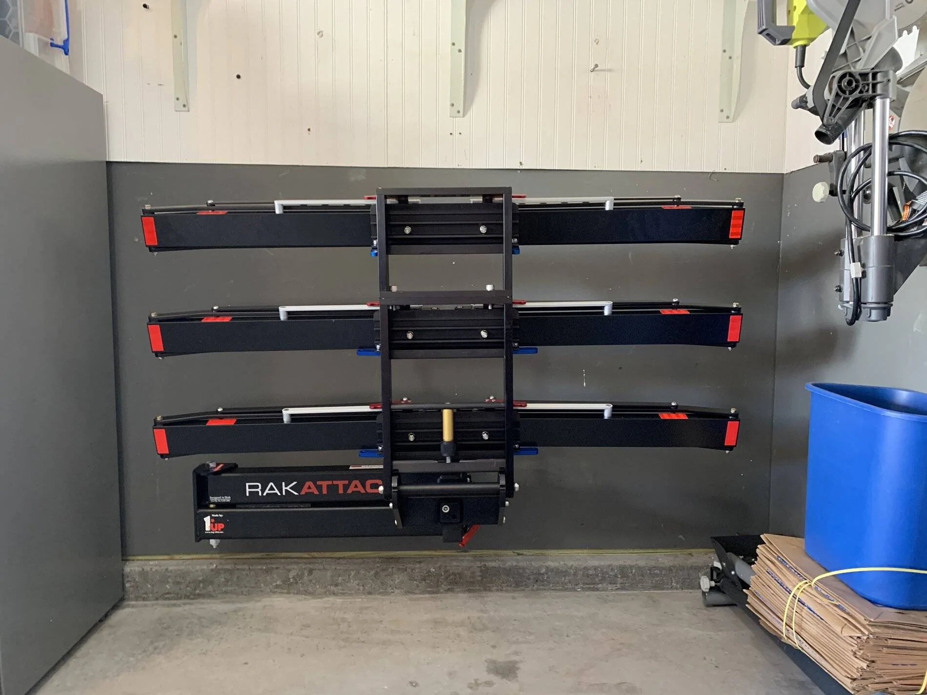

5. Now I can easily carry the rack to and from garage in two parts. First take off 2 add ons, then remove double rack (two ~45 lbs pieces rather than carrying an awkward 90lb single piece)
Check out EZ pull in 2 and 4 bike configuration. I might trim it a bit more but I wanted to be conservative on first cut ?

That's brilliant - I love it! I guess I'll be sending more cash to the fine folks at 1up. I'm flying to TN in a couple days to take delivery, so a couple higher priorities in the pipeline! Until then, my rack patiently waits in the garage.
Jeep Wrangler JL Hitch Bike Rack recommendations? 3790103B-D0D2-49F8-809F-EB9C2CBB95F6
Based on your pix, I think I may go with a "2.25" or so. Just enough clearance for the hand in double configuration, but still easy to operate in triple configuration.
Thanks for sharing!
