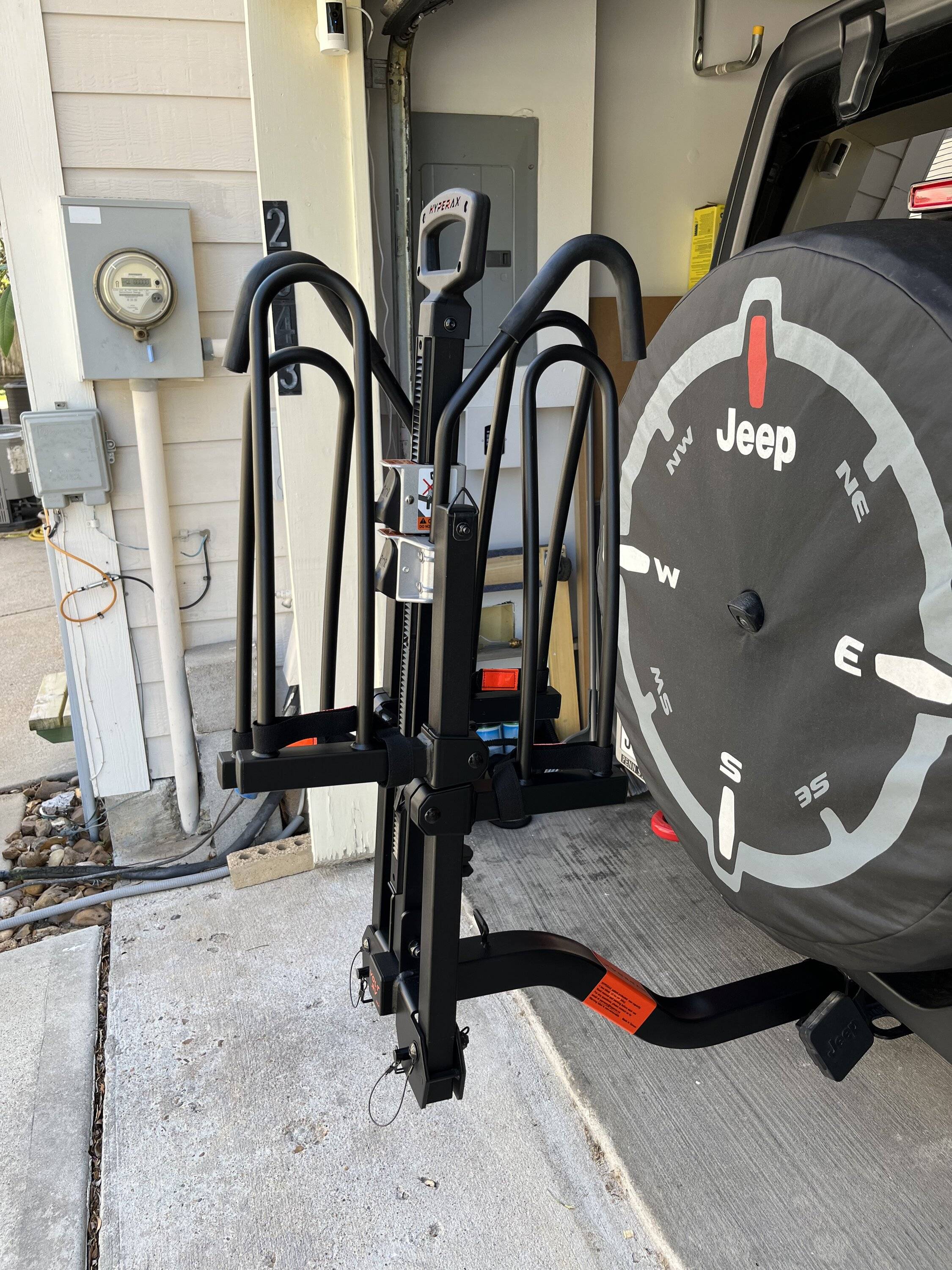

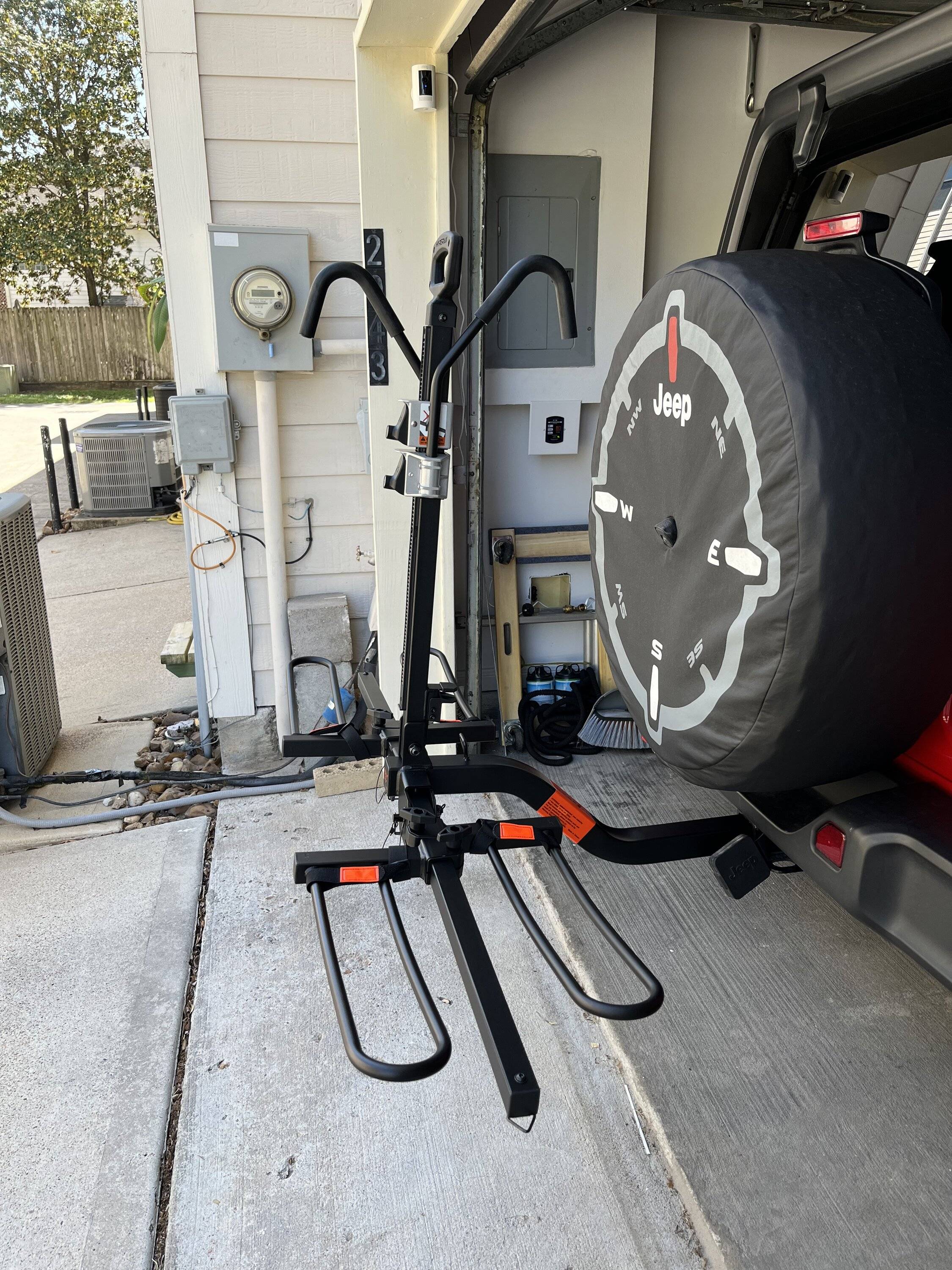

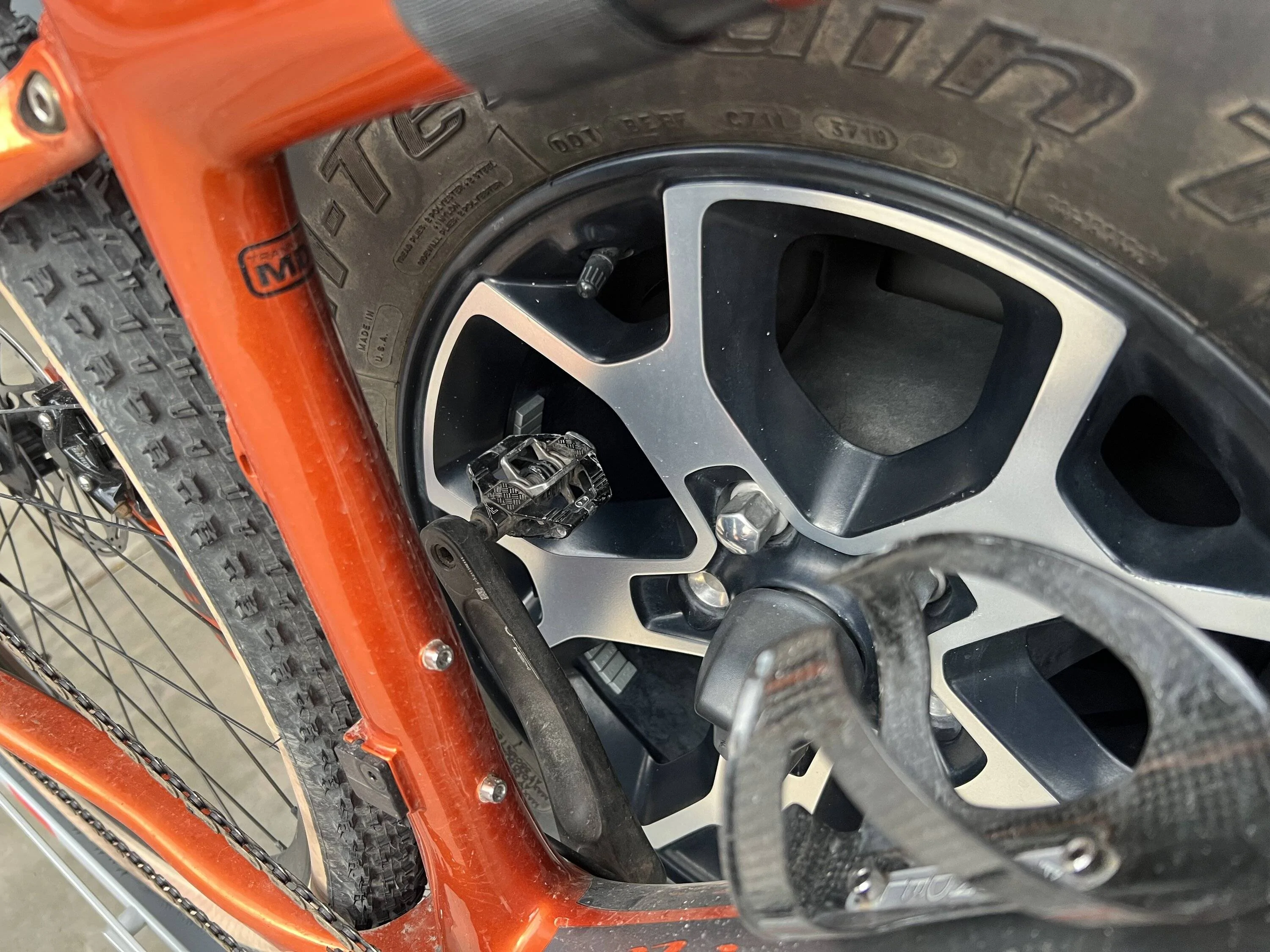

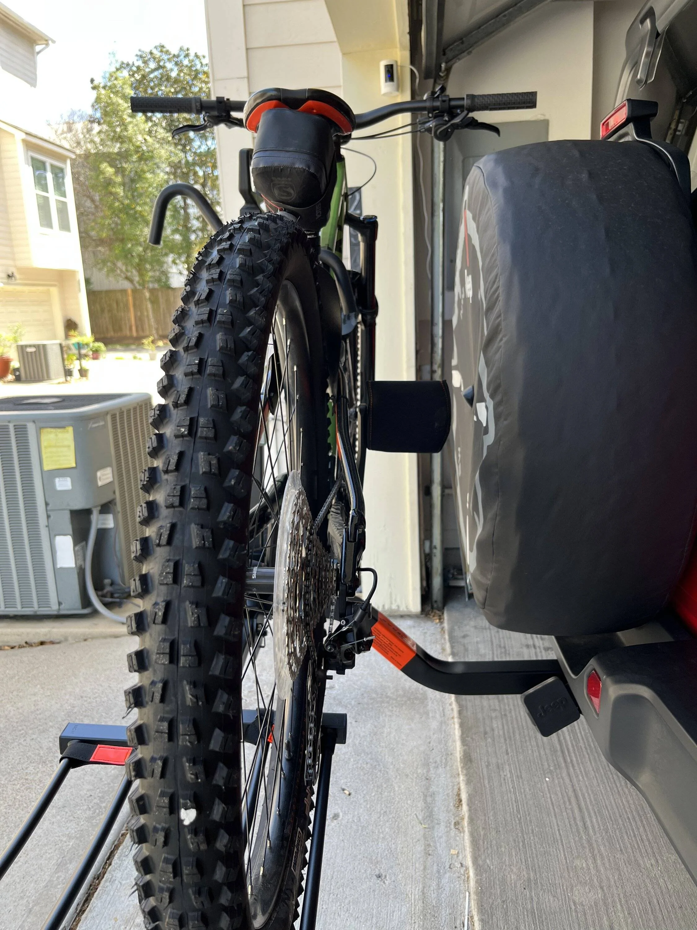

I got a RV rated hitch rack from Amazon from a manufacturer called Hyperax for $330. I wanted a RV rated one since they’re more solidly built. It definitely has enough clearance behind the spare tire. Even with the bike pedal positioned all the way up, there’s clearance. It’s also nice in that it all folds up and has a carrying handle. There’s also built in locks, although the hitch lock feels cheap. The downside is that the tailgate can only be opened a small bit before the spare tire hits the center post (even when folded down). For reference, the bike in the picture is a small frame with 29’s.
They also make non-RV rated carriers with similar dimensions at a lower price.
HYPERAX Volt RV lite RV Rated Hitch Mounted 2 Bike Rack Carrier for RV,Camper,Motorhome,Trailer,Toad with 2" Class 2 or Higher Tow Hitch Receivers -Fits Up to 2X55 lb Bikes with Up to 3" Fat Tires https://a.co/d/bZ4f05b

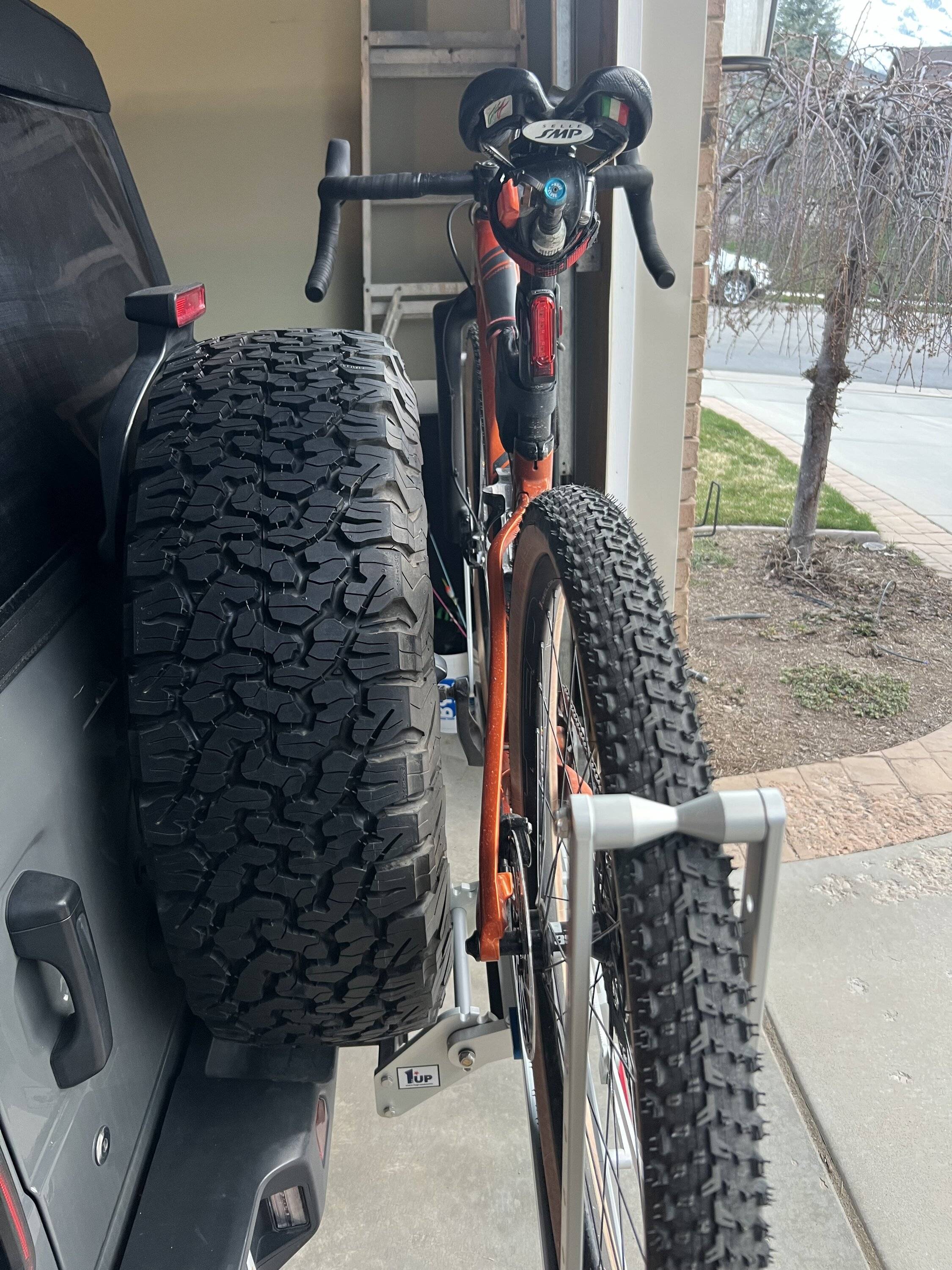

1Up definitely has been my favorite. I do miss the work stand on my Kuat but other than that, 1Up is superior in every way.
I didn’t want to use a hitch extension, as I take my rack on and off often and didn’t want to deal with messing with the extension and the clunky hitch stabilizer.
Fortunately it works without one. At least my gravel bike. With careful pedal placement (or take it off). Mountain bike handlebars may be a problem.

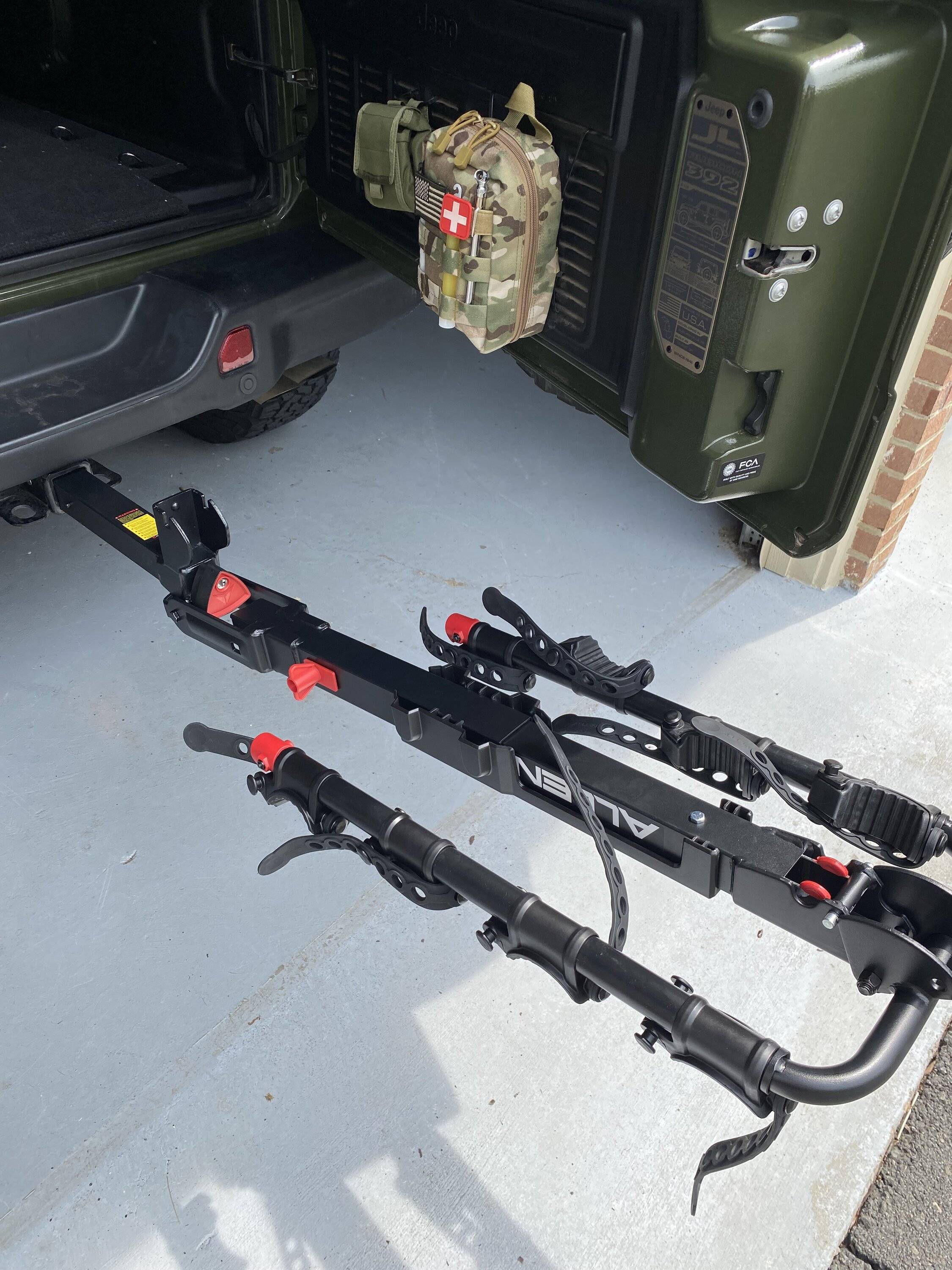

I bought an Allen 400QR. It is a 4 bike rack for 200 bucks. Simple to install and operate, easy in and out of the hitch, and it folds down so the tailgate clears.
