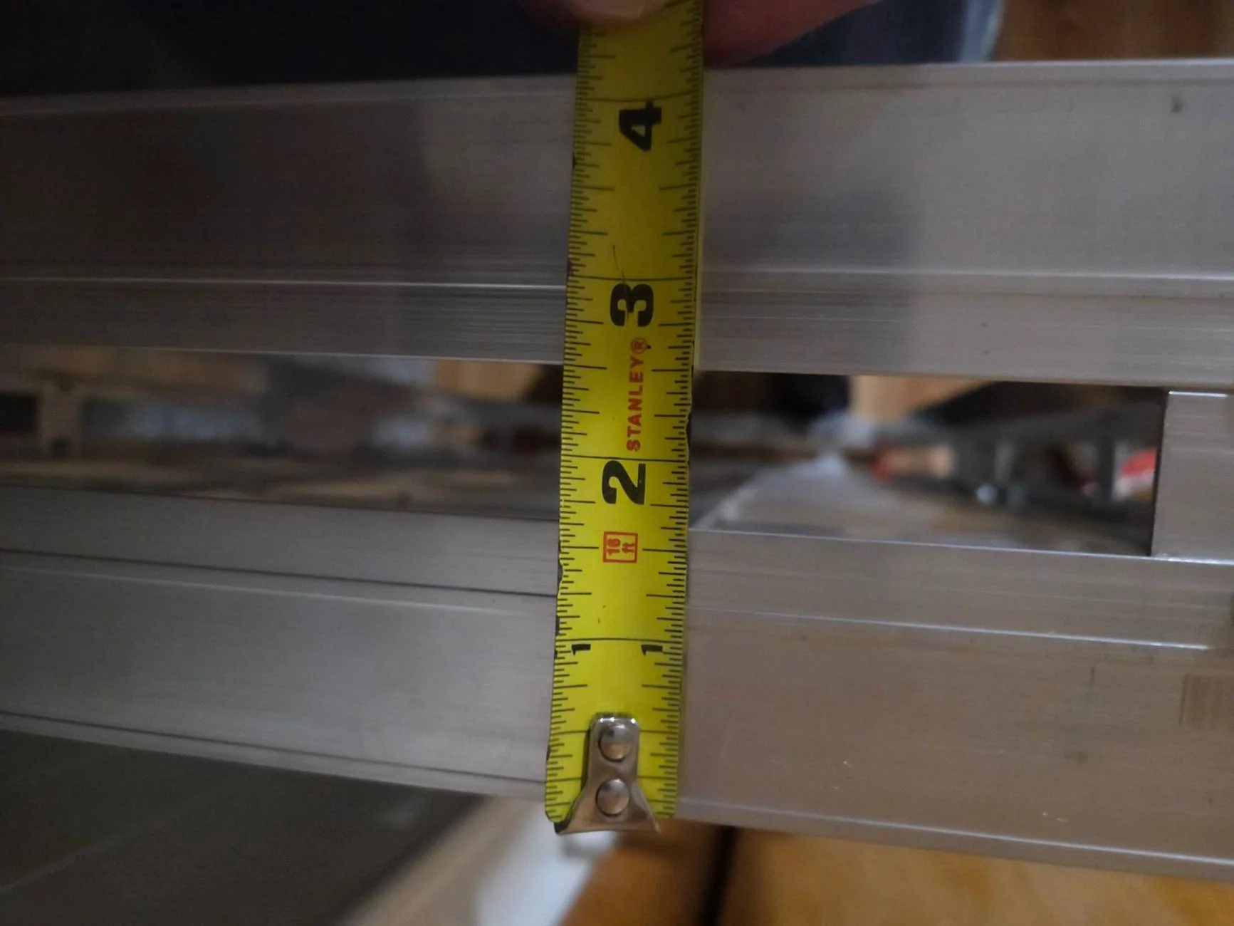

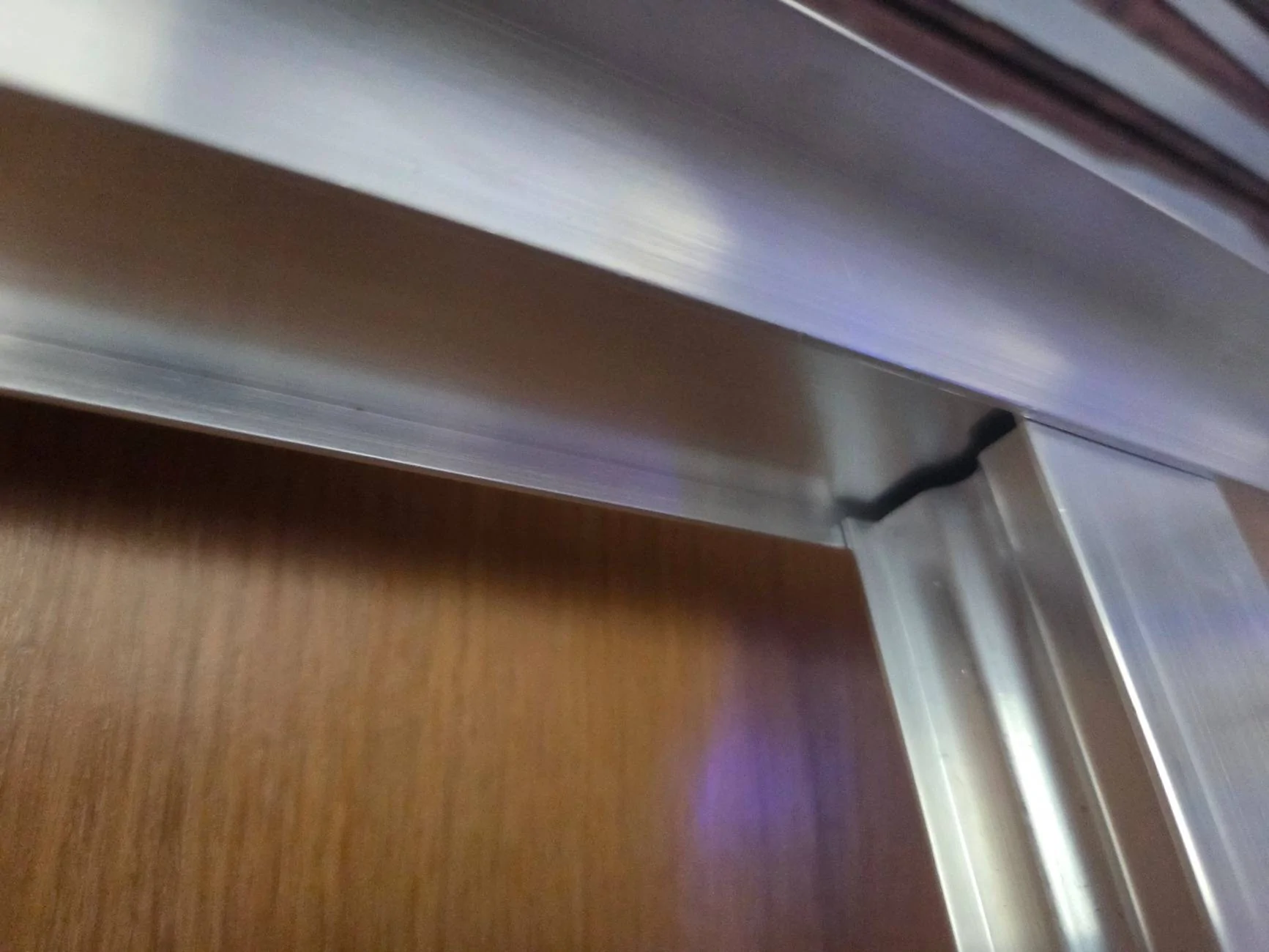

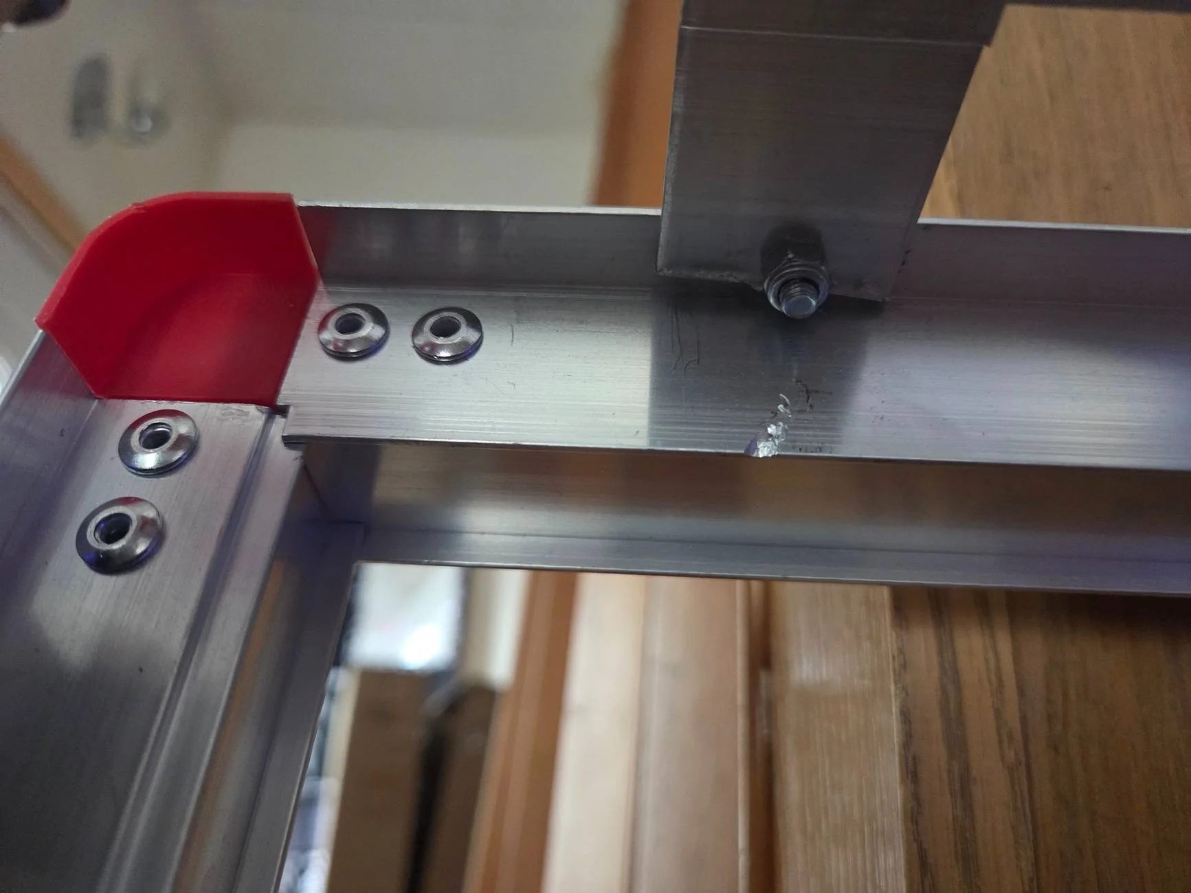

The walls were to tall for it to work on my 2024 rubicon so I decided to chop it. After it was assembled I measured down 3 inches from top all the way around
Jeep Wrangler JL Harbor freight hitch rack modifications DIY 1000008148
Chopped it with an angle grinder then drilled new holes and bolted the bottom back on
Jeep Wrangler JL Harbor freight hitch rack modifications DIY 1000008166
This got me to about 4 inches of height and it now works perfect
Jeep Wrangler JL Harbor freight hitch rack modifications DIY 1000008176
Jeep Wrangler JL Harbor freight hitch rack modifications DIY 1000008177
This took about 2 hours all together but that included time to figure it out. All together for under 100 dollars I am very happy with this rack.

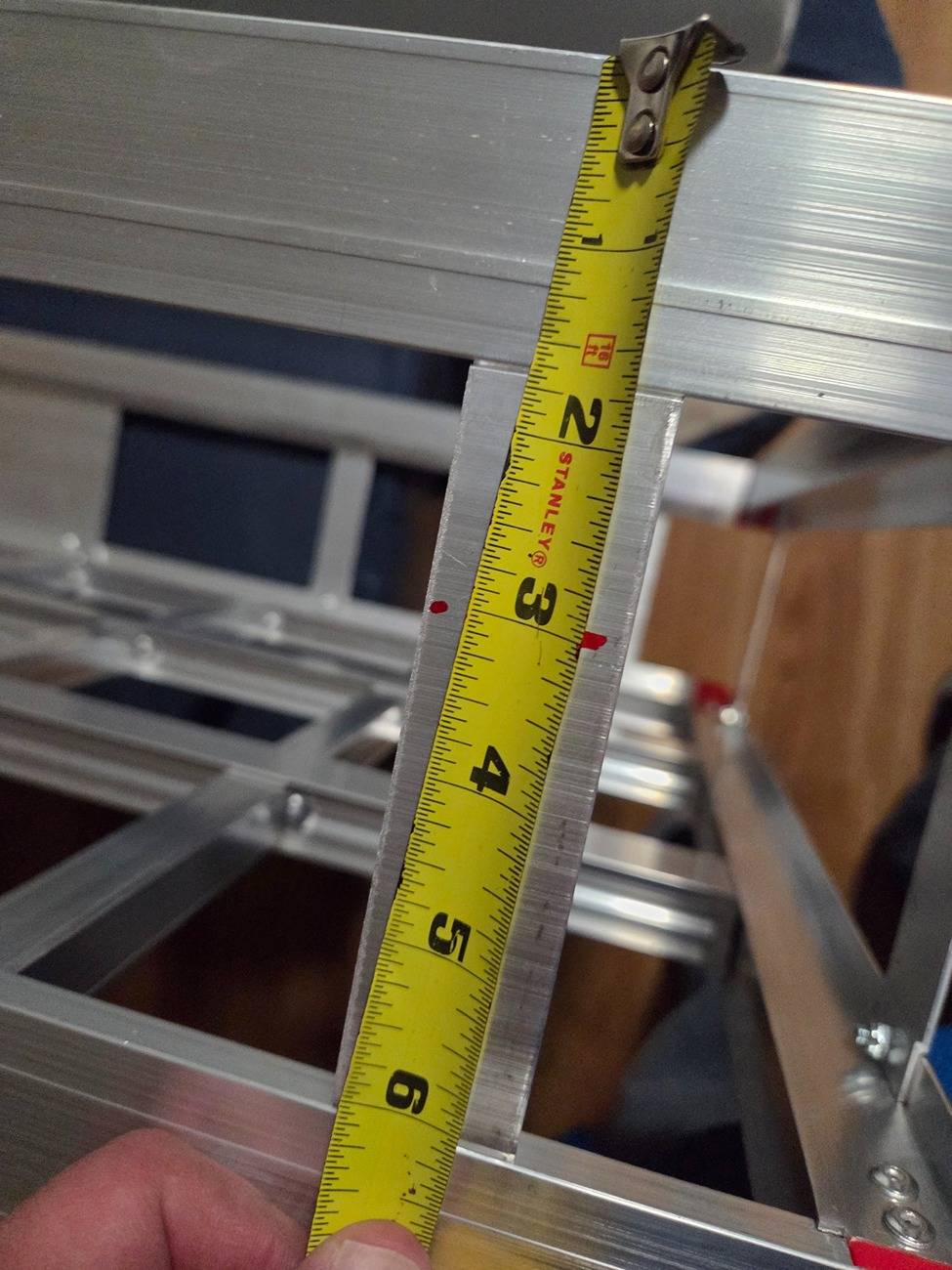

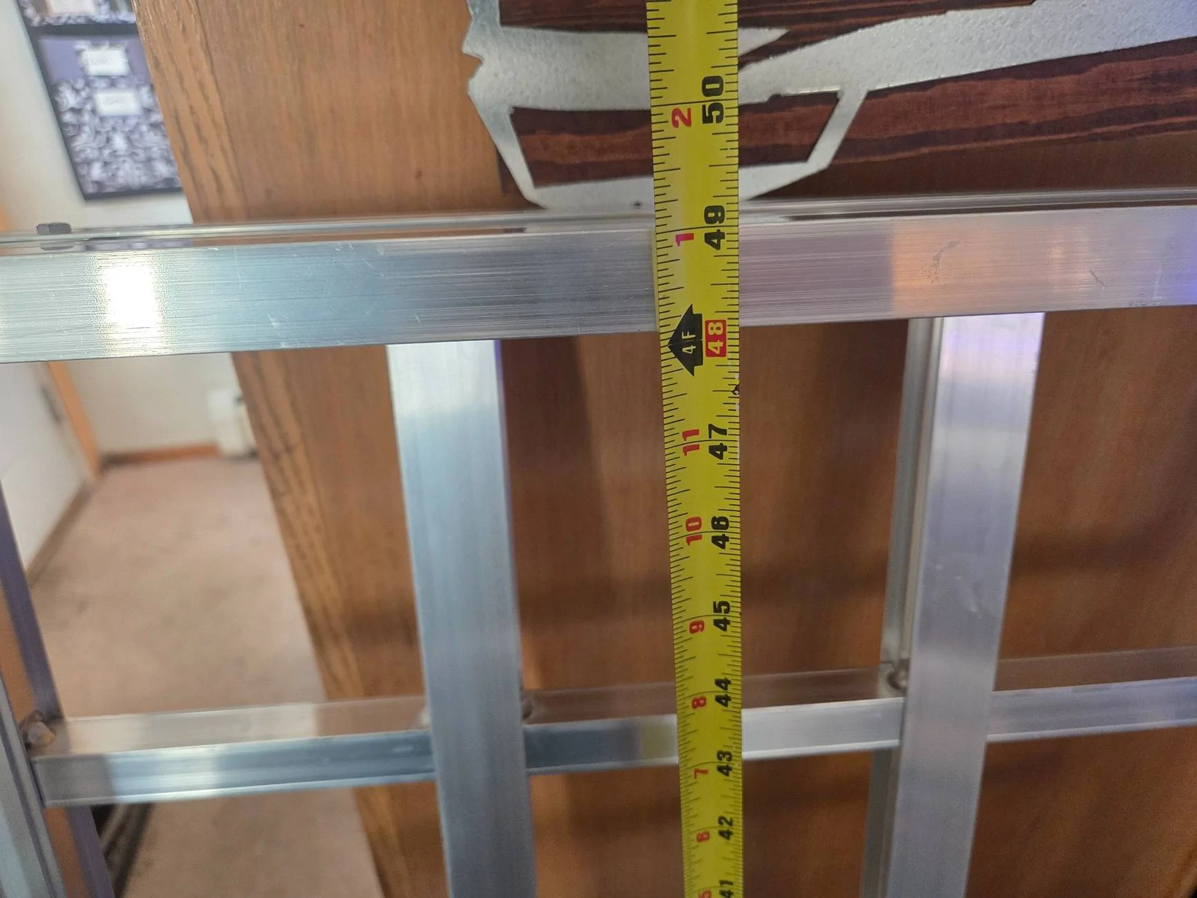

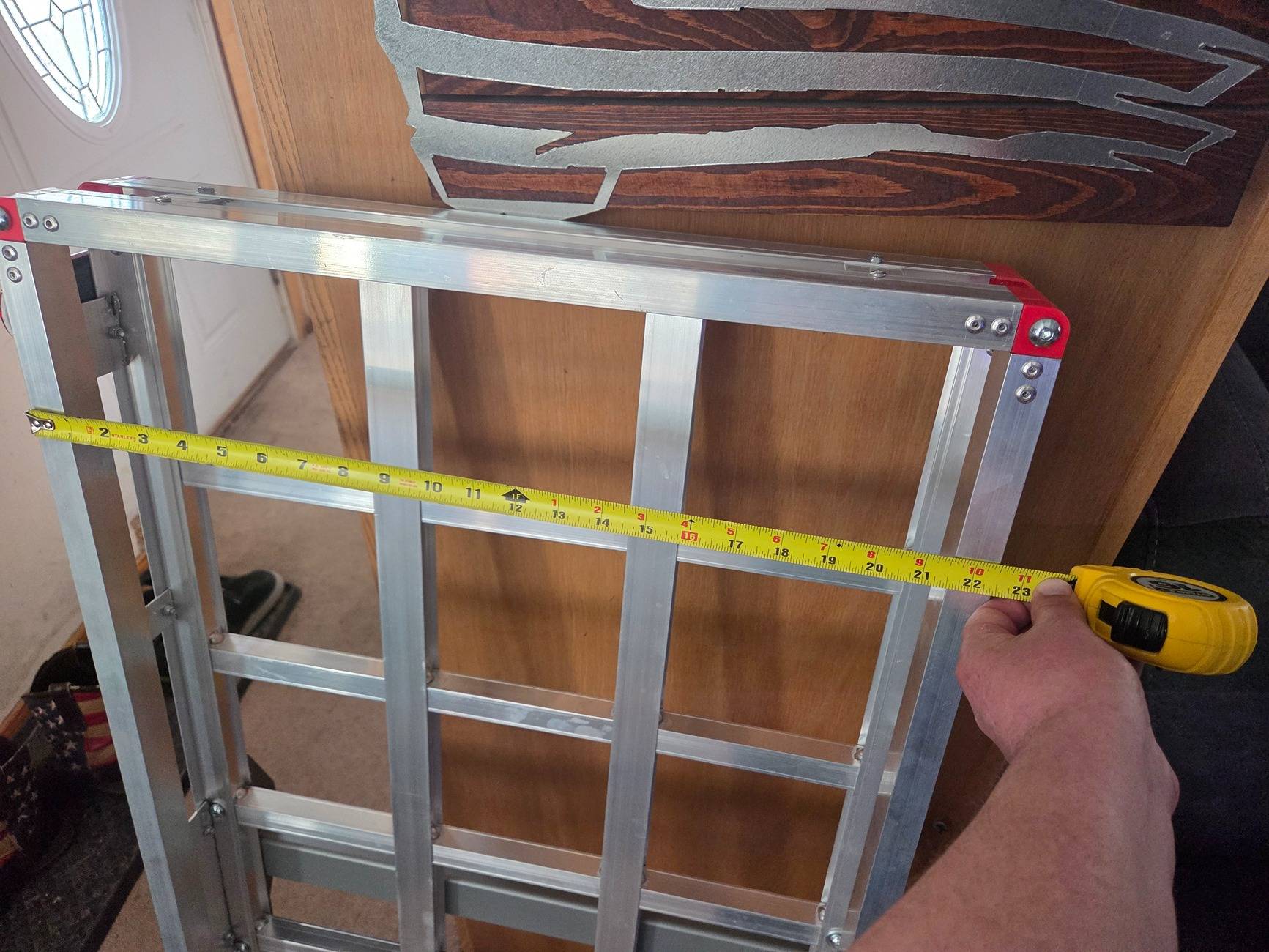

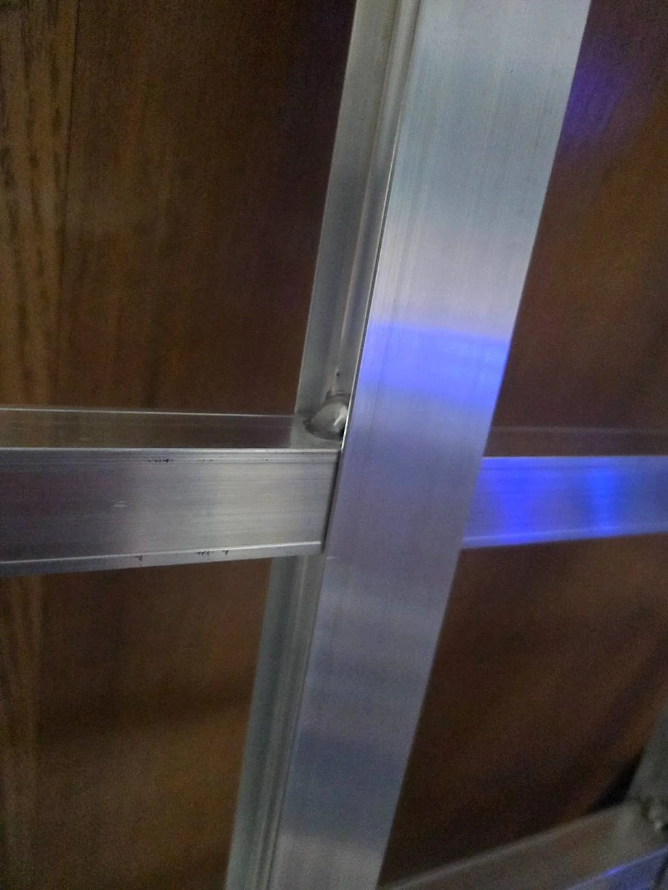

The bottom part of this comes mostly assembled, and it is welded together. However I think you could probably shorten it some and then re assemble the rim that the top section attaches too. If I wanted it smaller I would feel 70% confident I could make it to be an overall smaller footprint and still look decent. Of course before I started with the side I had figured thst if it went bad, I would still be able to salvage it for something and worse case I am out 100 dollars and got to have some fun.
