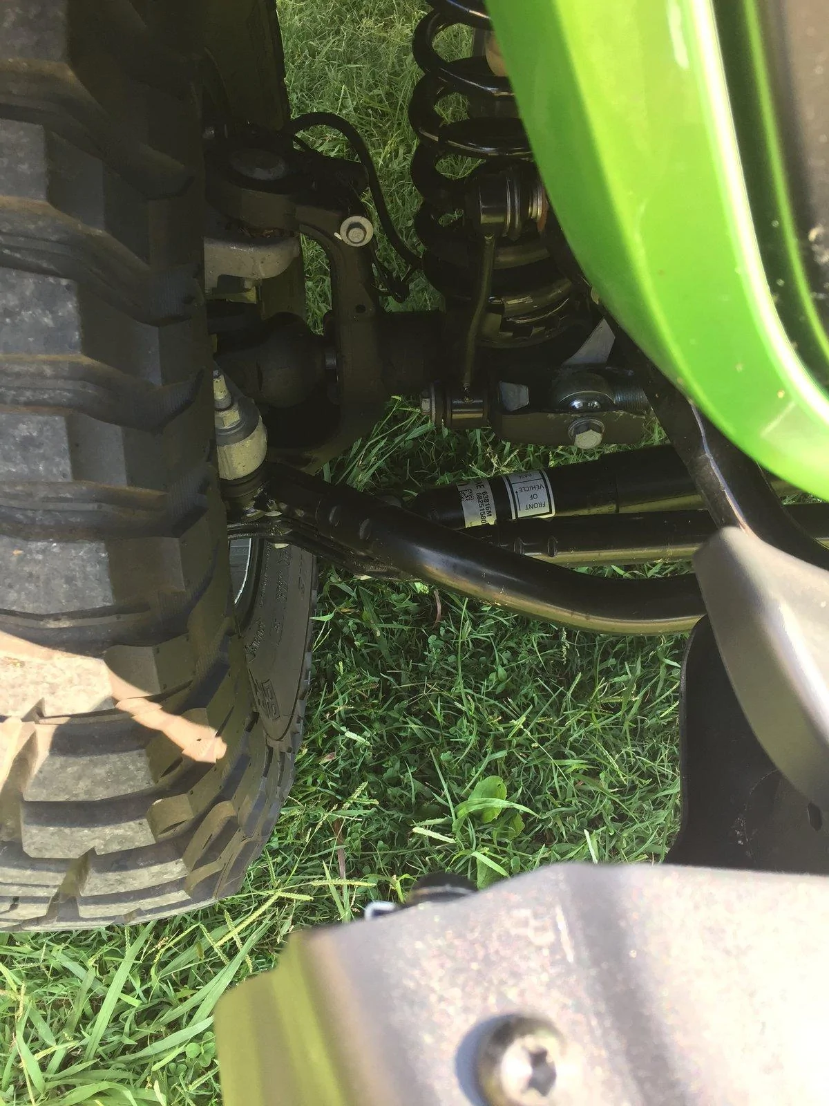

I just had the recall done and unfortunately mine was installed upside down as well. I will have to flip it over!

This stabilizer replacement is about as simple as you could get, but they still screw it up. What can you say... it's beyond words!

Pardon my ignorance, but what difference does it make what direction its placed?
According to FCA it is to allow faster fluid transfer, thereby supposedly enhancing the performance as long as the bulge is positioned downward.

That also means they ignored the label on it with the arrow that has "front of vehicle" written on it, since that would put the bulge in the correct position.
Assuming the technicians are male, you'd think they'd know where the bulge should be.
