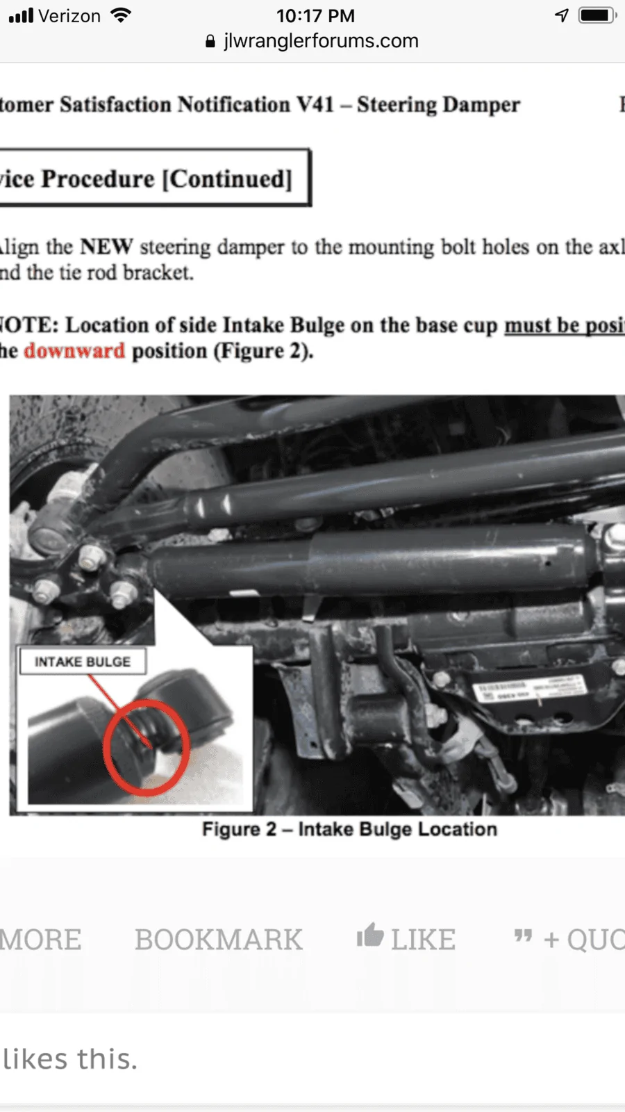

My dealer was quick to schedule me and had no issue getting the part. It appears they did have issues with reading directions. My intake bulge is on the top & sticker arrow faces the rear of the vehicle.
Exact same thing happened to mine, I can't understand why many mechanics can't get this simple thing right.

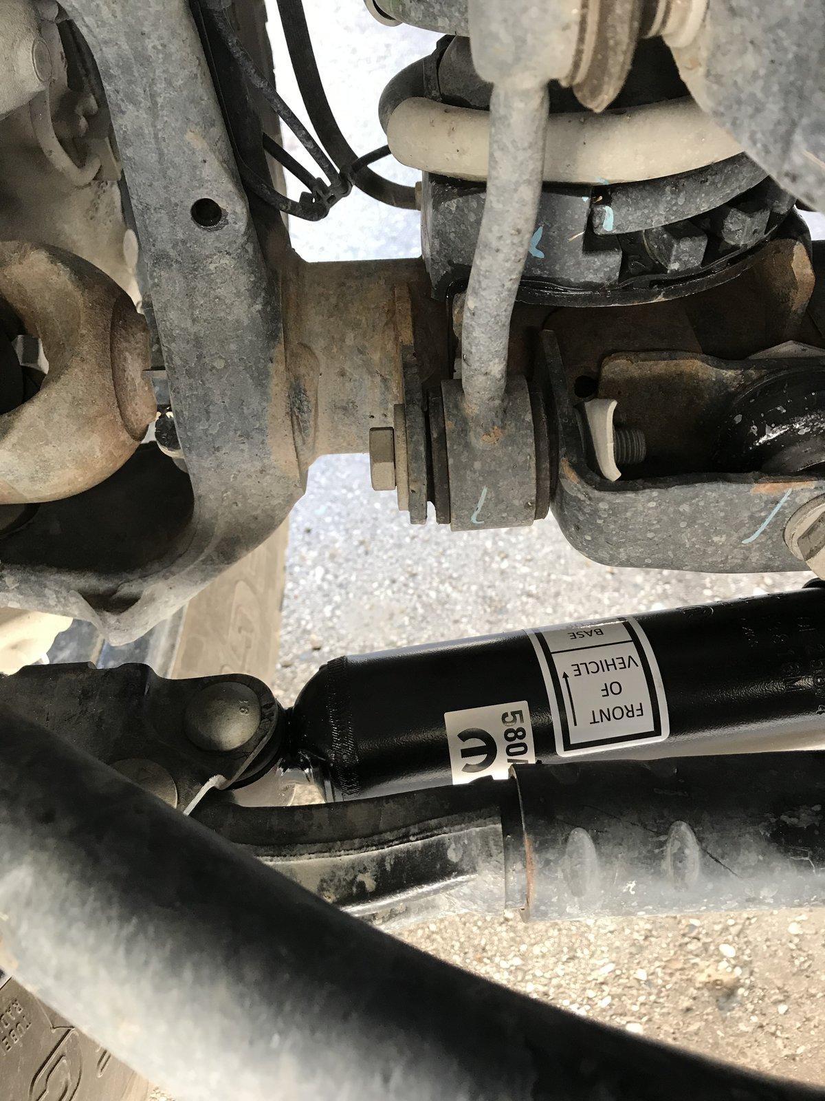

I went back to the dealership today to have the damper installed correctly. (It was installed upside down). The technician unbolted the left side and twisted the left side of the shock 180 degrees. Is that ok?
I expected him to unbolt both nuts and rotate the whole thing 180 degrees. Does twisting half of it hurt anything? I’m clueless to the internals of a shock.

Totally OK to rotate it 180 degrees

I went back to the dealership today to have the damper installed correctly. (It was installed upside down). The technician unbolted the left side and twisted the shock 180 degrees. Is that ok?
I expected him to unbolt both nuts and flip the whole thing over. Does twisting it hurt anything? I’m clueless to the internals of a shock.
Yes, that's 100% correct now. Did they apologize for installing it wrong the first time?
Yeah. The service writer called in a tech. The more senior tech came over to see what I was talking about and instantly knew that it was upside down. He drove it in and fixed it right away. The dealership was nice. I wish mistakes didn’t happen, but all is well.
How long was it on incorrectly?
According to FCA, incorrect install could damage the part.

Yeah,mine was done wrong too, but I saw it before I left the dealership, and had them flip it. So it had zero miles on it.
Of course FCA considers the fasteners as one time use only, but those never got replaced.
And torque to spec ???? Yeah right !!!
