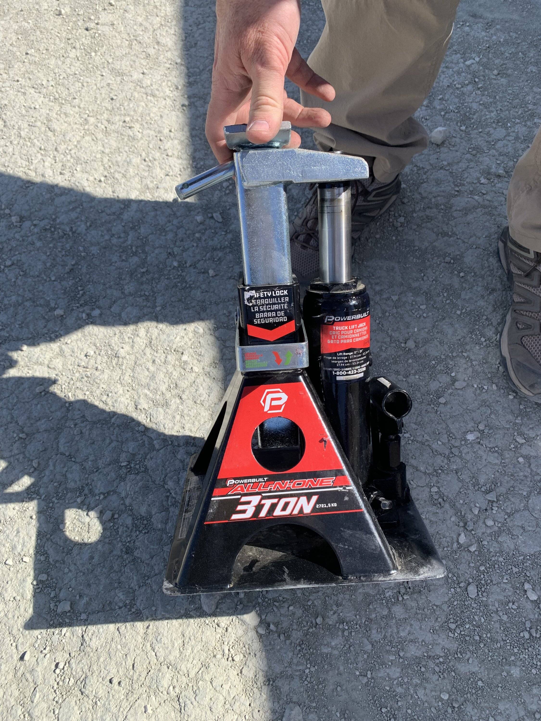

I keep one of these in the jeep. I've changed a tire offroad with it and the big flat base kept it from sinking into the dirt. I also use it every month or two to rotate tires for the two jeeps.
Amazon.com: Powerbuilt 3 Ton, Bottle Jack and Jack Stands in One, 6000 Pound All-in-One Car Lift, Heavy Duty Vehicle Unijack, 640912 : Industrial & Scientific
I've had folks on here say this design isn't reliable, but I like that if it does fail while the jeep is up it will lock and not go all the way down. I had a rolling floor jack do that to me in the past and I had to find something quickly to wedge under the axle to keep my rotor off the cement.

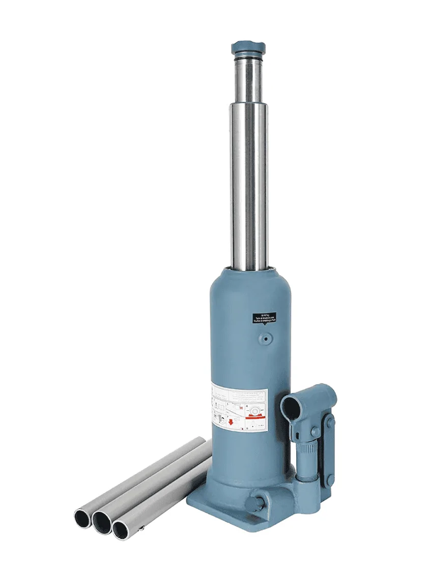

I went with a BAOSHISHAN 4 Ton Bottle Jack 10-5/8" to 24" Lifting Range High Lift Double Ram. It's a bit to tall for a flat, but I carry a 12" piece of 2x10 to drive over. I like the double ram high lift. It has great reviews on Amazon. Used it a couple times this year for different JK's in the club.

I looked at that but the reviews are pretty bad. Most reviews that say leaks they probably didn't close the value.

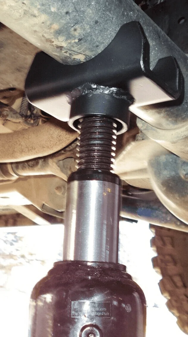

I strongly recommend @Stormin’ Moorman w/ the Jack axle adapter, much safer & secure vs. just the bottle jack small round top.
