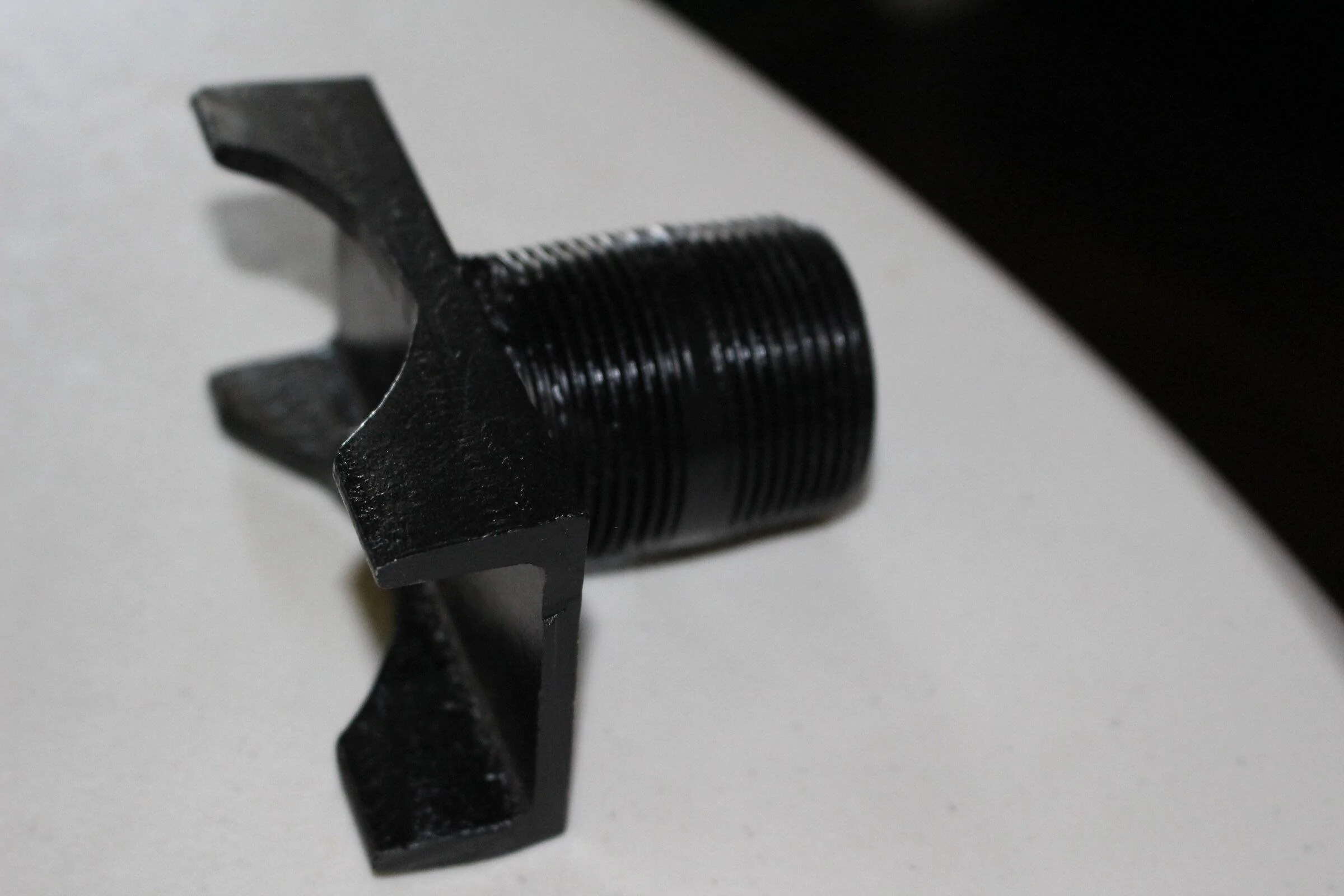

The jack buddy axle adapter can be made on the cheap if you weld, just a galvanized pipe nipple and some channel iron, made for about $5 :) NEVER lift an axle without one!!!!

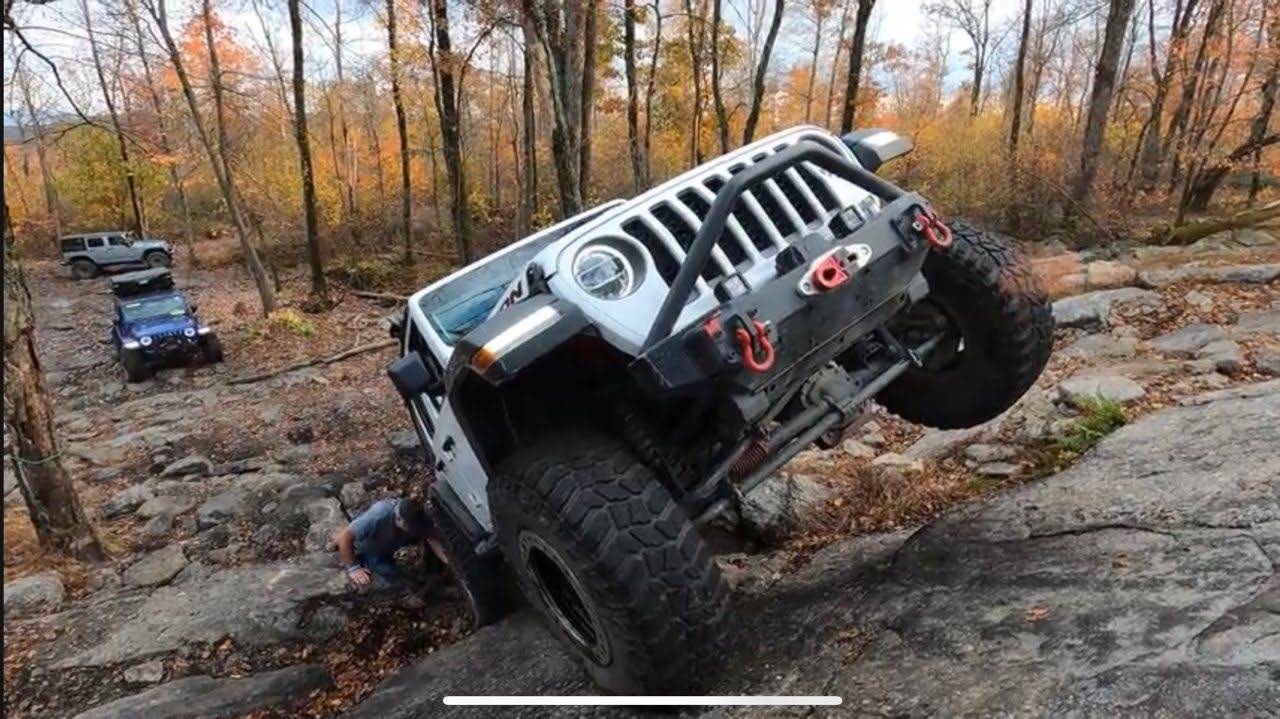

Some times I don’t even use a jack to do tire rotation. I just lift a tire and swap the spare on during a five tire rotation.

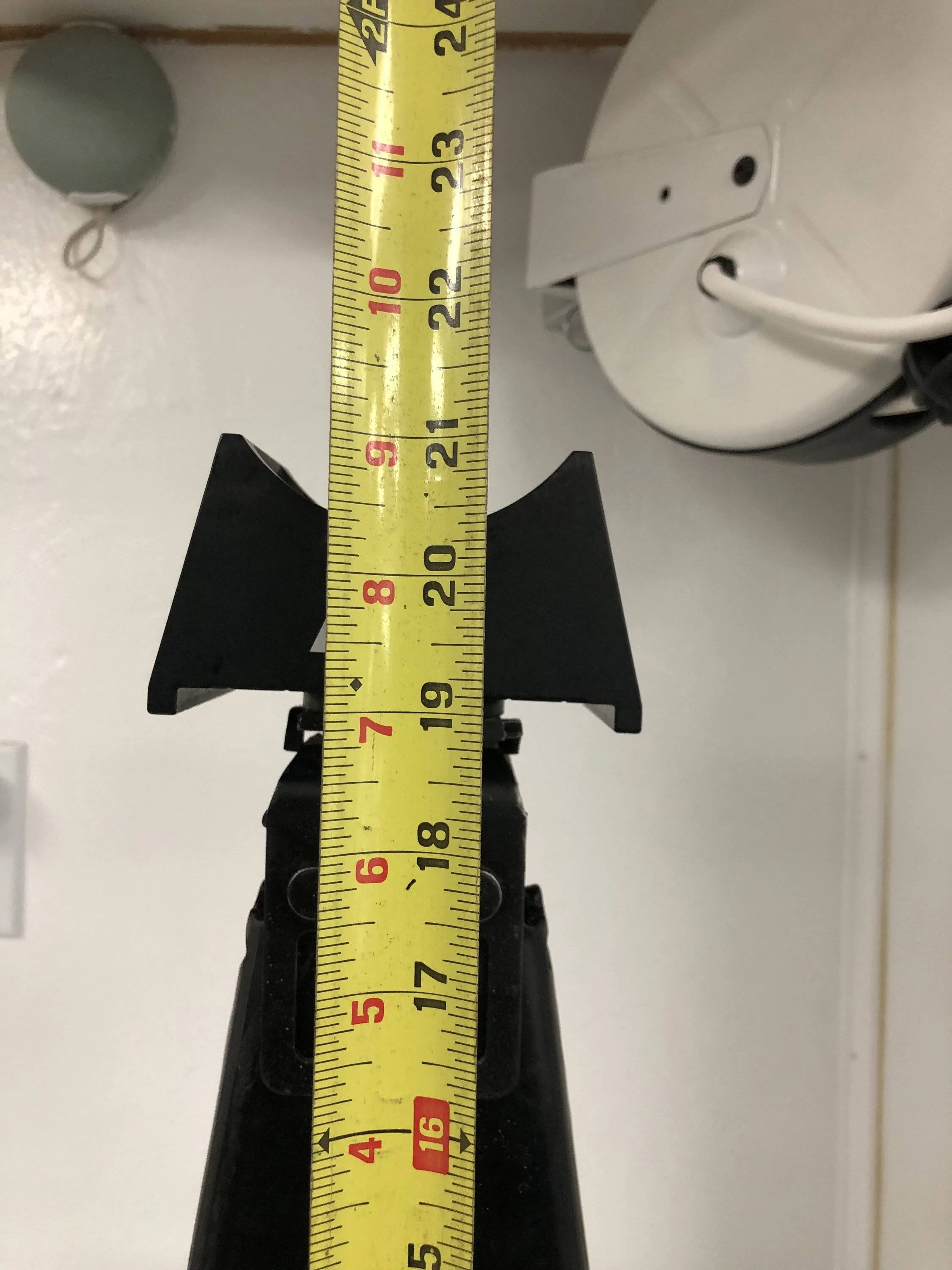

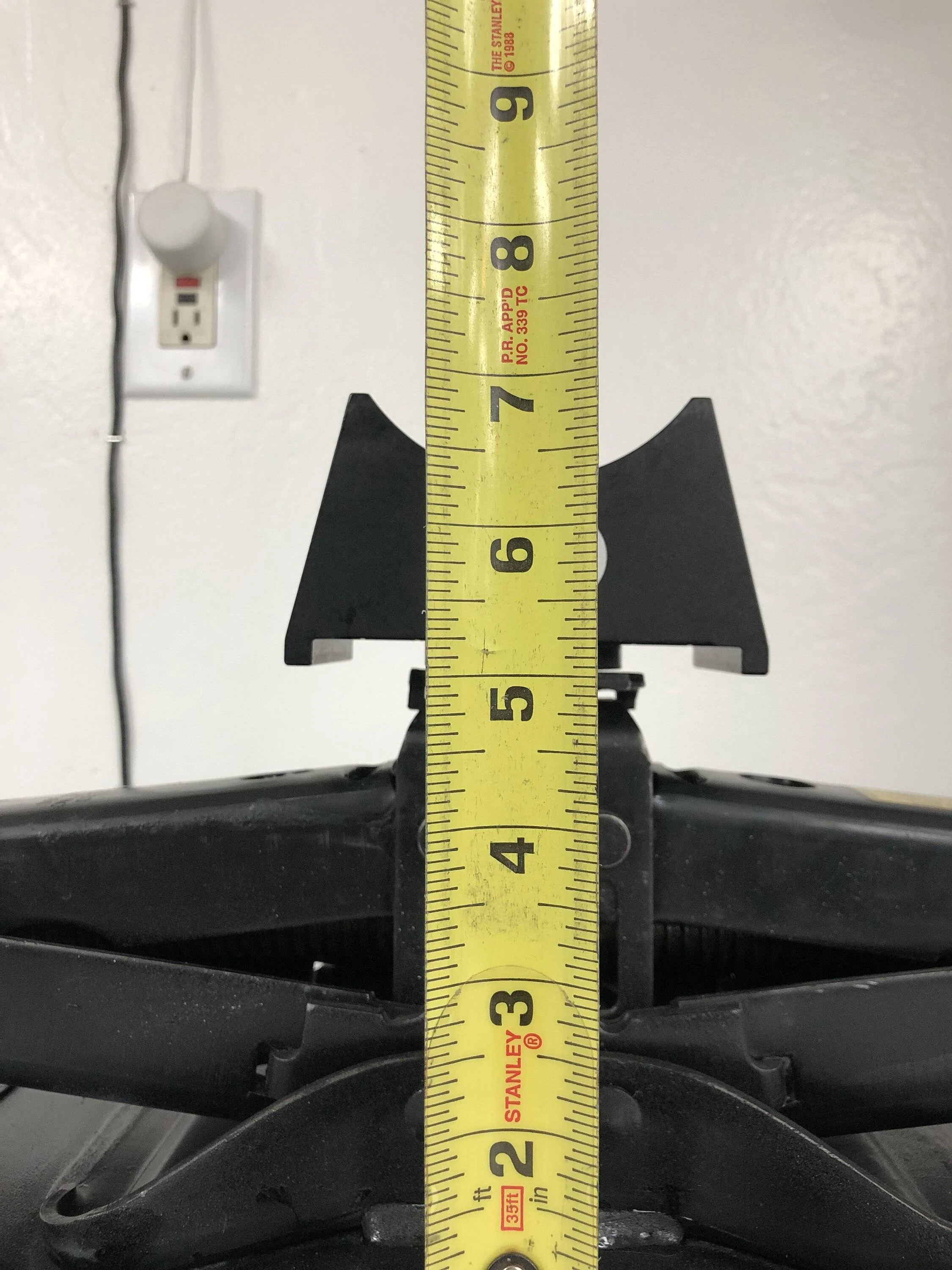

I carry a Hilift as a last resort and a HMMWV scissor jack as my primary. The H1 jack takes up approximately 22x7x7 inches of cargo space. They are expensive compared to what you could buy one for a few years ago and it requires you to fabricate an adapter or buy one at an additional cost. You would also need to fabricate some sort of mounting brackets to carry it safely. The base plate is 7x12 inches so fairly stable. Here are some approximate measurements fully collapsed and fully extended. I probably would not buy at today’s EBay prices, but I was able to buy two of them previously for a good price. Not for everyone but just another option.
