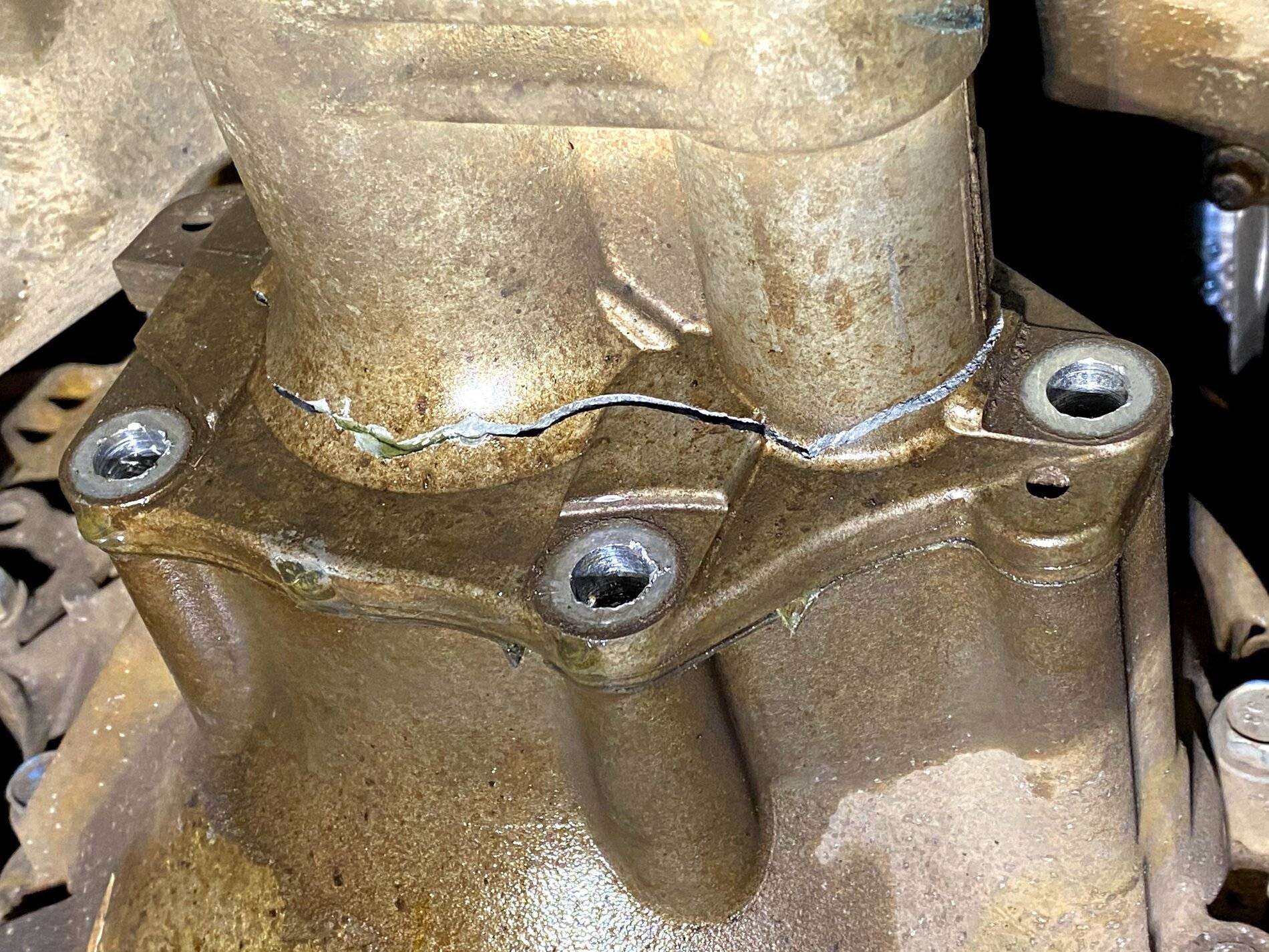

I recently cracked one of my axle housings from normal street driving on my Yukon (is 13 years old with 150k) which was very odd. Couple that with comments such as @DHW stated above (and other similar comments throughout various forums I’m a part of) and it makes me second guess raising the vehicle from the pumpkin. However, you’ll probably still find me raising from the diff years from now. ? I definitely use rubber block or wood so as to not damage the diff housing.

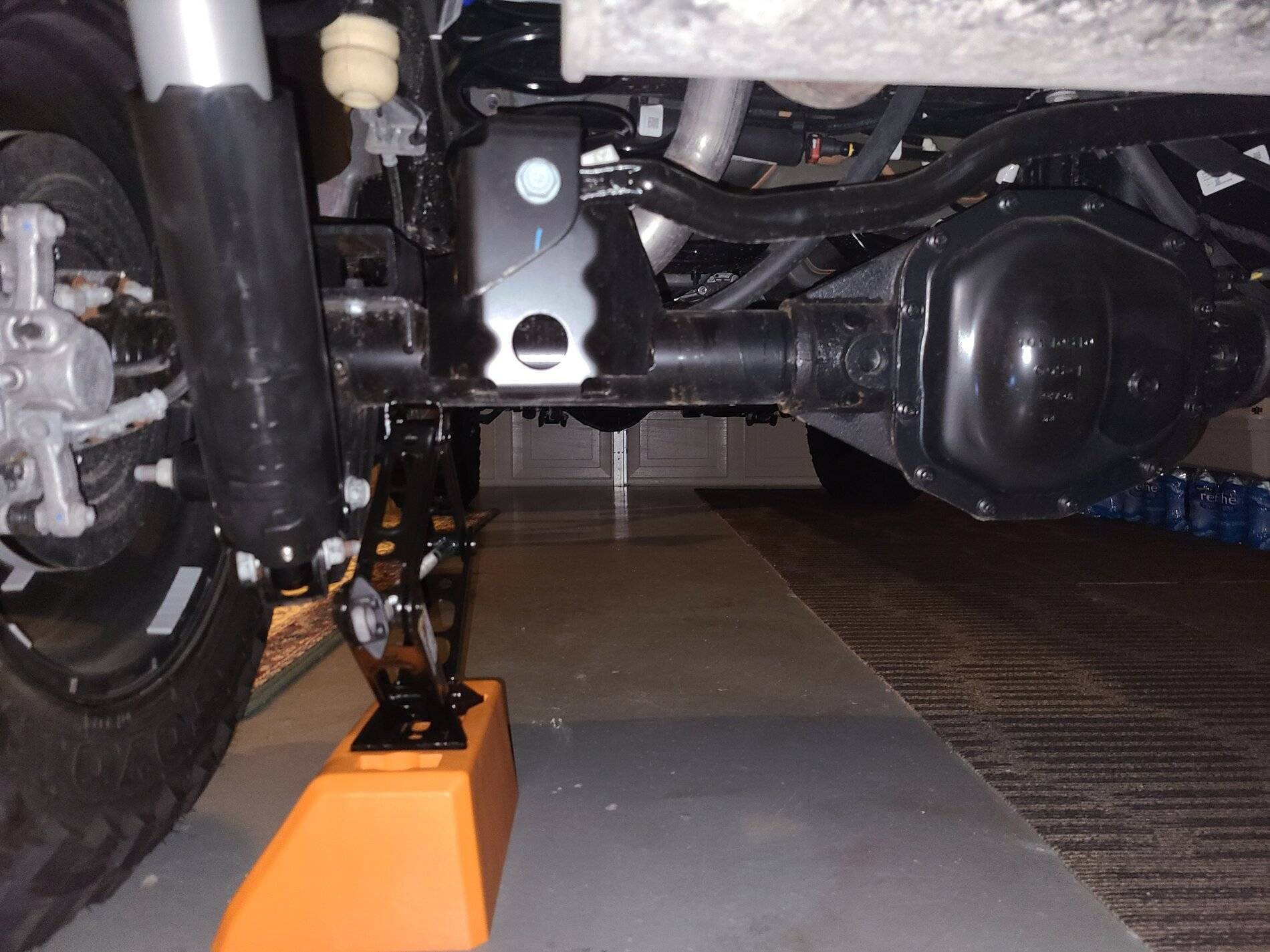

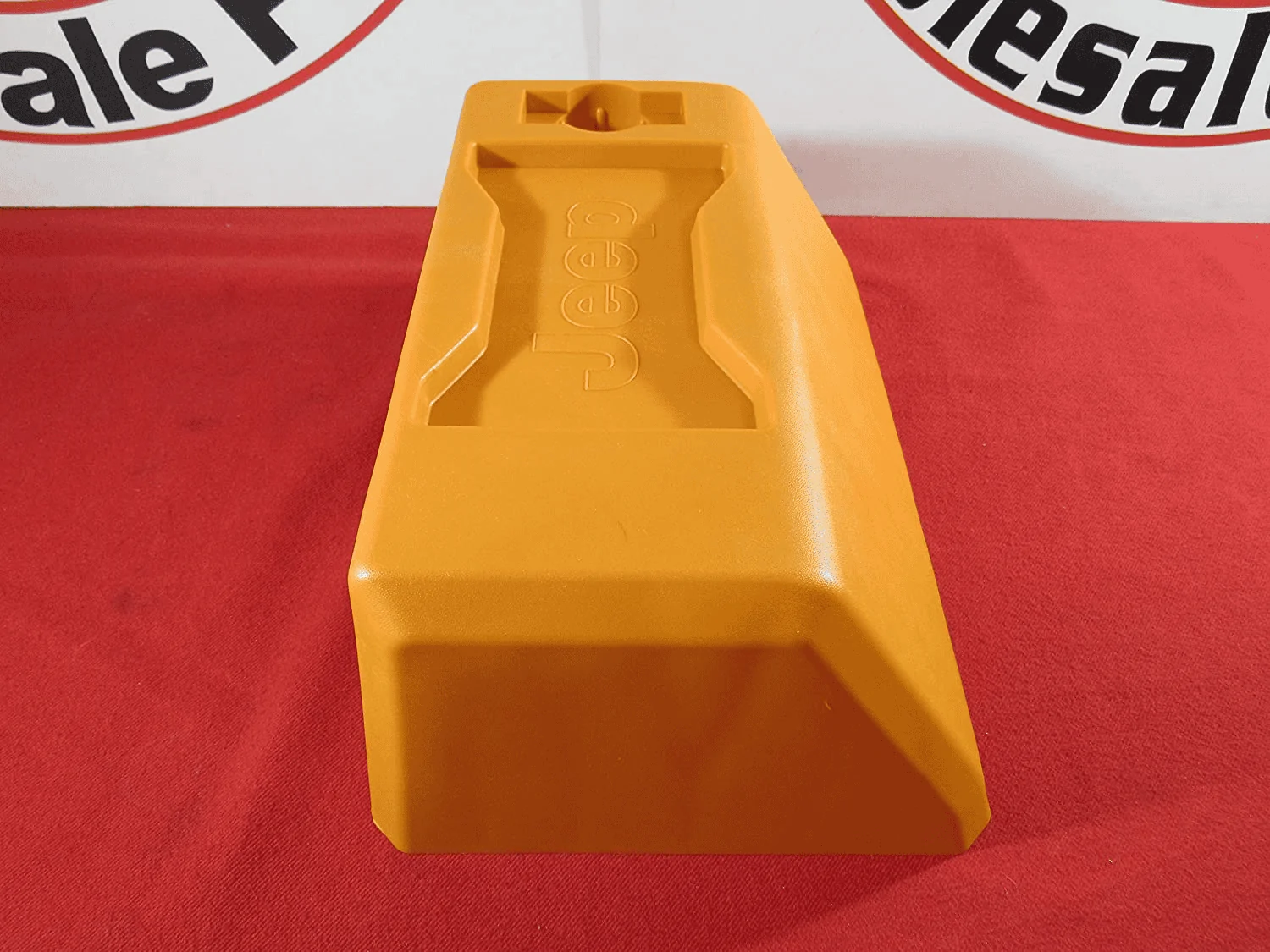

I use the Factory scissor jack and Jeep base stand made for the scissor jack. Jack stand marks to the right.
Jeep Wrangler JL Floor jack point for tire rotation? 1629126508056
Jeep Wrangler JL Floor jack point for tire rotation? 20210816_100103
