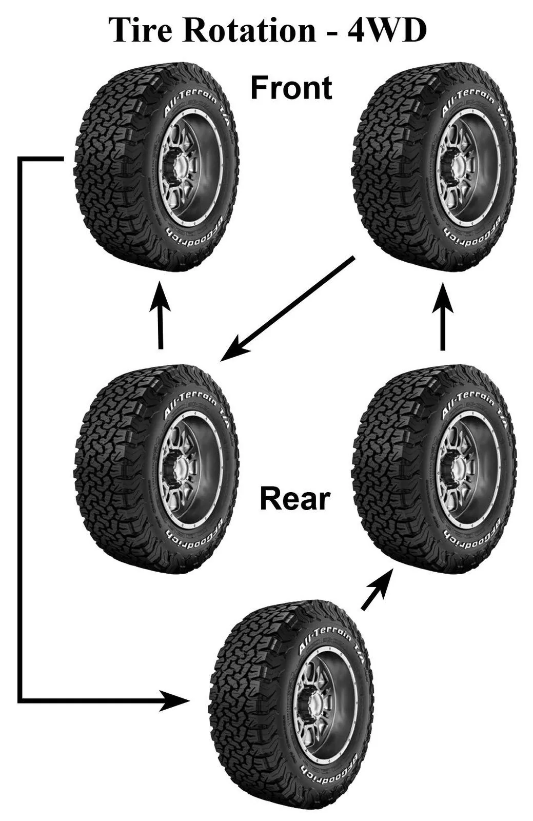

The diagram from Quadratec is for a rear wheel drive vehicle, NOT for FWD (despite what they say). I put this together for printing:
Jeep Wrangler JL Tire Rotation Tire rotation - 4WD

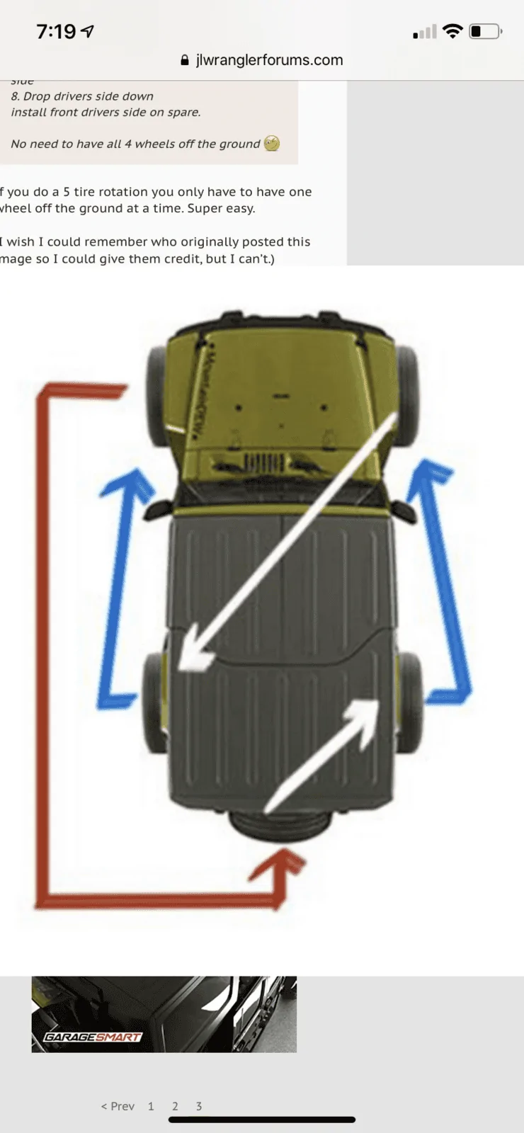

Got this from somewhere in these forums 2 years ago when I got my JLU
Jeep Wrangler JL Tire Rotation 3F2E52A1-1CC7-4539-9790-637D6B87DFA0
