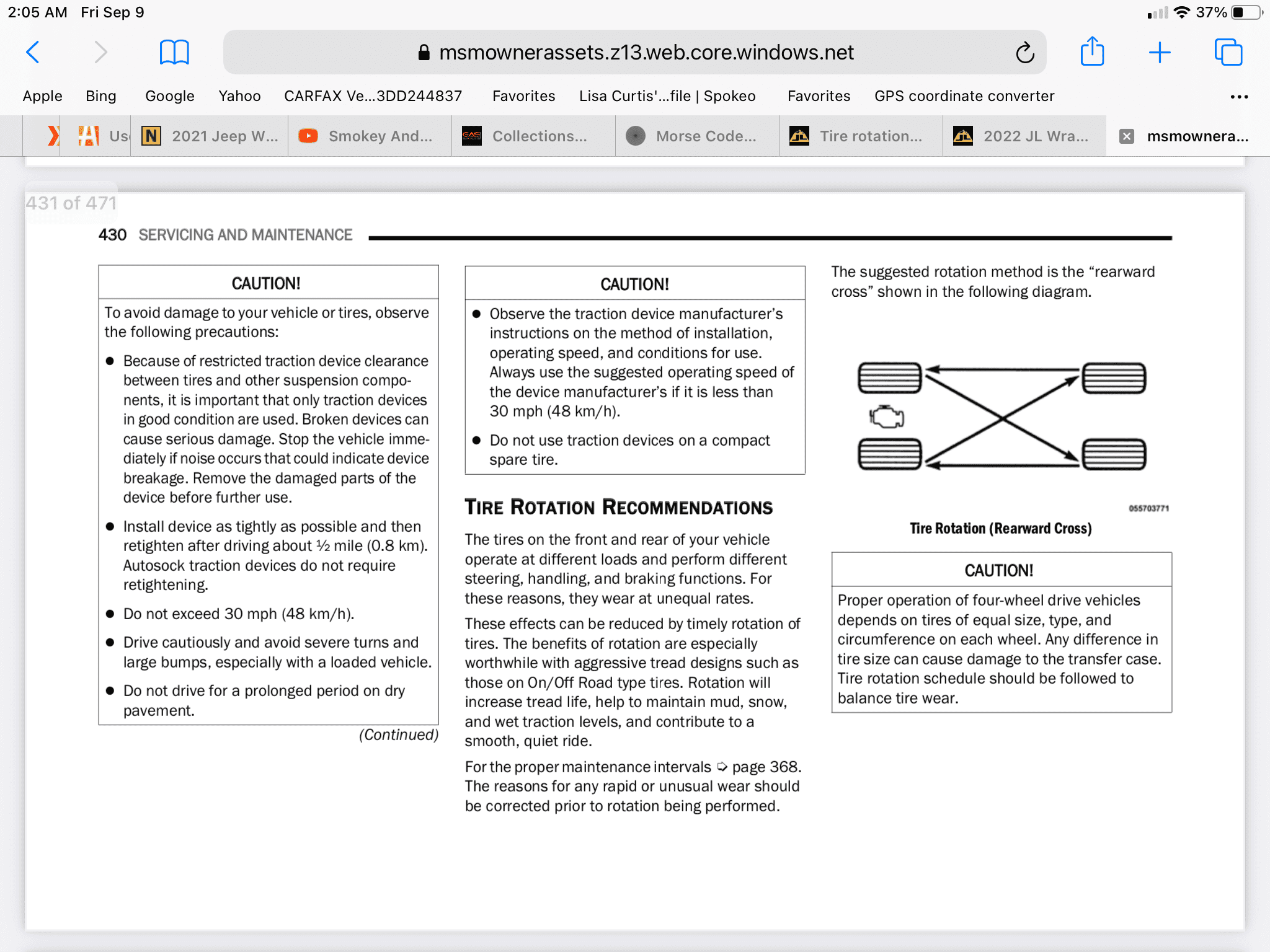

The 2023 Jeep Wrangler downloadable manual says 5 tire cross.

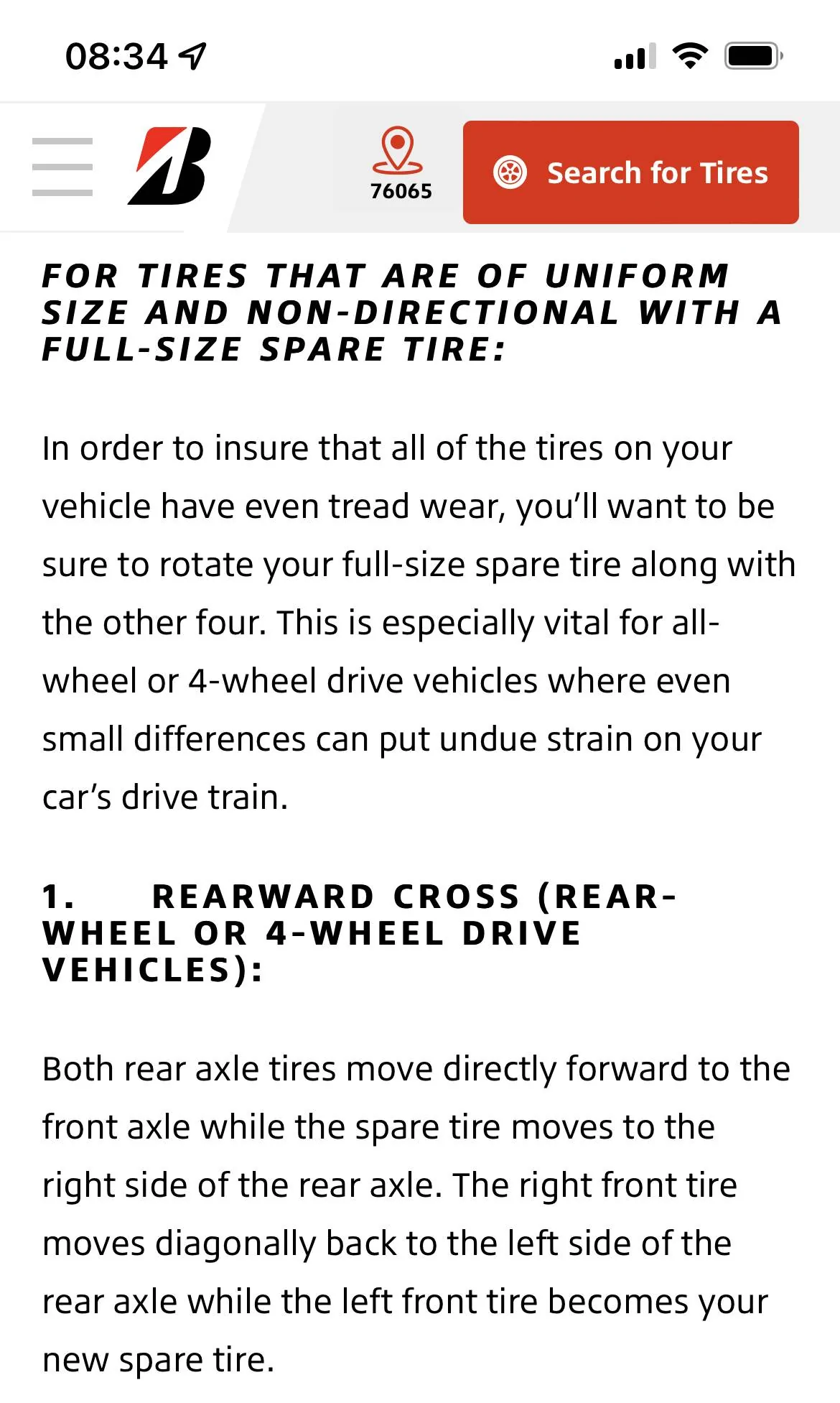

Every reference I can find online says 5 tire cross, to include KBB, BF Goodrich, Art of Manliness, etc.
Where are they getting their information from? How can I verify?

As you already know....the owners manual plainly states that crossing them is the better pattern.

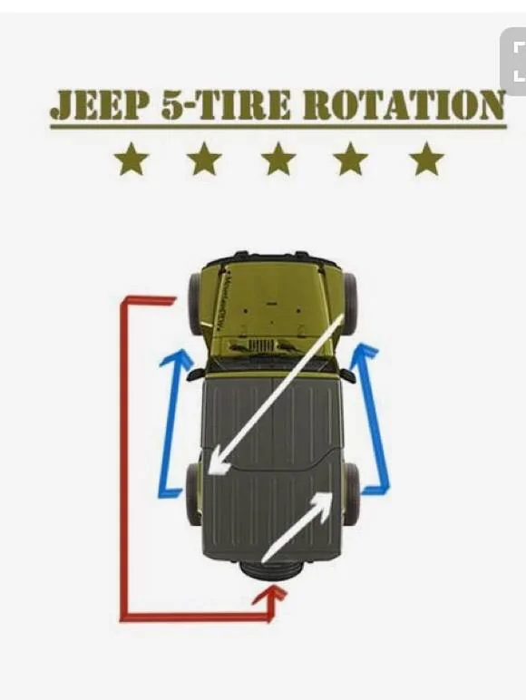

5 tire rotation is the way to go. There is a good chance you will want to at some point change your wheels or tires. If/when you do that you will have a full size spare with 0 miles that you will likely throw out or sell for close to nothing. Using the 5th wheel will extend the life of all your tires.

I just did this to my JL yesterday. As the vehicle is used and NEW to me I wanted to get into it and see what was up with it. Gary, above posted the normal 5 tire rotation and it is the one I followed. Being up in years (66) I printed a copy so that I could keep track of every tire. I was doing an oil change also and doing a full clean and inspection of each wheel and tire.
Oh….Print a copy and make notes on it while you are performing the rotation. As I was doing other things, I made sure that I put an “X” on the page after each swap and proper Torque. In that way I could keep track of everything.
Depending on the tire you have, it is actually GOOD to do a 5 tire rotation. The reason the Spare goes to the passenger rear is that is normally the tire that will spin first. Also, a 5 tire rotation will even the wear and you should get more even wear and about 20% more life out of the tires.
