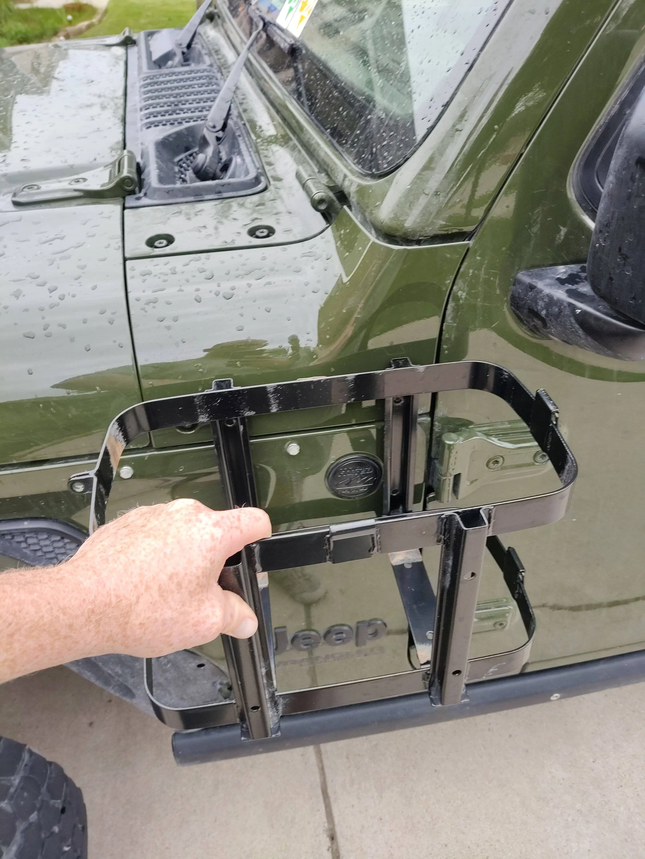

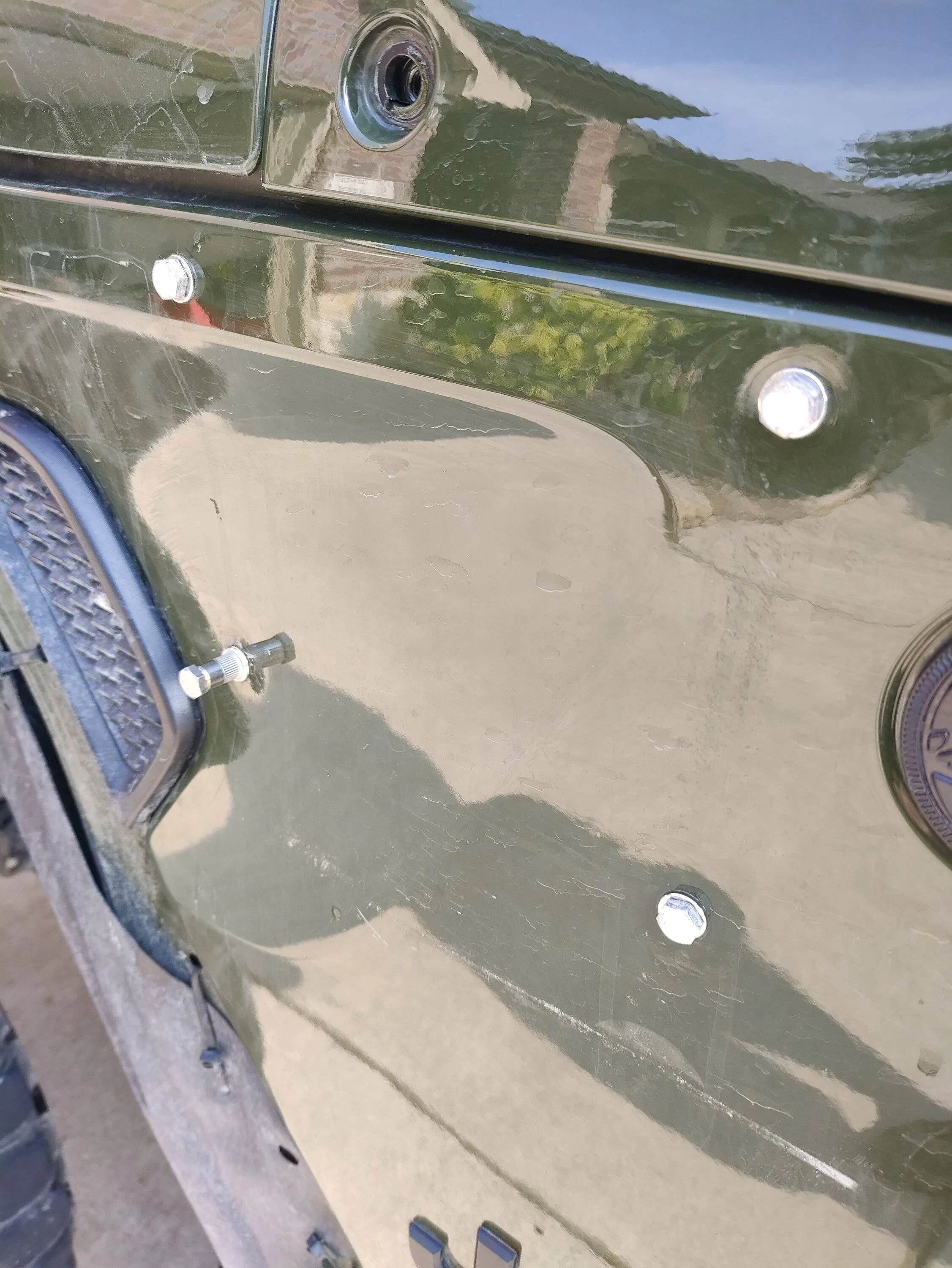

Now it's time to drill some holes in your Wrangler. I started by lining up the gas can holder with the front fender about where I wanted it to be. And marked through the holes (on the Jerry can mount) with a marker. There is a dip in the front fender which makes pretty much everything involved here complicated. I figured out much later that it would have been better to just worry about the three holes that are on an even level first, and once all of them are rigged up and done, then worry about the hole which is lower than the rest.
Jeep Wrangler JL Fender Mounted Fuel Can Holder IMG_20230511_155320976
My first attempt to do this did not involve nutserts, I made the mistake of trying to get a nut behind the fender and it involved taking out a bunch of screws and which would have made the fixture a permanent one because of how complicated it would be to undo the bolts.
I don't know at what point exactly I figured out nutserts would work best, but that's what I ended up doing.

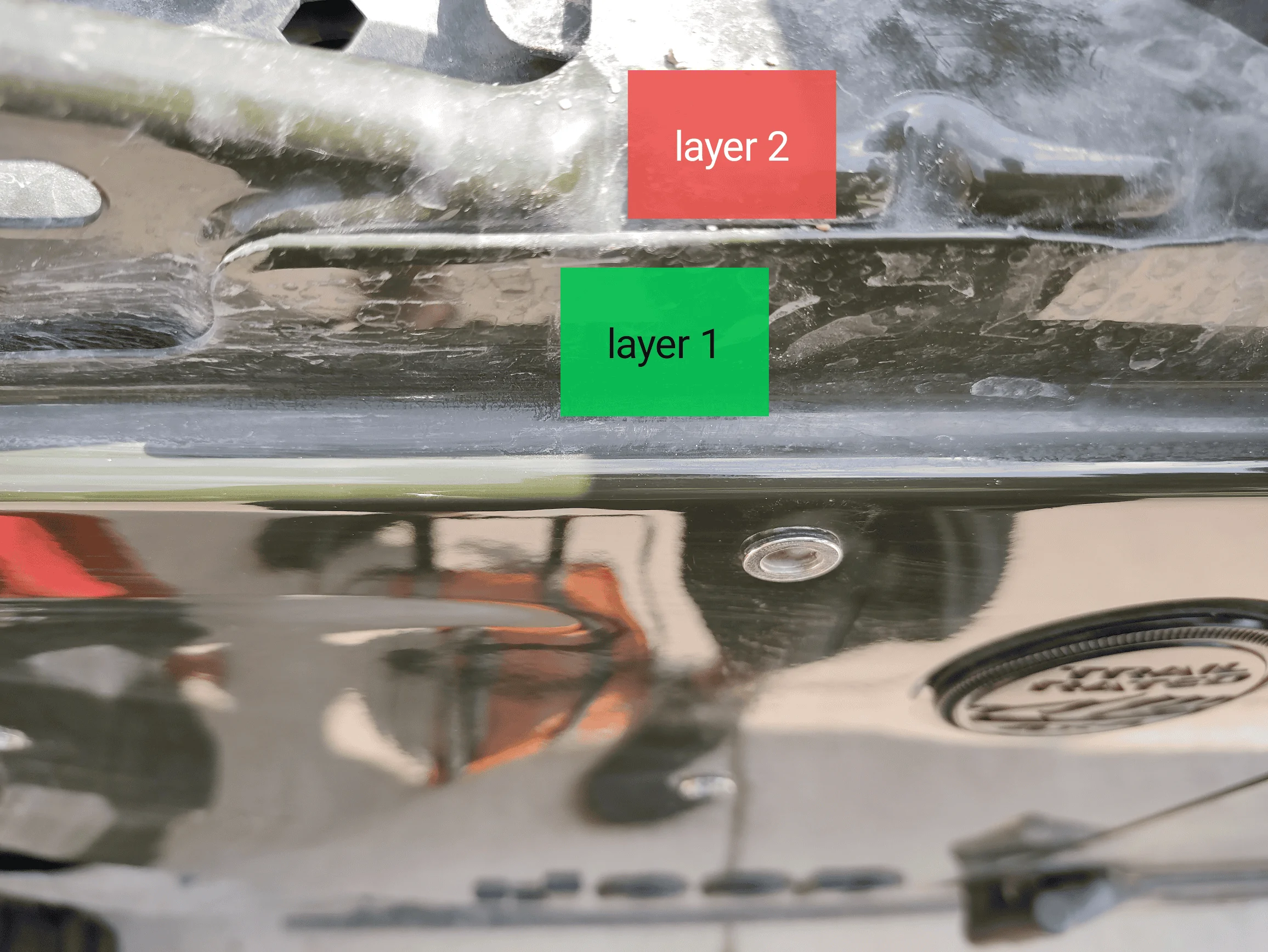

There is however on the right top hole that I drilled, a layer of two metals together.
Jeep Wrangler JL Fender Mounted Fuel Can Holder Screenshot_20230511-195622-710
In this one section for whatever reason it seems like the more interior metal will be in the way, but once you have the nutsert tightened down, there's actually enough space where they don't rub at all.
Jeep Wrangler JL Fender Mounted Fuel Can Holder IMG_20230511_155838767
Jeep Wrangler JL Fender Mounted Fuel Can Holder IMG_20230511_155828160

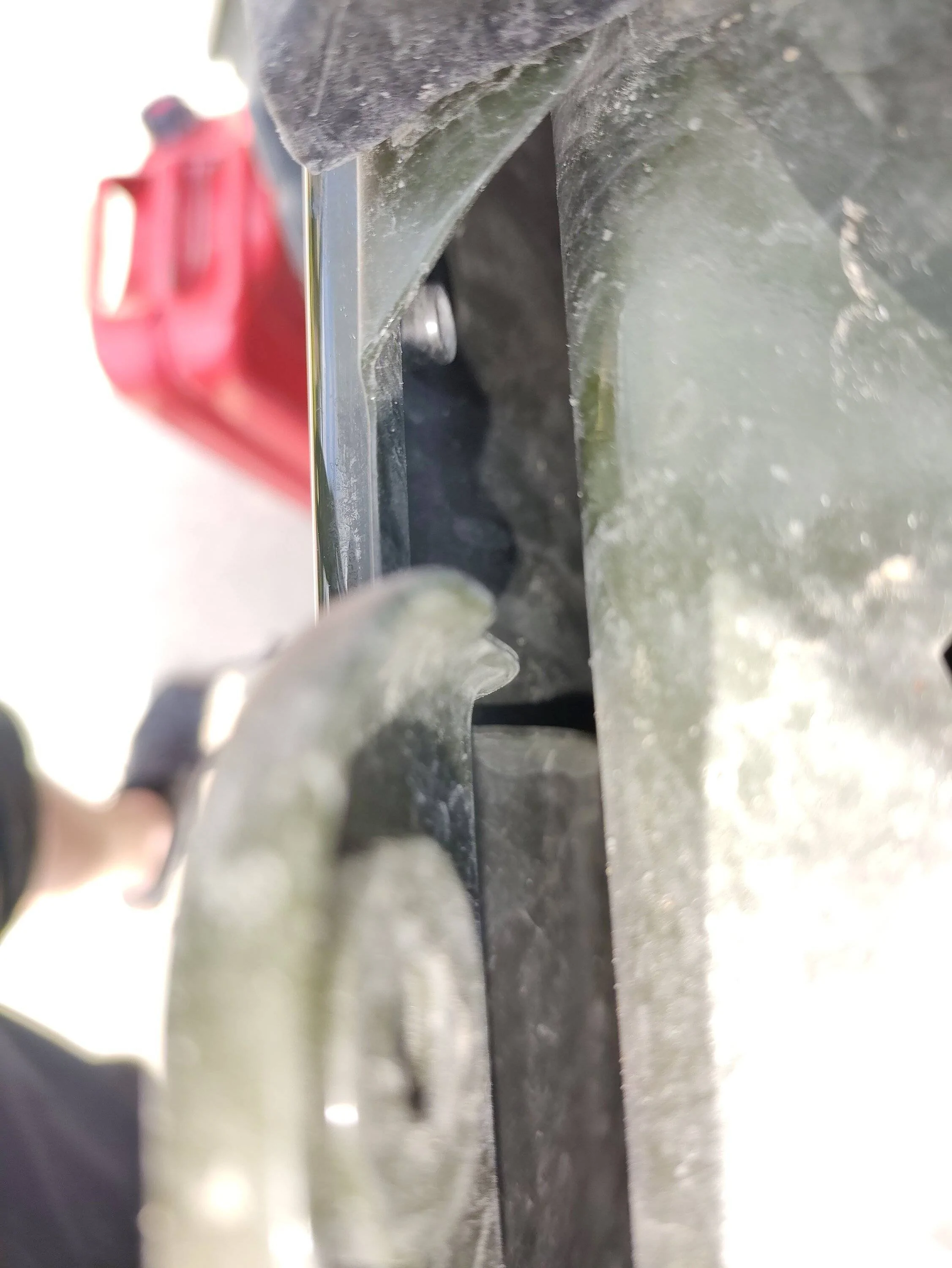

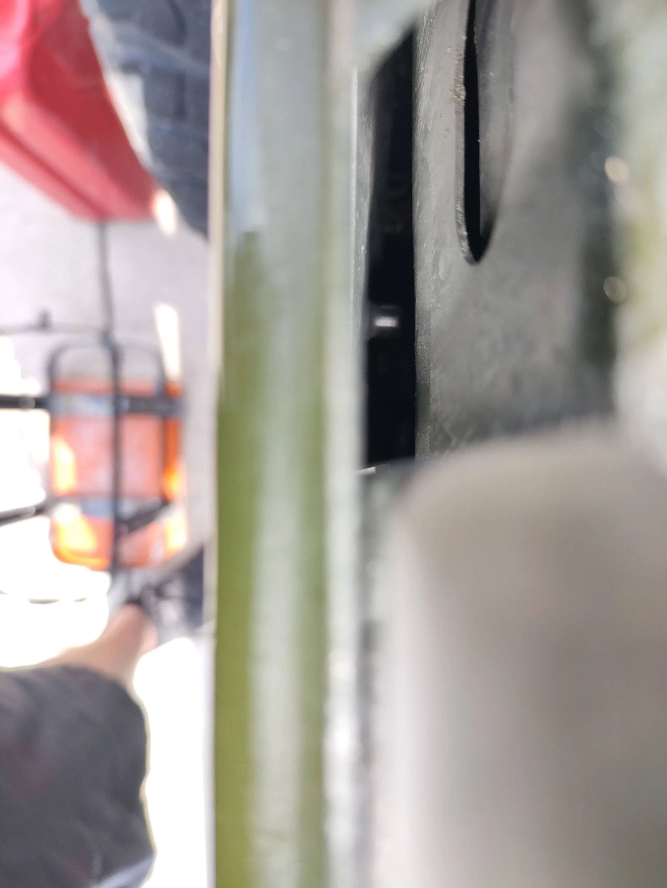

I tried to get a photo of the nutserts to show you that there is in fact space down there where they won't rub on anything.
So yeah basically line up your holes and then mark them with the marker, and then drill your holes, and then put your nutserts in there. I believe I used a M8 thread. You definitely want to use something that's a little thicker, because this section of the fender does flex a fair amount. So you want something that isn't going to get stripped or break easily.

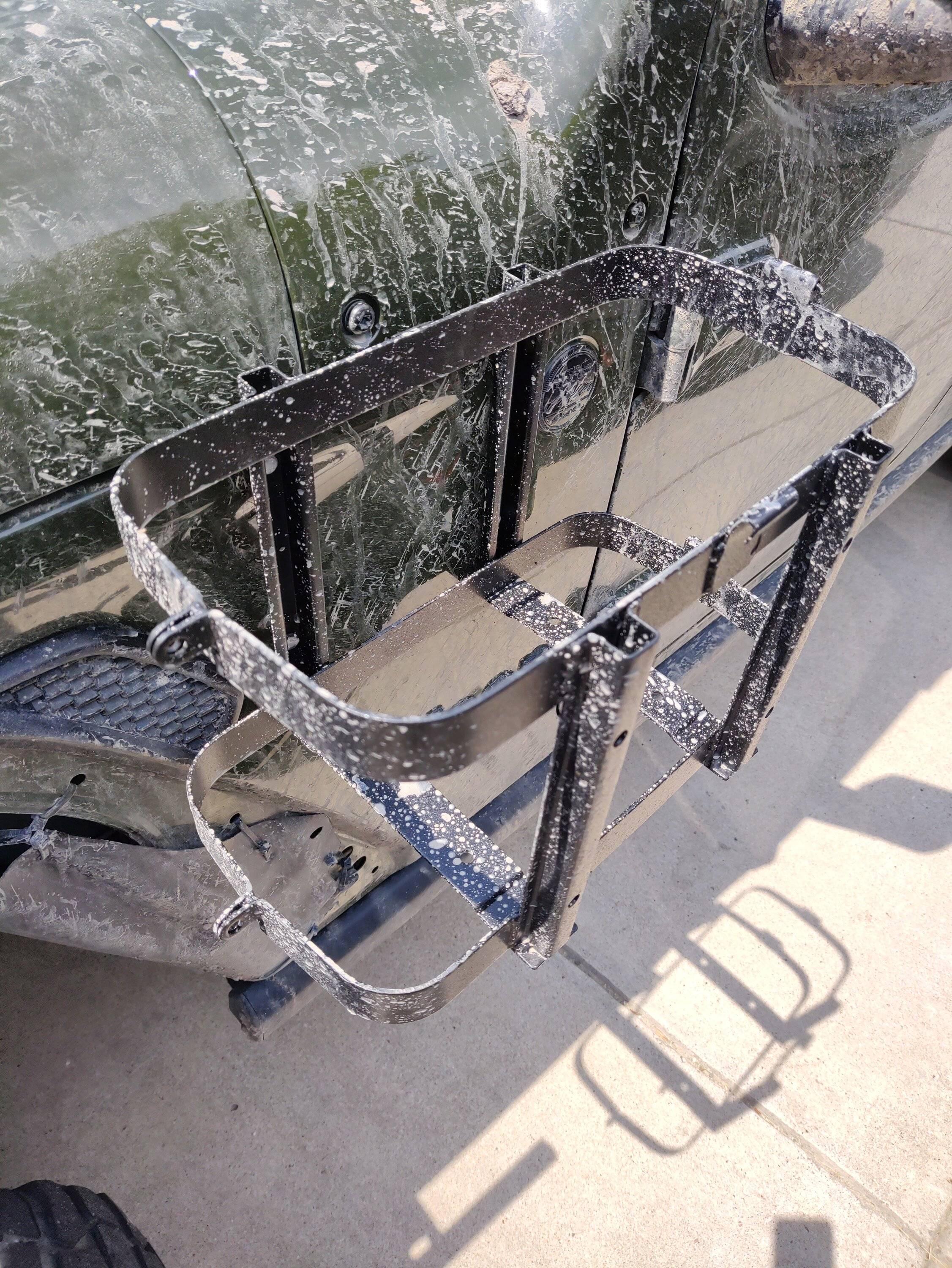

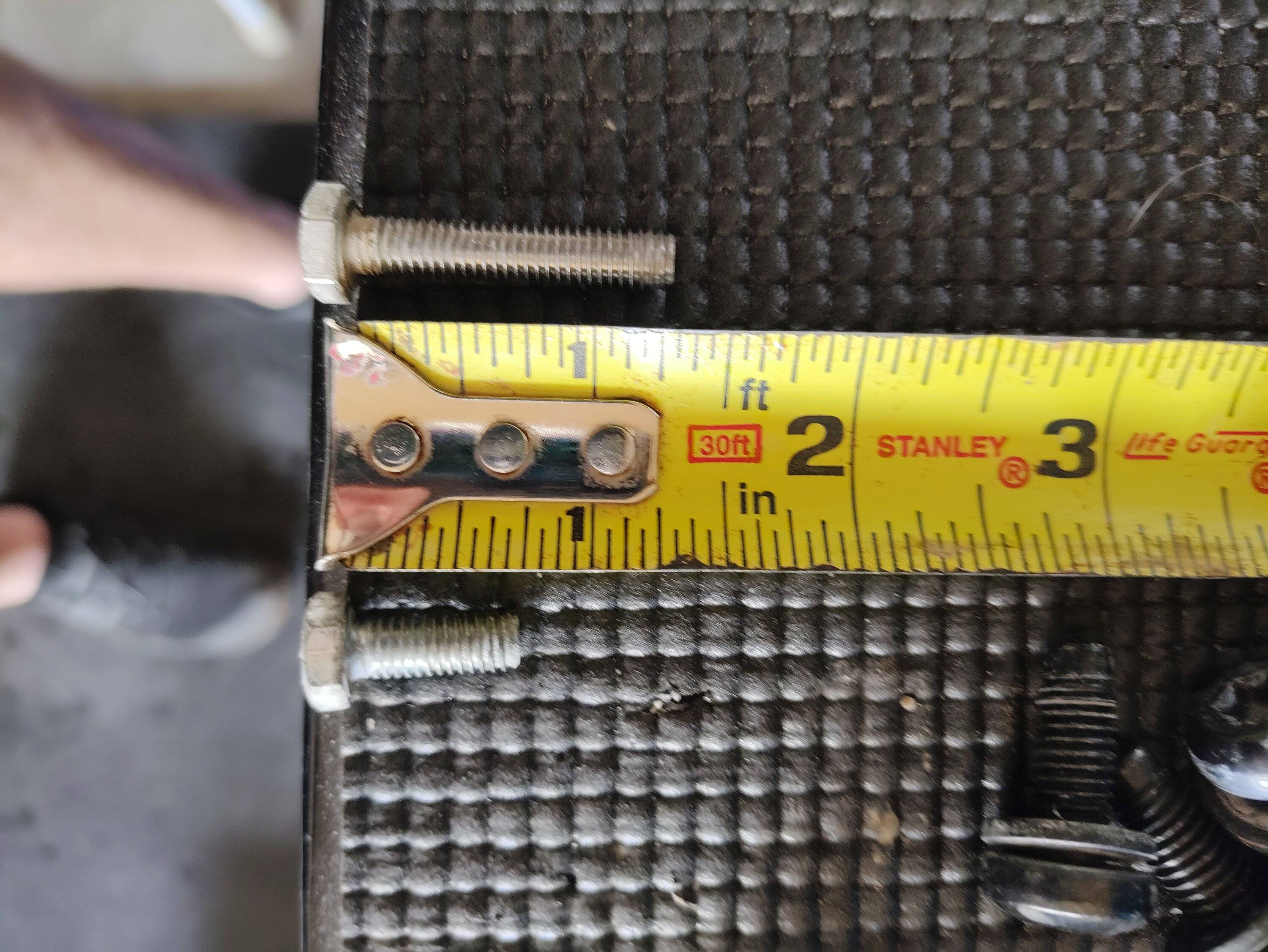

Once you get all of your holes drilled and your nutserts in, you'll want to get stainless steel screws for attaching the holder. The three shorter screws are for the section of the fender that are all on an even plane. The one that's a little bit longer is for the bottom left side screw (If driver side).
Jeep Wrangler JL Fender Mounted Fuel Can Holder IMG_20230511_171914475
You could probably just get a spacer from your local tool shop and put it in between the gas can and the fender where the long screw is at. At first I ran without anything there and the flex I was getting out of the fender and the gas can was ridiculous. It was basically bouncing all the way down the road. I thought it was going to tear my fender off. I was thinking about doing a spacer at the time, but this extra nutsert was the perfect size and looking back on it the fact that it screws onto the long bolt instead of floating on it like a spacer would, means I have zero rattle from this gas can mount.
Jeep Wrangler JL Fender Mounted Fuel Can Holder IMG_20230511_155107028
Jeep Wrangler JL Fender Mounted Fuel Can Holder IMG_20230511_172155253
Jeep Wrangler JL Fender Mounted Fuel Can Holder IMG_20230511_154808859
One of the things I found very important to be aware of is that you have to be able to get a socket in between the metal to tighten down these bolts. I found a m10 bolt head was the perfect fit not too big, not too small. I use a deep socket to make sure I have plenty of space to maneuver when I'm taking these off or tightening them down.
Something else to be aware of is that because the front fender is not perfectly flat, one of my nutserts is at a slight angle. Because of this I have to slowly tighten down all the bolts together. Basically if I just do the top two bolts, and then try to screw in the bottom two bolts, the bottom right bolt won't thread at all. I figured out a while ago that it's because that nutsert is at a slight angle. Rather annoying but an easy fix. Just tighten them down a little bit at a time around in a circle. Eventually you'll get them all tightened down and everything will be perfect
Jeep Wrangler JL Fender Mounted Fuel Can Holder IMG_20230511_154742719
You don't have to do a plastic base like I did if you still have your front fender flares. I don't have my fender flares in the front, so I have a lot of rocks and mud and debris which flies up and I didn't want any of that damaging my fuel canister.
Jeep Wrangler JL Fender Mounted Fuel Can Holder IMG_20230511_154507432

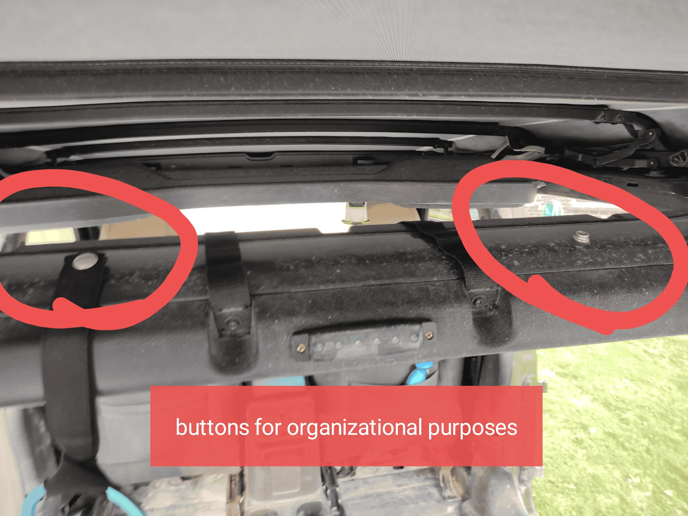

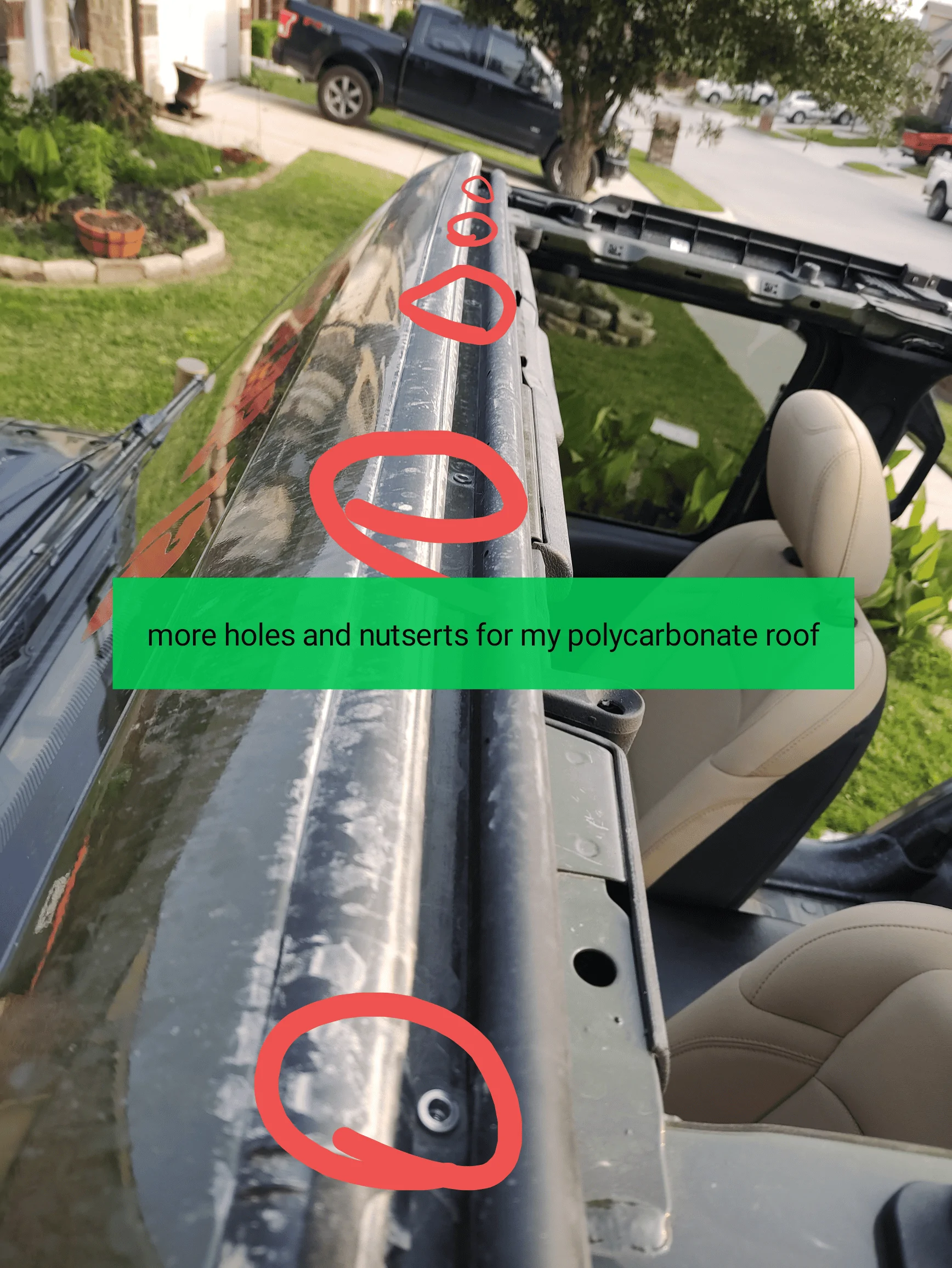

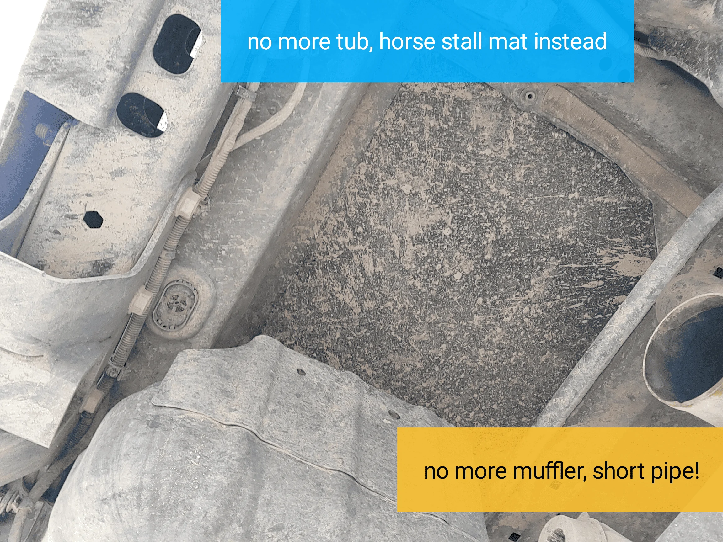

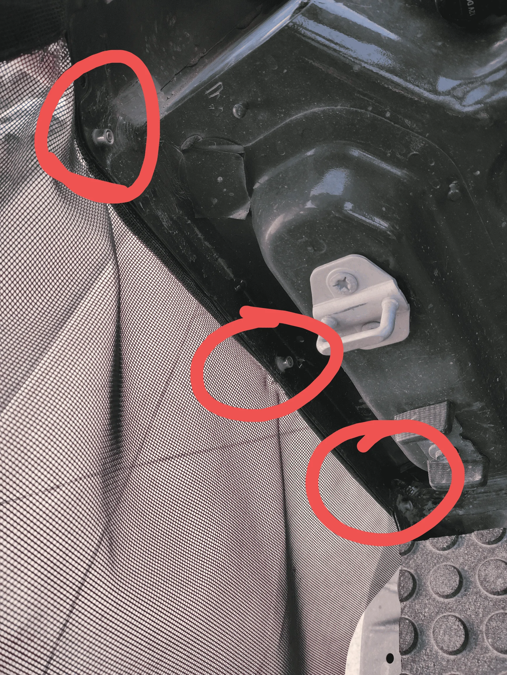

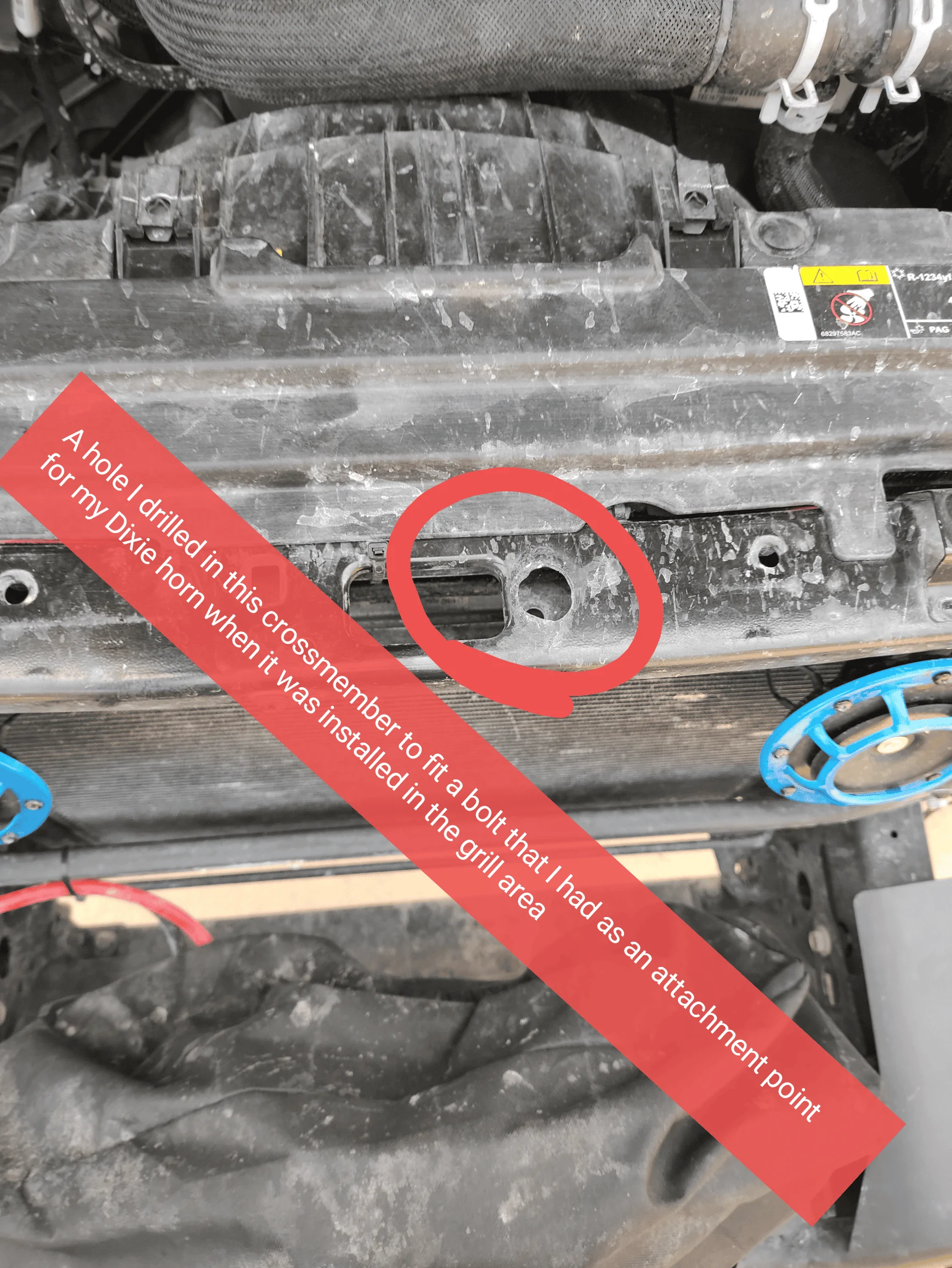

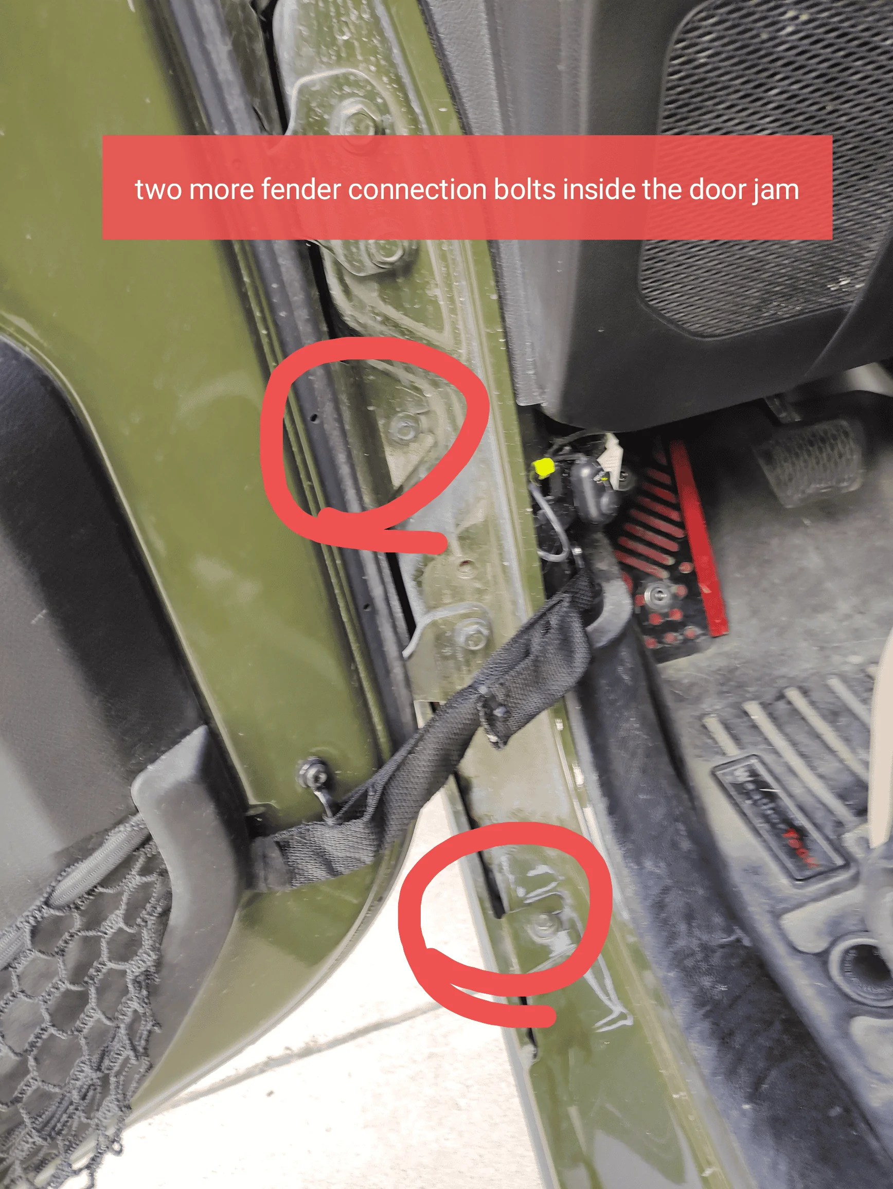

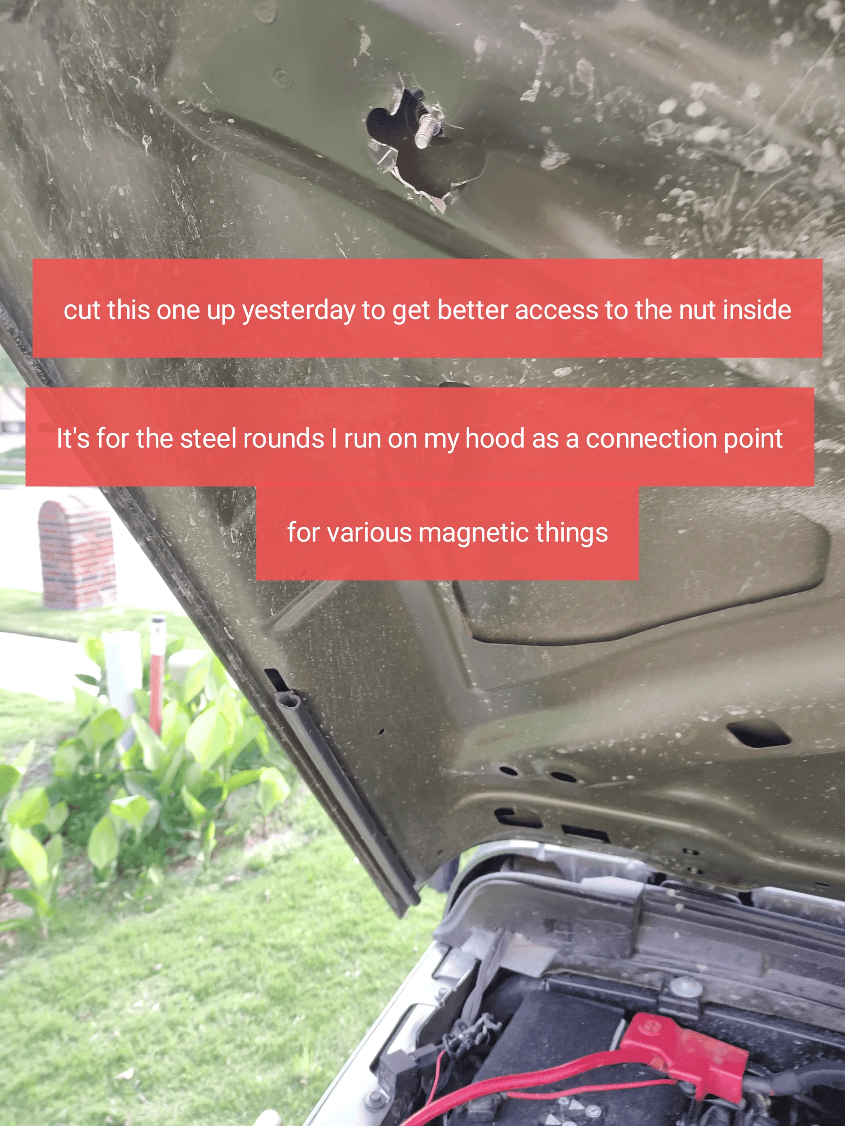

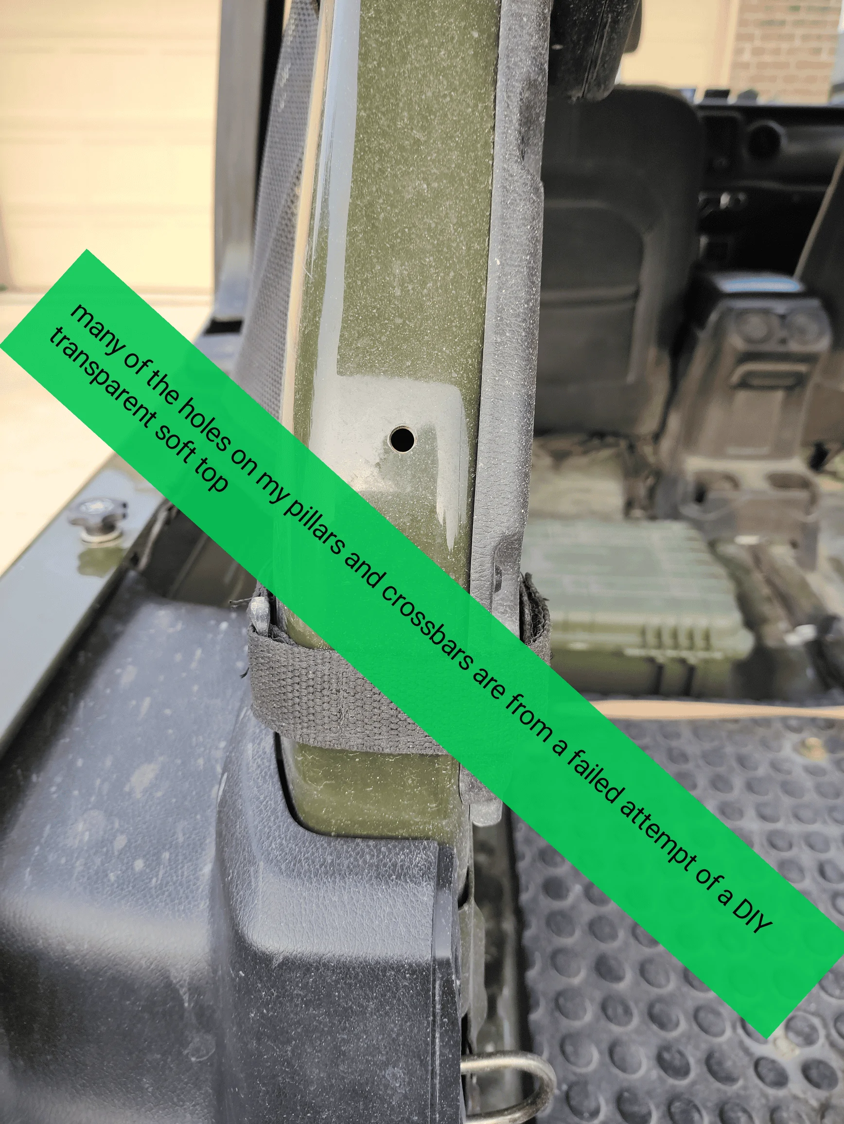

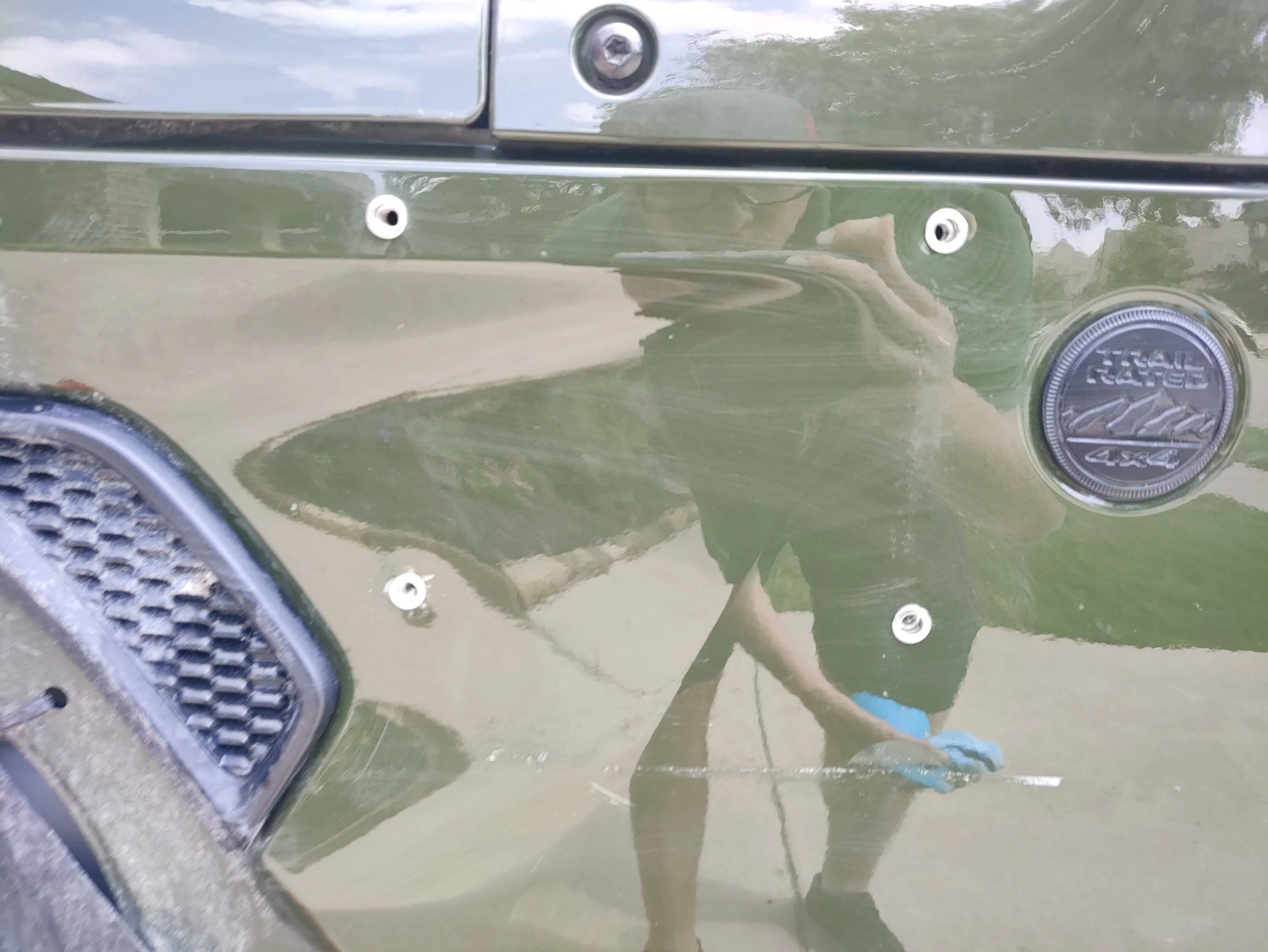

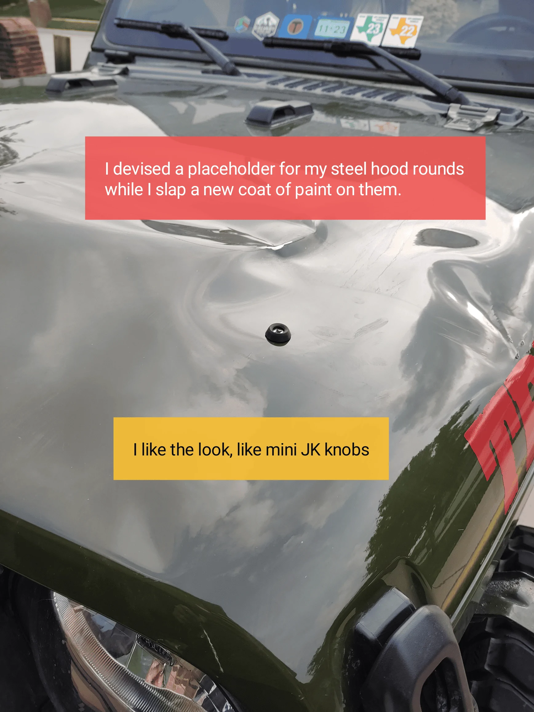

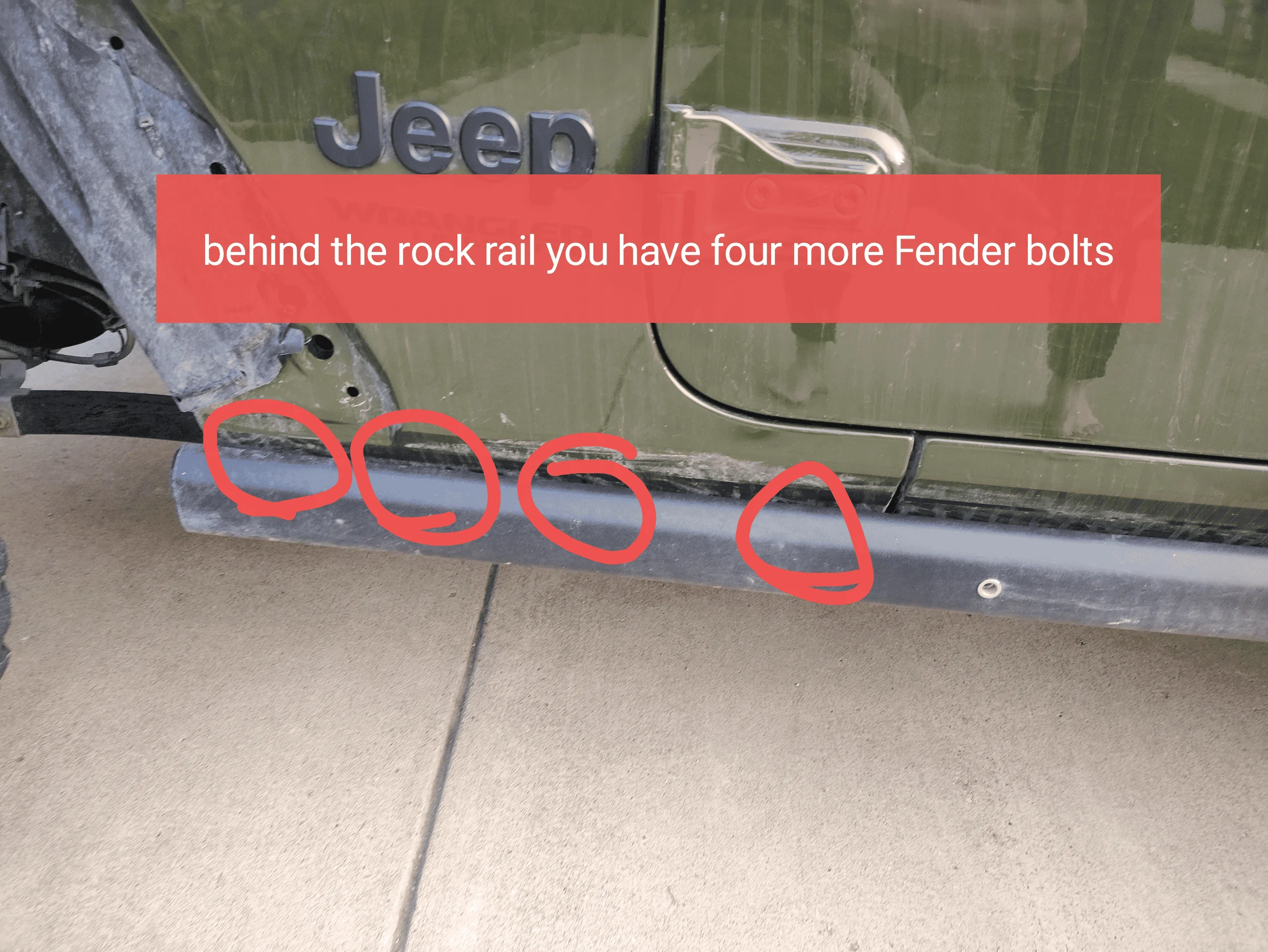

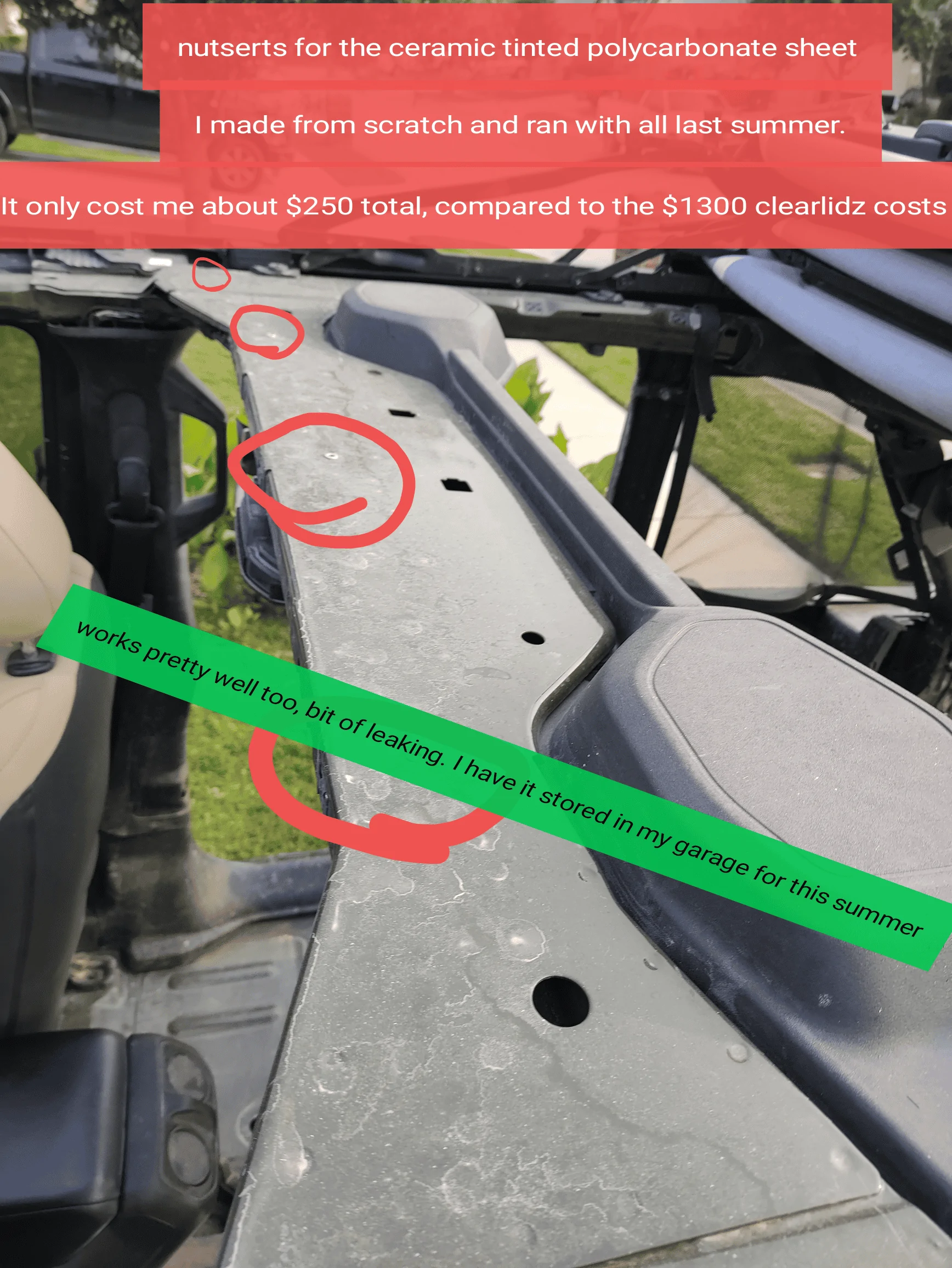

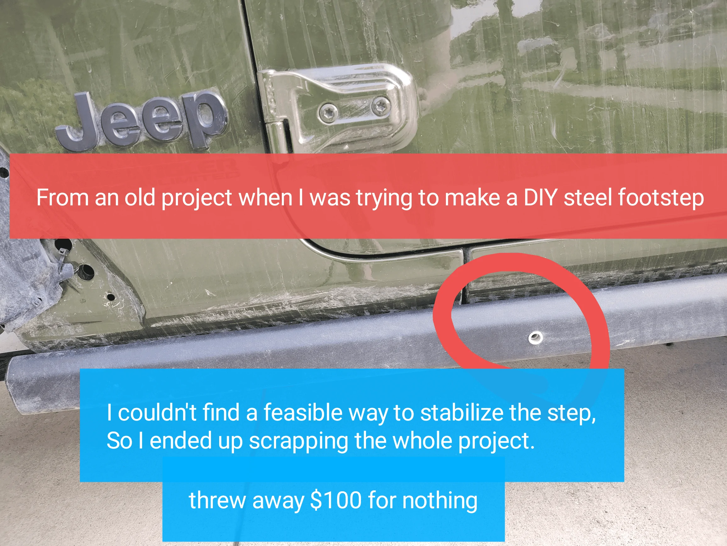

It's been a while since I counted how many holes I've drilled into my Jeep, so I just did a walk around... Exactly 30 holes drilled into my Jeep in various places at this moment. More to come to, I've got other projects that involve holes, namely in the front window frame (I want to put a JK mod on my front windshield, but the JL doesn't have the holes necessary, So I'm going to make my own!)
Not to detract from the thread, but here's some pictures of the carnage I've done to my Wrangler.
Jeep Wrangler JL Fender Mounted Fuel Can Holder Screenshot_20230512-191203-044
Jeep Wrangler JL Fender Mounted Fuel Can Holder Screenshot_20230512-190612-885
Jeep Wrangler JL Fender Mounted Fuel Can Holder Screenshot_20230512-190736-535
Jeep Wrangler JL Fender Mounted Fuel Can Holder Screenshot_20230512-190212-595
Jeep Wrangler JL Fender Mounted Fuel Can Holder Screenshot_20230512-190922-797
Jeep Wrangler JL Fender Mounted Fuel Can Holder Screenshot_20230512-190009-319
Jeep Wrangler JL Fender Mounted Fuel Can Holder Screenshot_20230512-185905-127
Jeep Wrangler JL Fender Mounted Fuel Can Holder Screenshot_20230512-185618-715
Jeep Wrangler JL Fender Mounted Fuel Can Holder Screenshot_20230512-185702-844
Jeep Wrangler JL Fender Mounted Fuel Can Holder IMG_20230512_184605069
Jeep Wrangler JL Fender Mounted Fuel Can Holder Screenshot_20230512-192152-025

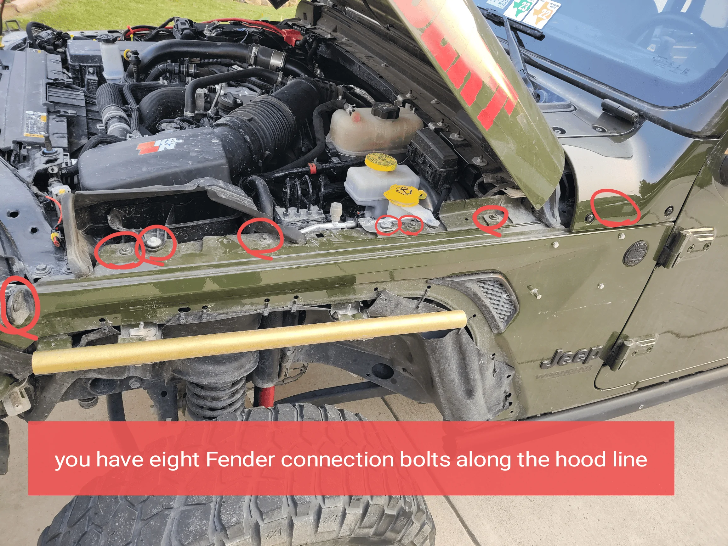

I’m surprised you didn’t put the top bolts on the OEM cowl bolt holes. They are close to the door hinge but they would be super strong. Could’ve made a bracket or something.
Deleted User 38384
Aug 4, 2020
140
6,081
10,669
The thought had definitely gone through my mind.
Jeep Wrangler JL Fender Mounted Fuel Can Holder IMG_20230514_092206002
If I had done a direct bolting to the cowl, (like you said) it would have obstructed the driver's door.

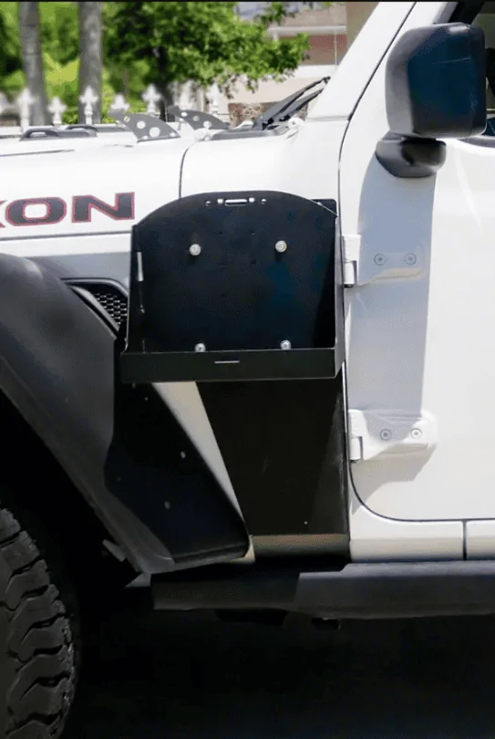

MORide has since released a JL version of that front fender mounted jury can't holder, however the bracket is MASSIVE, and way to obnoxiously large for my tastes. Also it's almost $200!!!
Jeep Wrangler JL Fender Mounted Fuel Can Holder Screenshot_20230514-101106-076
($80? $200? $80? $200? Tough choice!)

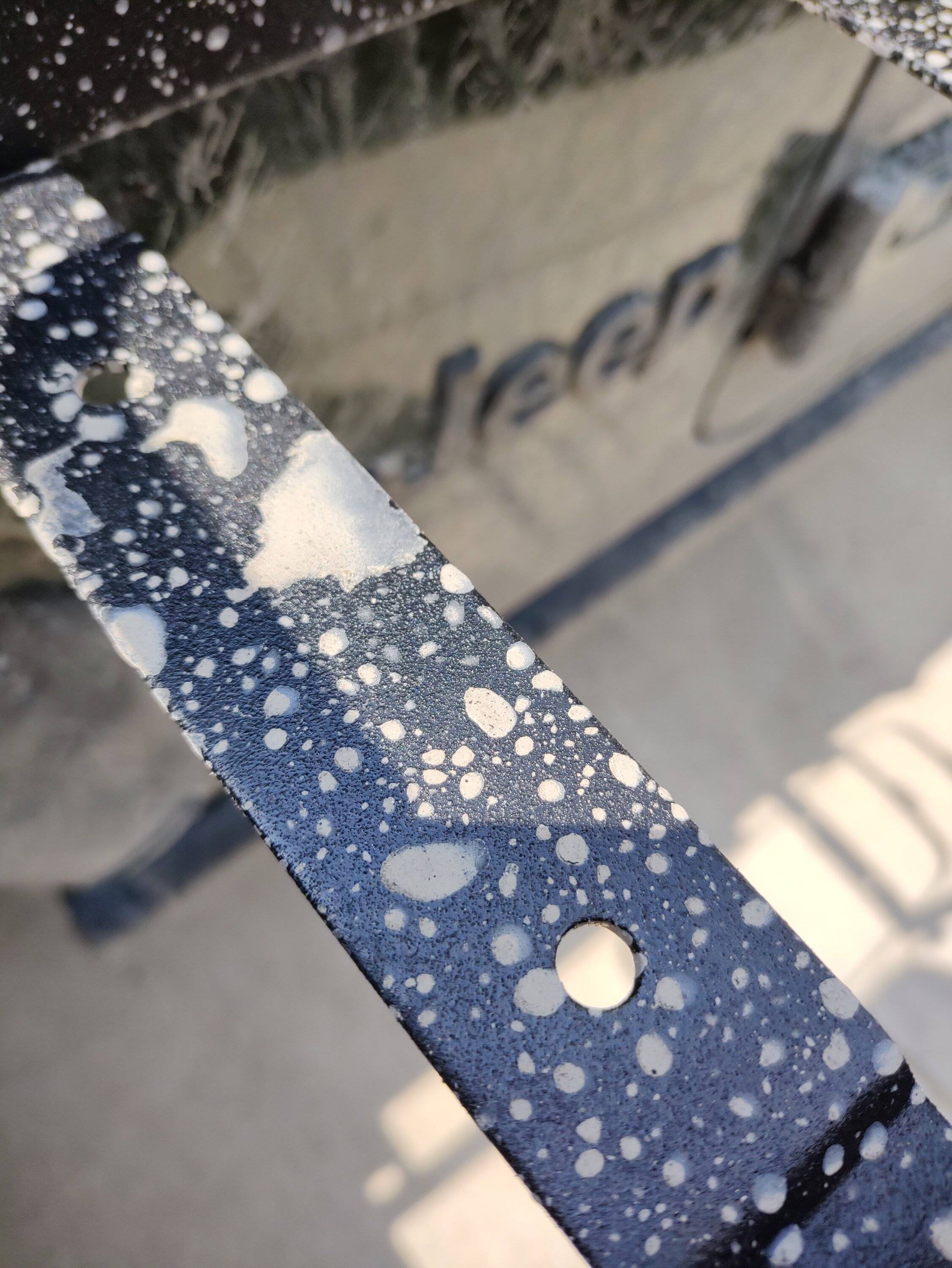

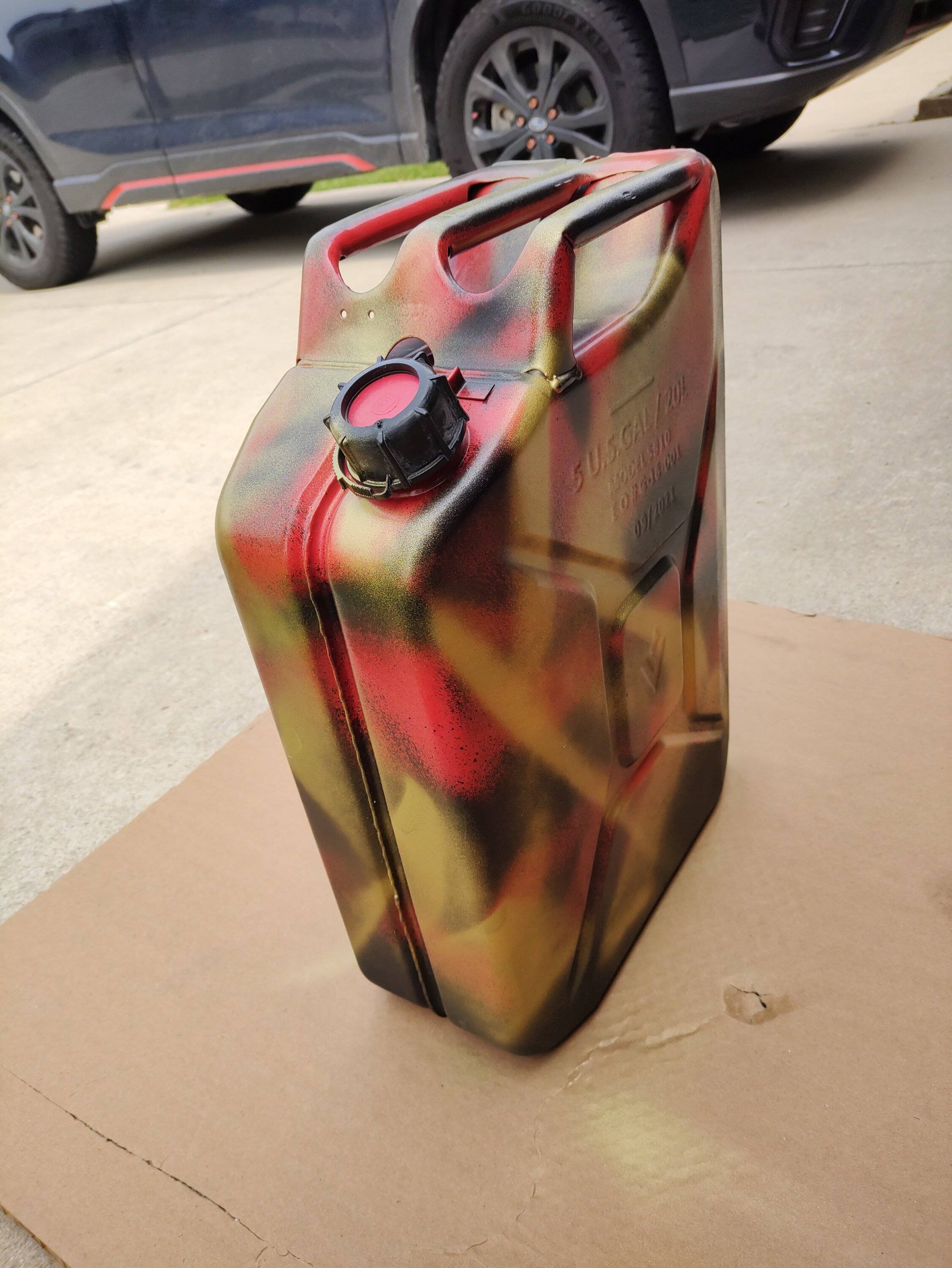

The Jerry can paint job came out pretty well I feel like. I'm going to let it dry for 2 days now before I put it back on the Jeep. Also the mount I painted in truck bed liner has been holding up pretty well for the last week and a half. Go through rain and a bit of dirt and gravel road driving I enjoy doing couple times a week.

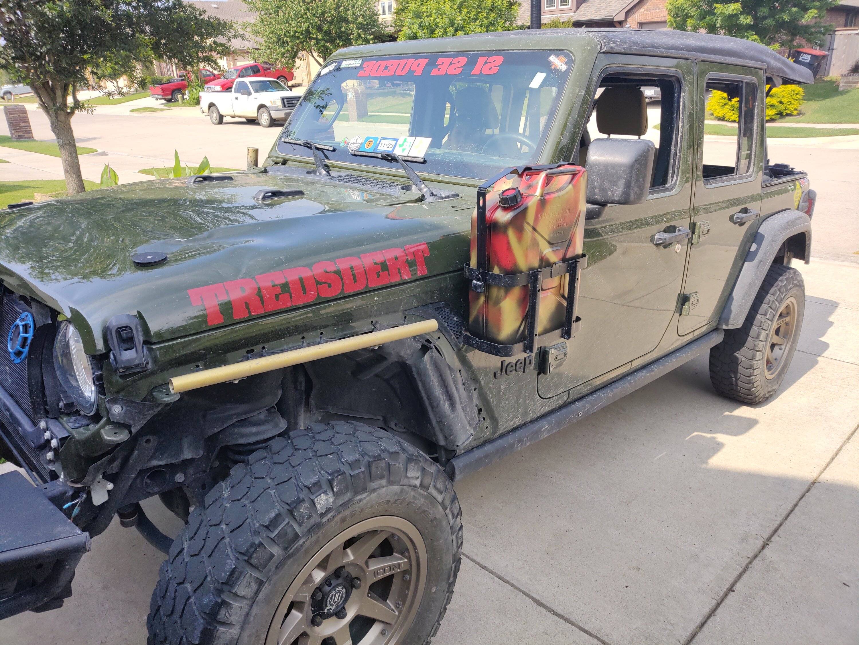

There you go, finished product!!
Jeep Wrangler JL Fender Mounted Fuel Can Holder IMG_20230529_102438535
Jeep Wrangler JL Fender Mounted Fuel Can Holder IMG_20230529_102417901
Jeep Wrangler JL Fender Mounted Fuel Can Holder IMG_20230529_102411657
