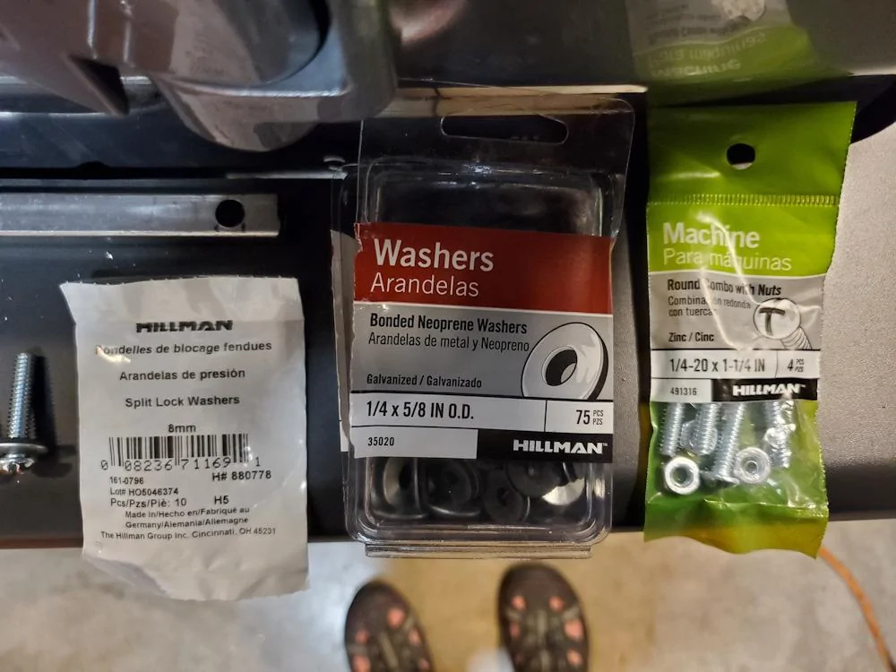

Hardware (I used 1/4" bolts and various washers shown in the picture below) - $8 (Lowe's)

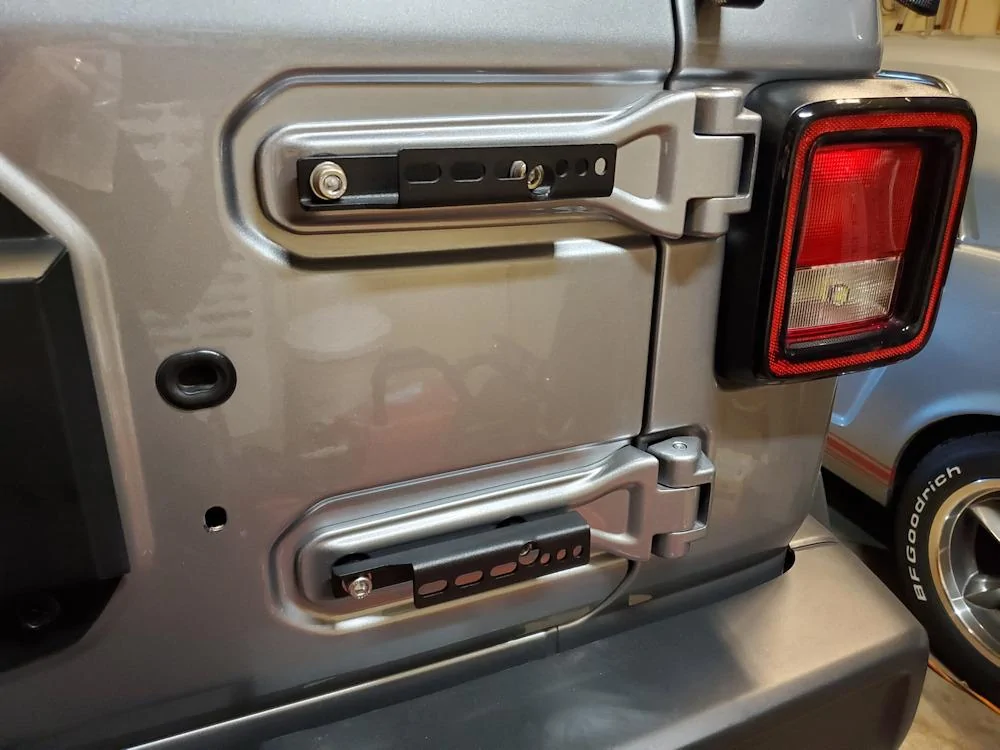

STEP ONE: Install Retrofit Offroad Tailgate Hinge Adapters.
You'll need a Torx 55 bit (that bit isn't included in the kit Jeep supplies for removing the doors, etc.). My bolts came out really easily with an impact driver (do the top hinge first, then the bottom). This will be the result:
Jeep Wrangler JL Jerry Can Mounted for $140 (Easy DIY) 1931541292b35760115fc3d92df724c1b289de55

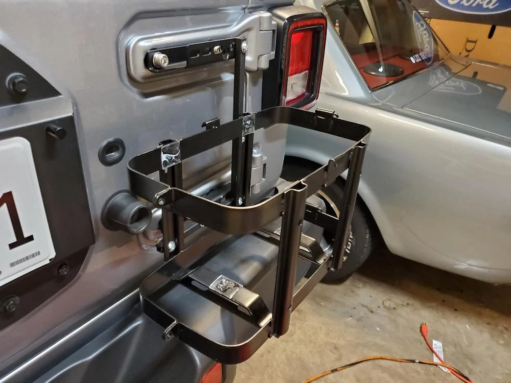

STEP TWO: Measure and cut vertical mounting bar.
Measure the distance from the bottom edge of the lower tailgate adapter to the top edge of the upper tailgate adapter, and cut your 1/2" boxed steel bar to that length. Determine where you need to drill 5/16" holes at the top and bottom (use a Sharpie to indicate where the holes need to go to mount to the top and bottom brackets). NOTE: You want to install the vertical bar on the second to right hole on the bracket (if you install on the far right hole, the Jerry can will not clear your tail light when you open the tailgate).
Once you have the top and bottom holes drilled, go ahead and fasten the top to the TOP adapter bracket. Then take your Jerry can mount and run a bolt through the bottom right hole on the mount and the adapter bracket. Now you can use a Sharpie to mark where the hole for the top right mounting hole in the mount needs to go on the vertical bar. Drill that hole and then mount the vertical bar and the can mount.
STEP THREE: Measure and cut the horizontal mounting bar.
You now have the can mount attached to the Jeep via the vertical bar. Measure from the edge of the vertical bar to about 3/4" beyond the bottom left mounting hole on the mount and cut your 1/2" boxed steel bar to that length.
On the bottom adapter bracket, there are several elongated mounting holes. Mark two hole locations in the middle of two of the elongated mounting holes. Next, mark the location of the bottom left hole on the mount. When you drill your holes in the horizontal bar, drill right where you marked for the locations that will mount to the bracket, but about 1/4" inward (away from the edge of the bar) for the hole that will be used to secure the bottom left hole on the mount. This will ensure the horizontal bar doesn't need to be further trimmed (because you are pulling it slightly away from the vertical mounting bar).
At this point, I used my bench grinder to clean up the ends of the bars and then sprayed both of them with some bedliner. Once dry, you can install all the hardware and tighten it down. For each bolt, I put a neoprene washer on the bolt, then a dab of Lock-tite on the end of the bolt, passed the bolt through the holes, then put a locking washer and the nut. The nut is 7/16" in size- so just hold the nut with a wrench and tighten with a screwdriver. Once you are all done, you have this...
Jeep Wrangler JL Jerry Can Mounted for $140 (Easy DIY) 23f2f2cf1898e028a487223cc690215899b8e8ef
The little plastic squares are "cushions" that come stuck to the mount- I'm guessing to keep the can from being marred.
STEP FOUR: Install the can.
I placed the locking mechanism on the left (but the mount can be installed in either direction). Install the Jerry can and then take the supplied metal strap and clip it to the side of the mount that is away from the latch hole. The spout side of the can goes towards the latch, and the metal strap fits over the handle and then is pulled down to securely fasten the can in the holder. I need to run out and get a small combination lock. That's it- you are done!

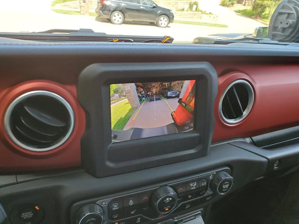

3. When I went for my first test drive, I did encounter ONE issue I had not thought about ahead of time. Apparently, that rear view camera has a VERY wide angle, and the can is going to obstruct a bit of your view through the camera.

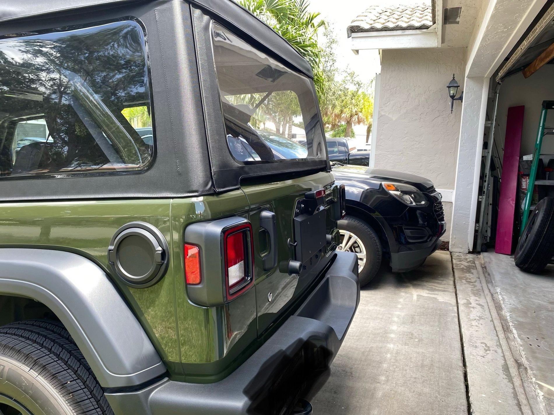

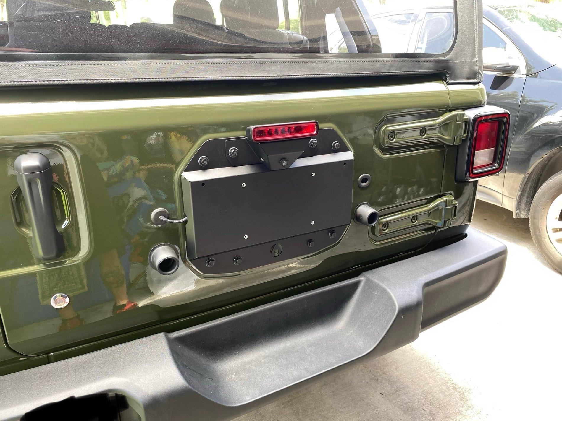

I'm trying to think back to when I deleted the spare. I believe that 3d tail light is integral to the tire mount (and the rear view camera mount). I mean, a Sawsall would probably take care of the light in short order, but you'd have to remount the camera...
Oh my bad! I meant the passenger side tail light.. Not the 3rd tail/brake light!

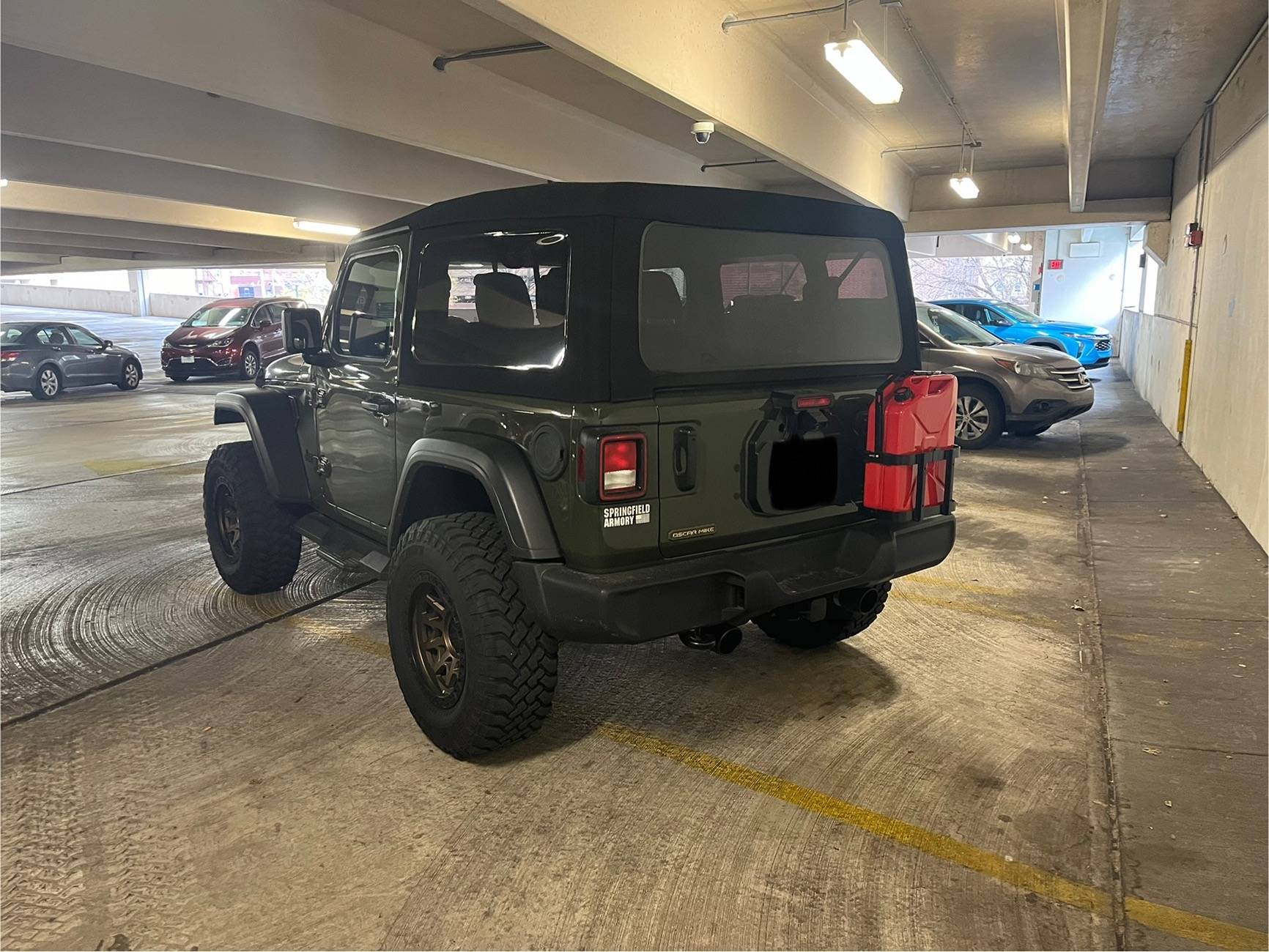

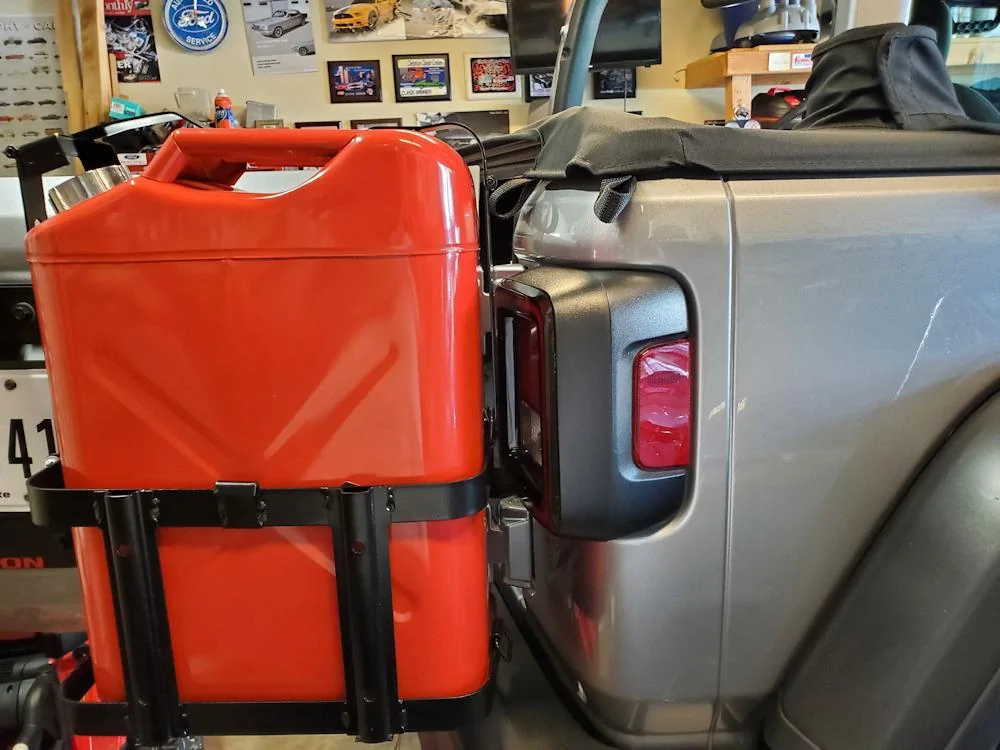

Hmm, can't say I can think of how to do that, but your comment about the passenger tail light got me thinking... Just wanted to post a pic from the other side to show the passenger side tail light isn't obstructed by the can.
