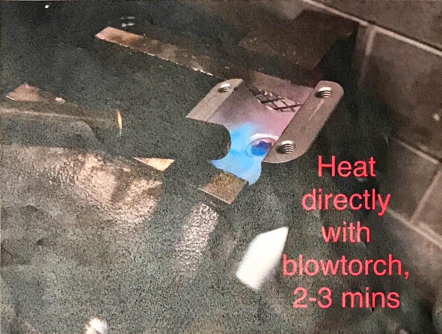

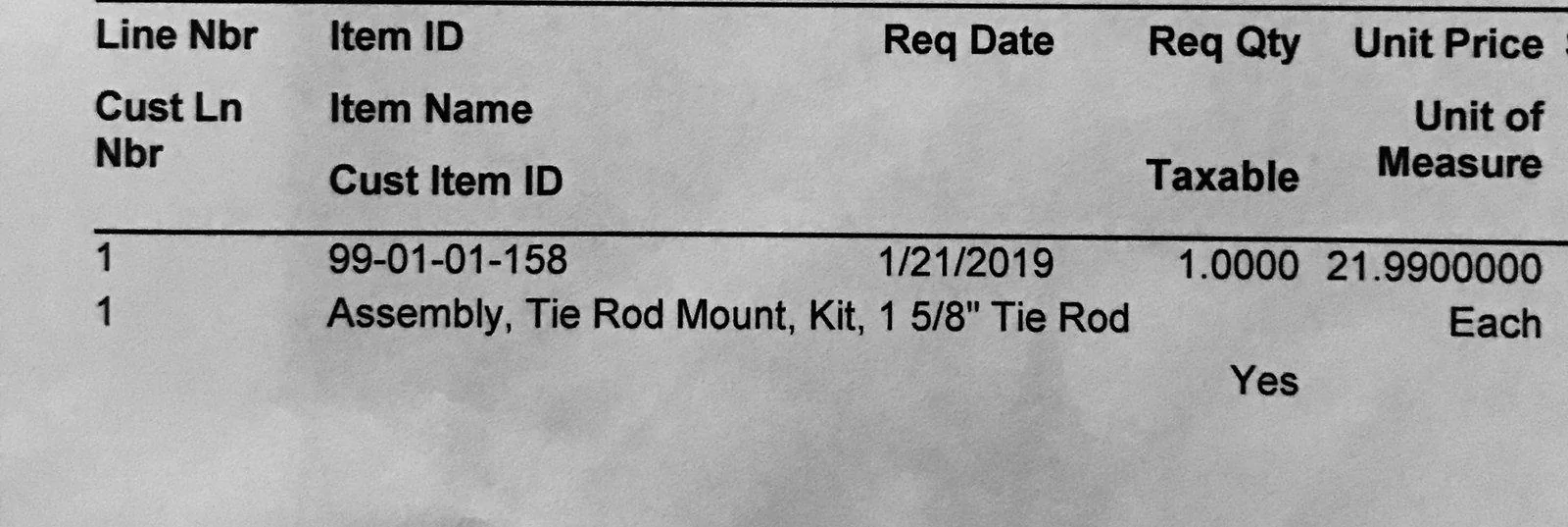

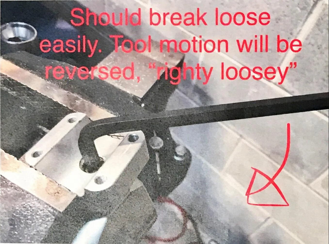

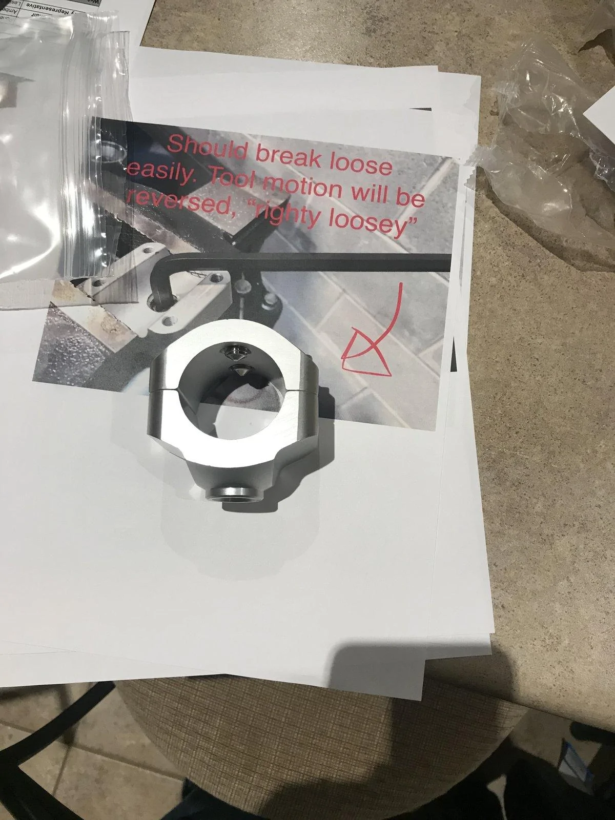

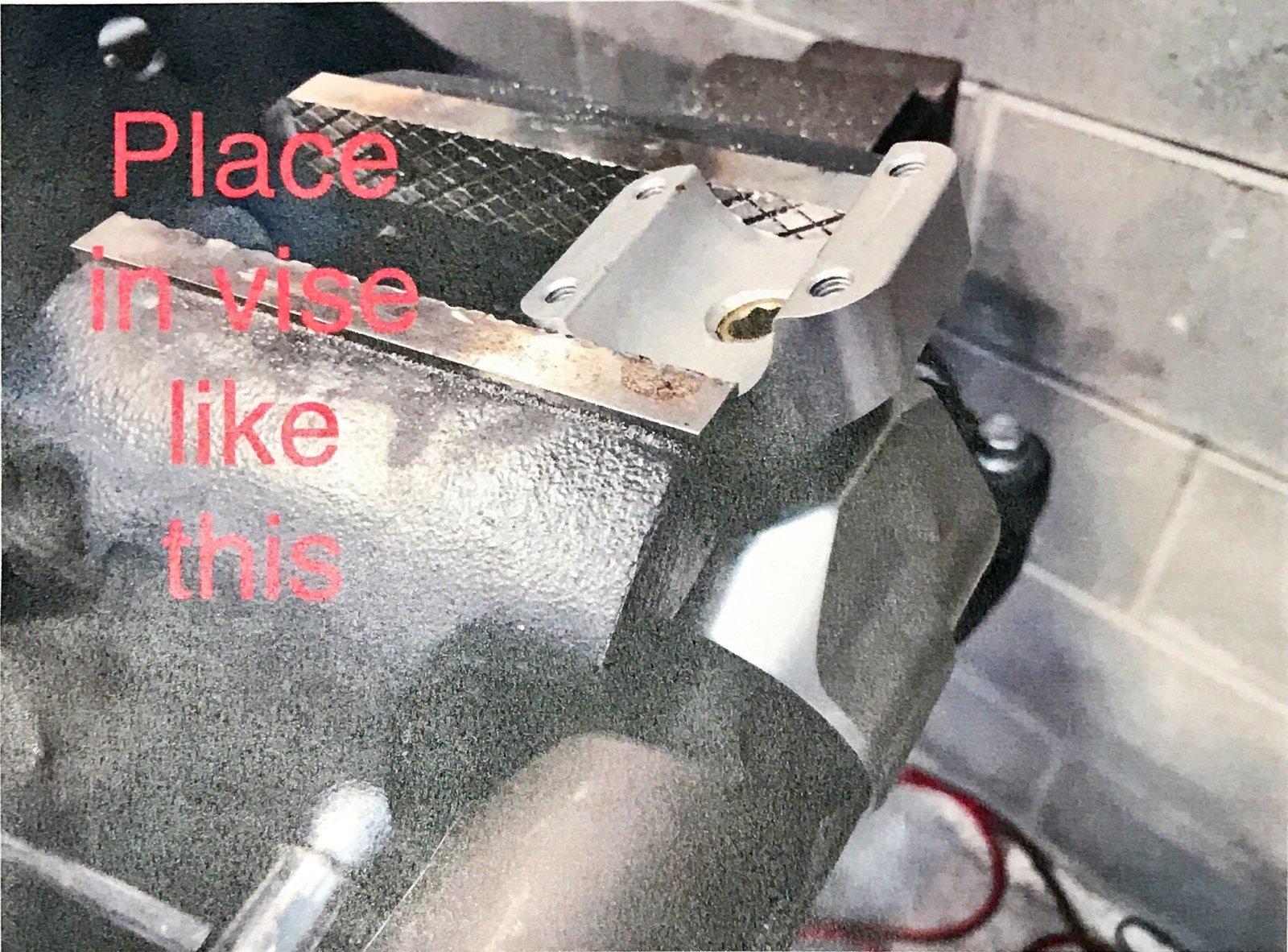

To mount the falcon nexus, you will still need a relocation bracket and a new mounting clamp. I went over to Teraflex the other day and they gave me instructions on how to change the mounting bracket to a clamp. This is just instructions for replacing a clamp but you can remove the bracket the same.
Part number 99-01-01-158
This is for a 1 5/8 tie rod. I think they also have a smaller one. $22 for the part.

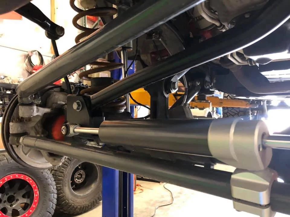

I have it with the steersmarts compliment and the only thing to worry about is it gets very tight for space there for the stabilizer. But that’s mainly because the steersmarts stuff is very large and the clamps are even more so cutting down room.

To be fair I changed to the steersmarts tie rod, dragline and track bar all at the same time so I can't say specifically to the tie rod itself but yes. Steering got noticeably better after that.
I'm using this with a steer smarts steering system.
Thanks for the info. Just wanted to point out, I was able to remove the mount from the JL version easily using a 10" 3/8 drive breaker bar without heat: maybe something to try out before applying heat.
