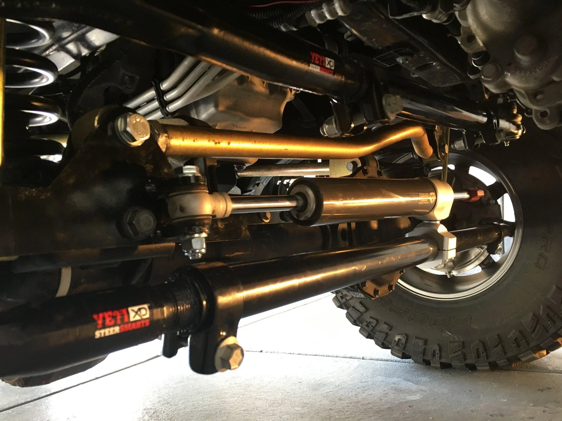

How is your shock's fitment in between the drag link and track bar at the various full turns P and D side? Does it rub against either when you turn the wheel full chock either way? I put some masking tape on mine and am driving around a few days to see if the parts rub. My track bar, much like yours, has the nuts sticking out, and I rotated them to avoid hitting the Falcon shock, but now they look like they might make contact with the factory SS bracket holes on the axle. I have some tape on there too, to see if they collide when I hit a bump, curb, etc..
Depending on the outcome, I might get an RK or MC trackbar which has no bolts sticking out right there, just so I have extra clearance.
Edit: NVM it looks like your trackbar has a relo bracket putting it up and out of the way, and it looks like your drag link must have something similar. I guess that is how Steer Smarts' kit works, huh? Neat!
I have a steersmarts relocation bracket that you see there which I bought from Northridge. It could be bought direct from steersmarts too. The draglink is a no drill top mount. There is absolutely no contact between anything. I have full turn to D and P sides.

Jeep Wrangler JL Falcon Nexus Steering Stabilizer Relation? 81400332-4F73-49F9-82CD-1DE0988113F3

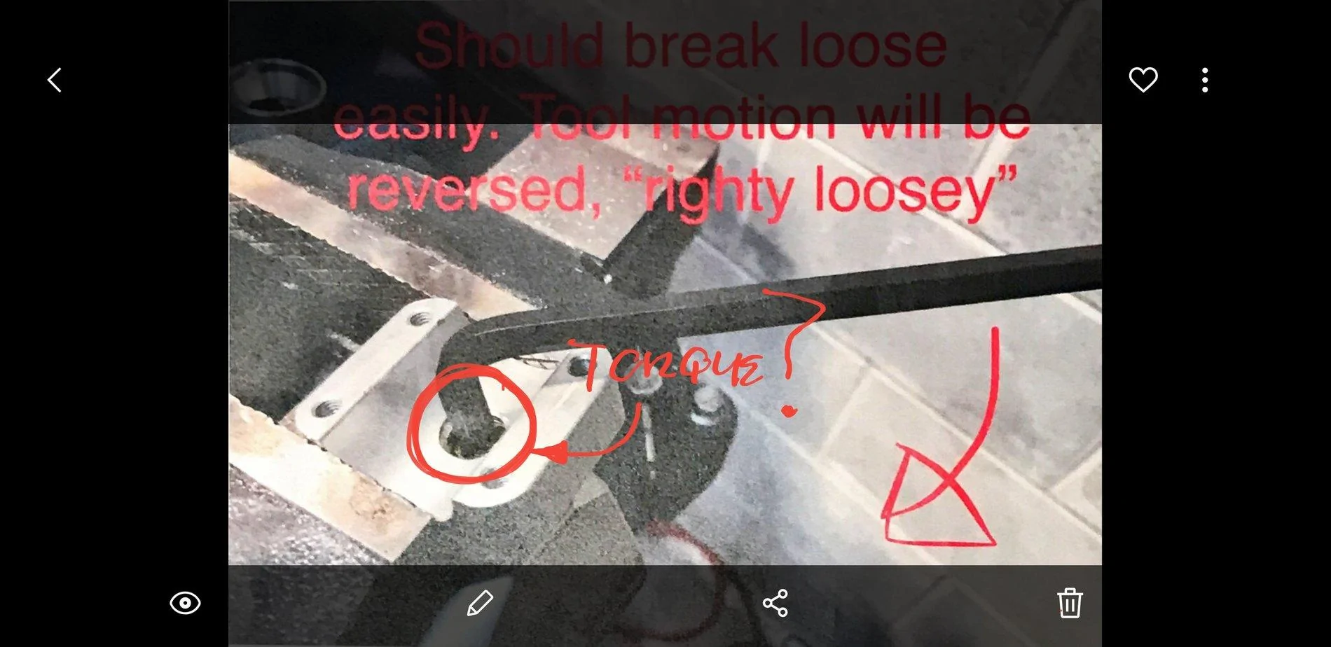

What is the torque of this bolt on re-install?
thanks!
thanks!
I called TeraFlex last week - they said their Falcon team was out, and he would get back to me on Monday. He never did. But, AFAICT, you just tighten that puppy down by hand and it will kind of lock in place as it squeezes in on that gasket. Just tighten as much as you can without going nuts. Also, you MUST use Green or Red loctite on it....
