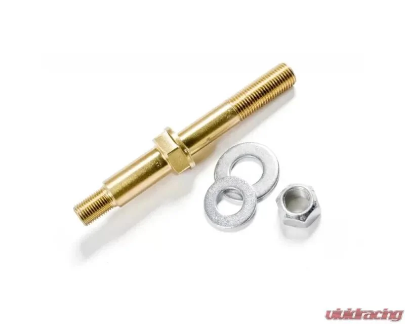

The MC tie rod clamp is designed for a closed end stabilizer, not a through shaft, you could probably hack it somehow, but I would just spend the 30.00 on a track bar bolt ( Synergy or Fox) and leave the stabilizer alone on the tie rod side….
