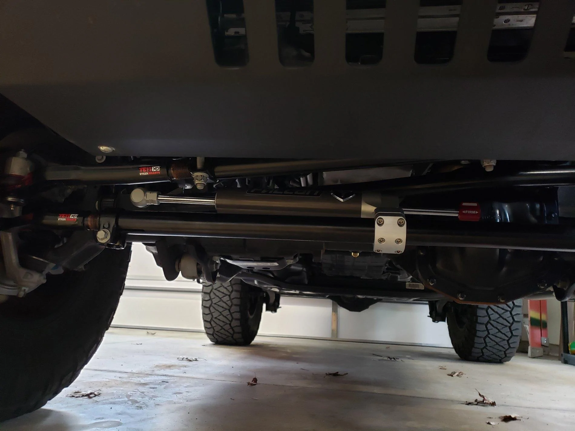

I just used the JK falcon 2.2 1-5/8" SS on my steer smart tie rod. Worked great no modifications and no relocation brackets.
How did the end not on the tie rod mount? I am looking at a yeti steering setup as well, but was planning to use the normal JL falcon 2.2 I would much prefer the JK version up and out of the way.
The shock is the same between the JK and the JL version of the Falcon 2.2. The only difference is the clamp mount vs. the new JL bracket-based mount. You have to remove the mount and swap it (order the other mount from Teraflex) - see the first 2 pages of this thread for details on the part number and how to remove these mounts from the shock.
Once you have the clamp mount in place, you can mount it to the tie-rod. You need the SteerSmarts trackbar bracket, or else the MetalCloak trackbar bracket, or else the Synergy or Teraflex trackbar bolt for the other end.

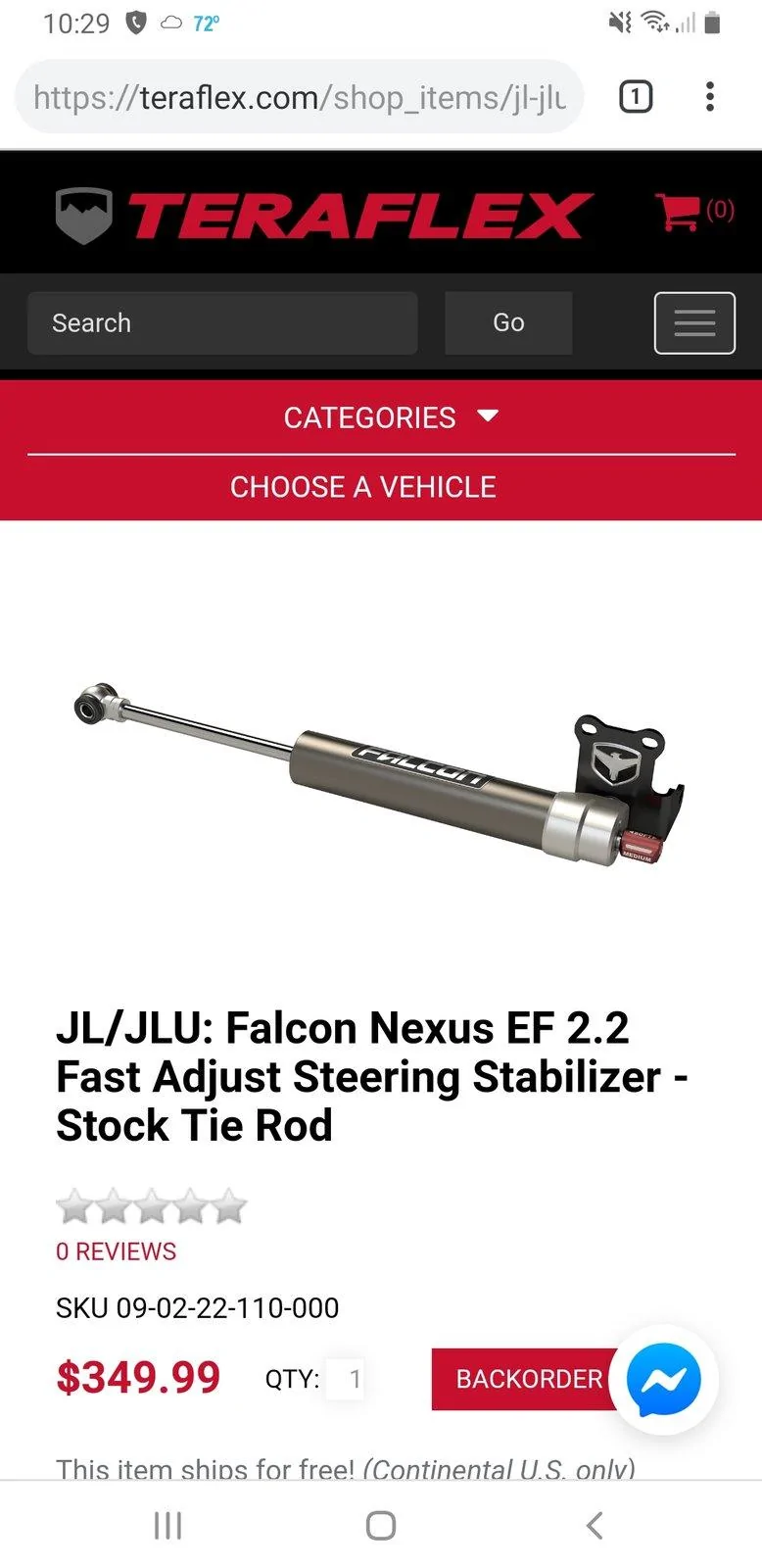

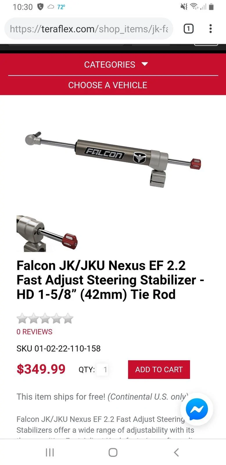

The JK SS is different in the fact it already comes with a cradle mount for the tie rod and it mounts to the axle by replacing the trackbar bolt.
JK:
Jeep Wrangler JL Falcon Nexus Steering Stabilizer Relation? Screenshot_20190411-103008_Chrom

You can see the difference in the JL:
Jeep Wrangler JL Falcon Nexus Steering Stabilizer Relation? Screenshot_20190411-102939_Chrom
Now this is if your replacing your stock tie rod for the Smart Steer.

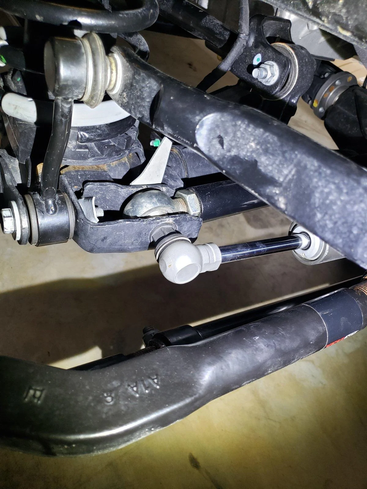

Ok so I got the metalcloak relo bracket in, and the Falcon 2.2 in, finally! The only thing is it looks like it just barely touches the track bar at full passenger turn, and just barely touches the drag link at full driver side turn. I don't know if a washer here or there would help offset it enough. Maybe on the drag link... I have a mechanic friend looking at it a bit later, and will post an update, but at least for now it's driveable and shouldn't get damaged so long as I don't hit bumps while full locked turning...
For those who have done this flip themselves, what was your experience? How close is it on yours??
Update: We did some more re-centering testing and got it to where it does NOT hit the tie rod, and just barely taps the track bar only at full turn lock (me holding the wheel). It's possible a different non-adjustable track bar may have more clearance (mine is adjustable right where it comes close). I may try an RK one at some point if I get the chance to...
I had to change out the RK track bar because it hit my falcon SS when I moved the SS up on the tie rod. The RK track bar comes down and out in front of the diff and hit the end of the falcon SS when turning. If I adjusted it to not hit the track bar it would hit the drag link. I had to put on a RC track bar that I had in the garage because it loops up above the differential similar to the steer smarts track bar and now my falcon clears all around. Just as an FYI before you buy the RK track bar.

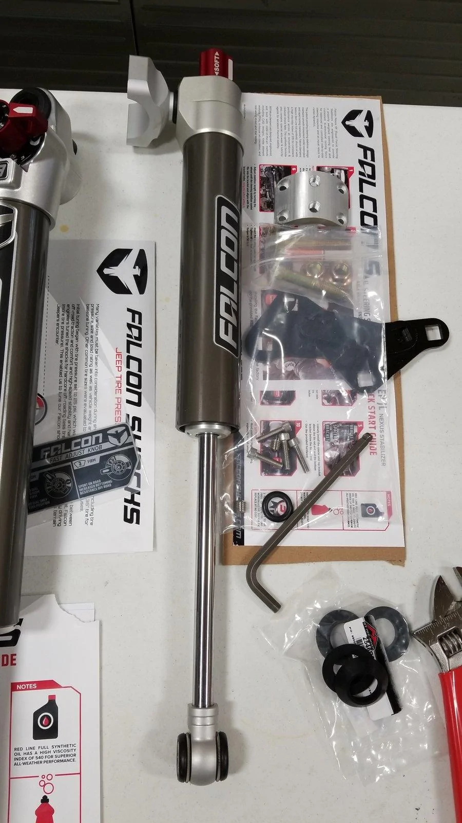

I spoke to Falcon. The shocks are not the same different valving. Taking the JL bracket off and mounting the Clamp was easy once I remembered it was "righty loosy". The $22 Falcon clamp was also a really good deal.

I called Falcon and they said that if we change the bracket the warranty is void and the valving is different on the JK vs JL version. Falcon did say you could order a JL version and have them change the bracket for ~$75 and keep warranty. I'm not too excited about adding another $75 onto an already expensive stabilizer that I may vary well not need in the first place. I also don't want to loose warranty......ughhhhh.....I might just limp by for a couple months until Falcon comes out with the 2.2 that has a 1-5/8" clamp on it. Supposedly it is in the works.
