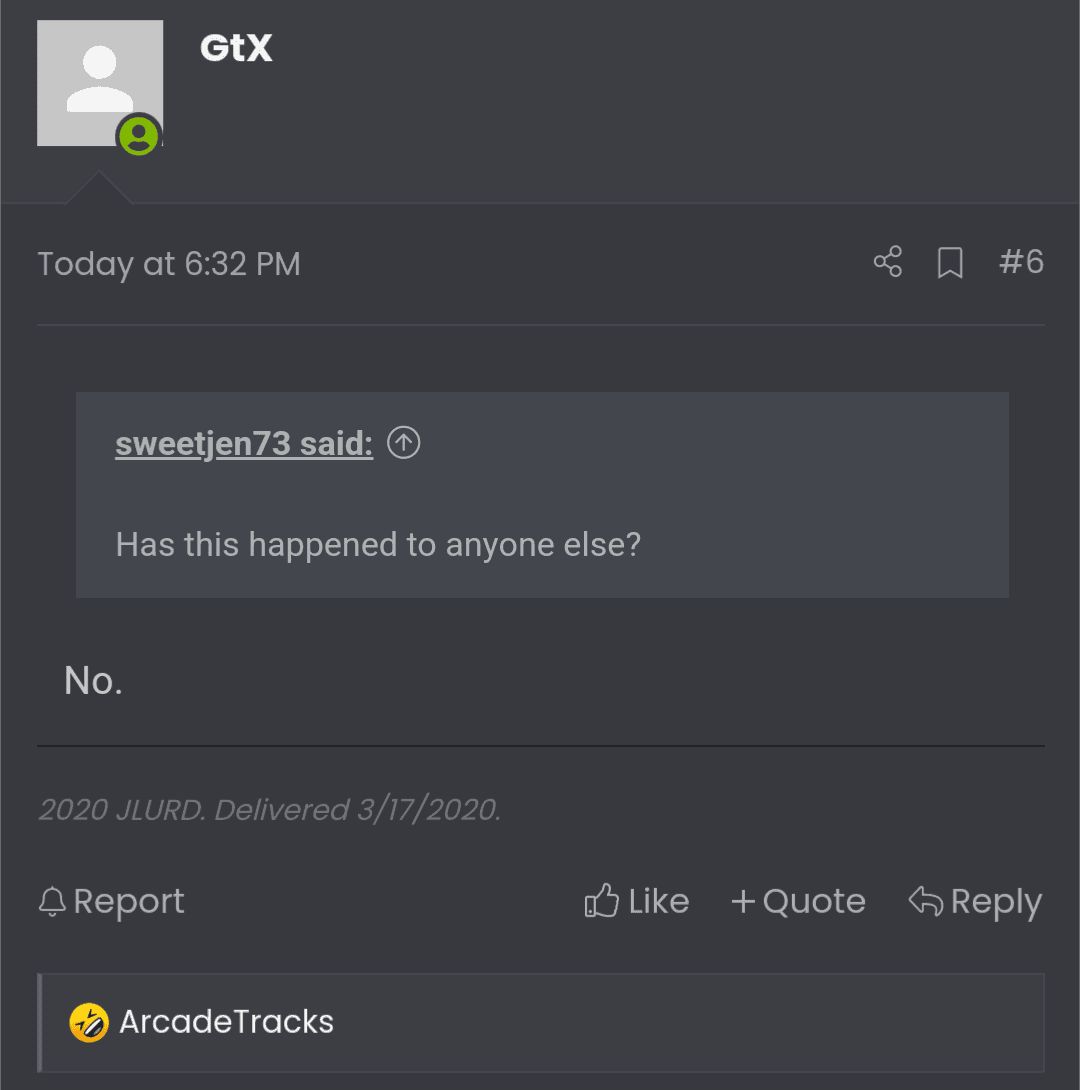

I didn't.
Maybe the fuses aren't pushed down?
@sweetjen73 didn't ask if it has happened to anyone else and you didn't reply to that question with "No."???
Maybe I need to have my glasses checked?
