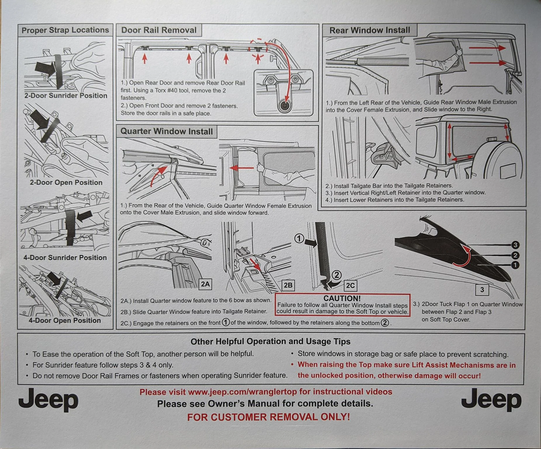

Jerry, you are absolutely right that the recall expressly states that Sunrider Position need not involve removal of any of the 3 soft windows. It's on the bottom rectangular section of the second page, second bullet item on the left, in black and white, clear as day, and just as you said and included a picture of...
And you may also very well be right that this "recall" was in response to all the chatter here on the forum about this subject matter....but
(take a breath)
.....along with this bullet point, several rows down is a disclaimer implying that this very document is incomplete and that the Owner's Manual should be the source for complete details.
I don't care what anyone does. Further, I keep my windows in. But this card you refer to does not replace the owner's manual.
We know this not only from the disclaimer I cite, but the other 8 page booklet/documentation that came (at least with my) recall that expressly says that this 8 page booklet IS an addendum to the Owner's Manual, in no place saying that you should refer to the owner's manual for complete details, but rather that this 8 page addendum IS the new (freakin') owner's manual on this subject--which doesn't seem to have the same information as the 2 sided card you and I (initially) refer to--I think...please show me otherwise--I'd be thrilled.
At this point, let's just hope nobody gets hurt. That's always the important thing and I think by far the actual scenario.
Still more, who knows, if the injured litigate FCA, how the courts (who have jurors that often aren't 100% objective because they're human) will decide. In fact I hope it would be against FCA who seems to endorse leaving the windows in as you've pointed out.
But what you, I, and everyone else thinks is or should be the case ***may*** (or may not I hope) find that disclaimer to be FCA's "get out of jail free card" to get around paying a settlement, or a large one on such matters. Law may (although I doubt and hope not) find that the card you refer to could, for argument's sake and hypothetically, expressly endorse "standing up in the rig while going under a 6' underpass," advice near certain to "end badly," and still indemnify FCA because of this disclaimer--should the Owner's Manual not also stipulate such reckless behavior.
You would agree that FCA put that disclaimer there for a reason Jer..right?
Please, lets leave this a "you're right Jer." I hope you are. I hope my theories are wrong. I want them to be and would not be shocked to find that they're wrong.
That would be fair and just, which the law is suppose to be but sometimes isn't, or appears not to be based on circumstances we don't appreciate that the courts have had to deal with in past cases, and the need for such decisions to remain to be the case in the interest of keeping the law stable, if not static, barring truly new circumstances never before considered or conceived of.
I beg for not another drawn out "who is right" thread on this topic. I hope everyone respects opinion, and realizes I don't endorse indemnifying FCA here, and hope (and believe) it doesn't, but it might, at least in part.

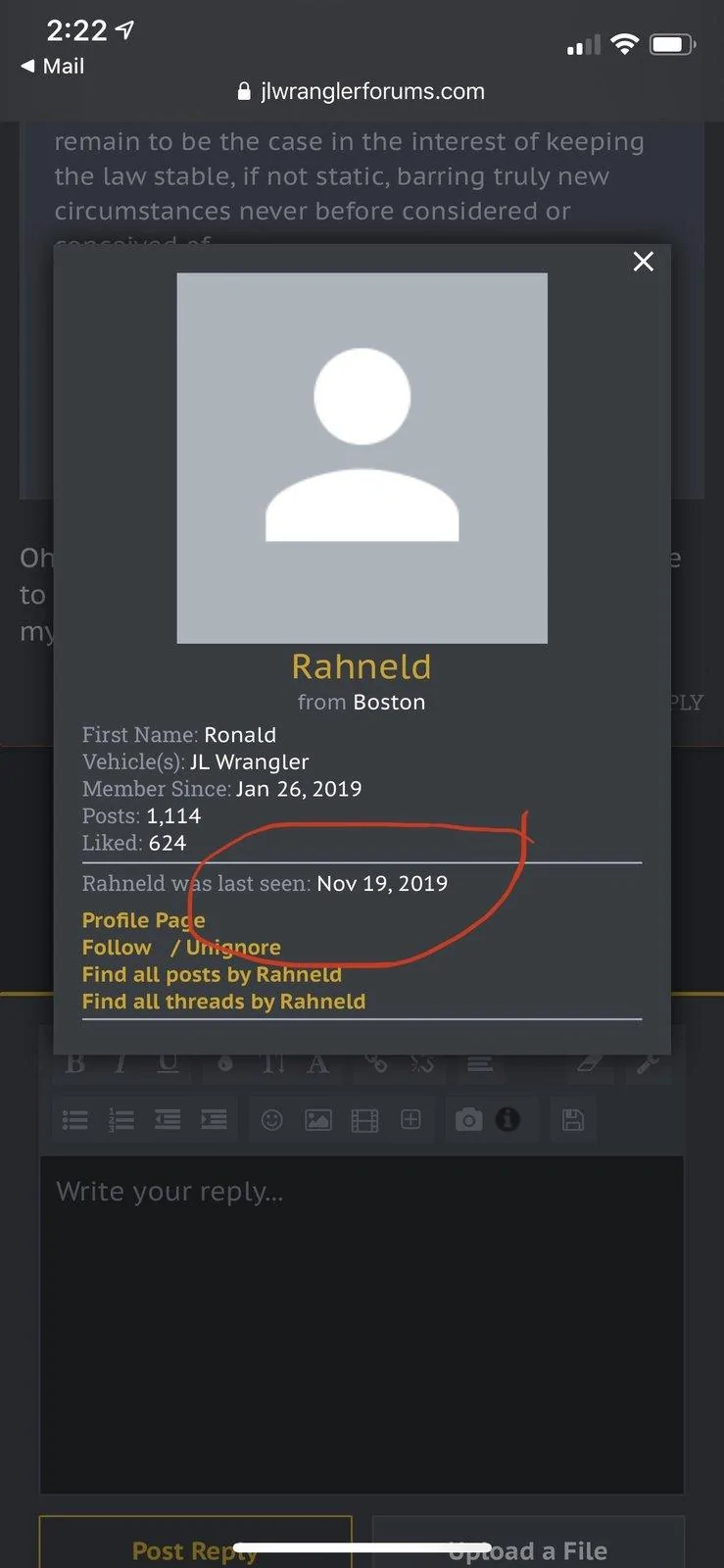

Oh, boy. Looks like @Rahneld changed his handle to @Gee-pah.
Here we go, again
. Time to update my ignore list.

I wish the recall stated what the f people were doing wrong so I don't do that too. All I see in the addendum is everything the installation instructions that came with my top already pictographed.

Agreed, they left out some useful info.

Wait, do you mean everyone reads and follows instructions? I think not. You can follow the instructions and may still have an issue under certain conditions. With the back end sealed (top up windows in) and air rushing in through the sunrider or windows it has to go somewhere. Some people report the bottom clips of the side windows may pop out to relieve the pressure. Others say the entire window blows out. Some have no problems.

I Received the new guidelines from FCA the other day. Unfortunately I had to
learn the hard way to install these windows (all including rear with the removal of the bar which attaches to the tail section), as well as lowering the top. I read their new
release and I would recommend everyone to throw out the old, which were
provided with your new vehicle. Even the simple thing (Old manual) about relocking
after the top is raised. Serves no purpose, but if you forget to unlock when you start
to lower the top, it will bend the steel side supports which jeep may replace under
warranty, but maybe not, since you have been informed.
