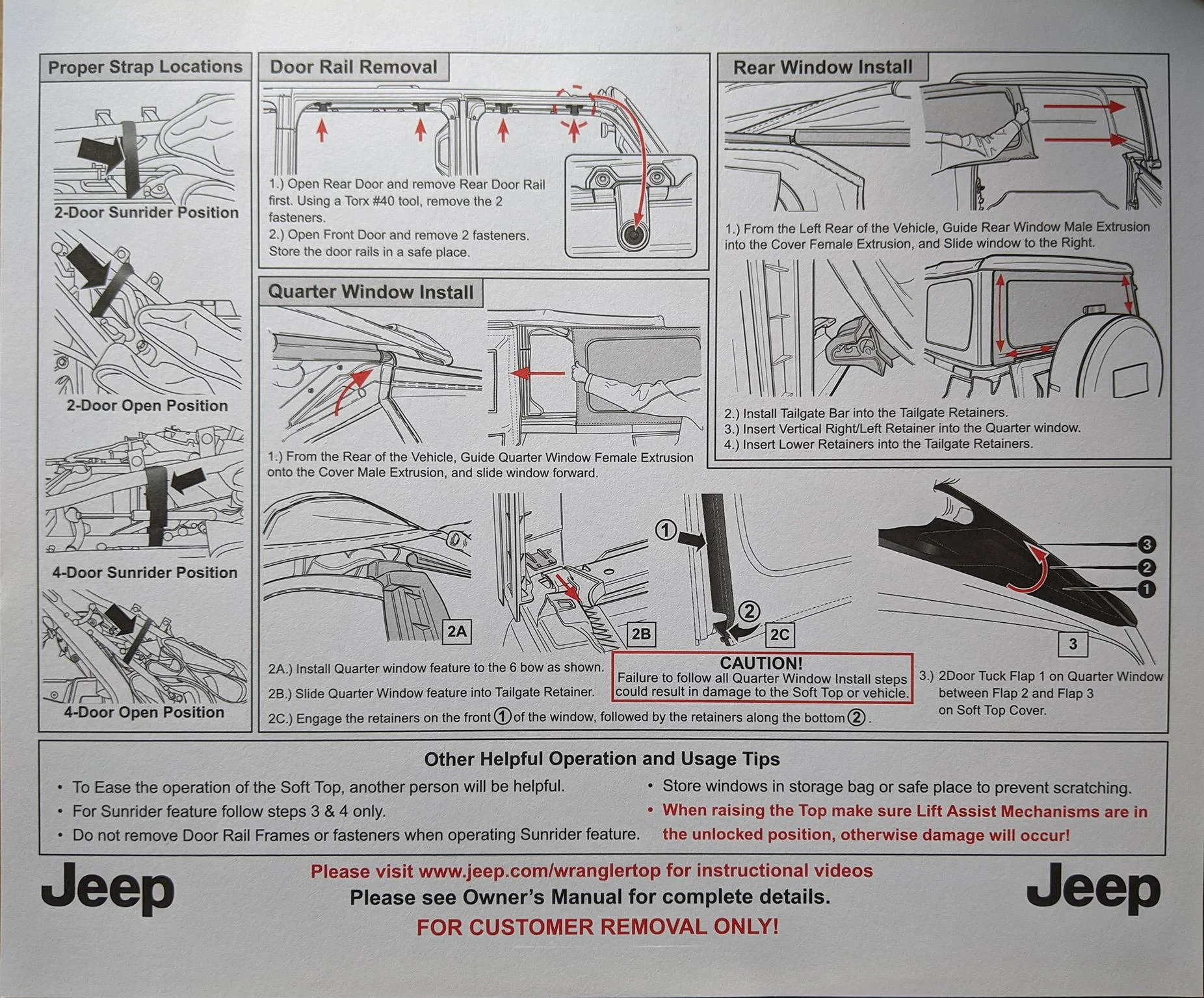

@nerubi Mike--I'm including you here because I think, from another thread, you got this taken care of at the dealer while there for other things just recently and might be able to respond to this:
Today I received a recall notice from FCA on my 2018 Sahara JL regarding how my rear quarter windows vertical retainer may not be property installed to the door rail.
I must have taken my stupid pills.
What is this--what does it mean? ….vertical retainers...things that prevent things from changing their position with respect to the ground, right?
Could someone explain to me what the issue is better than FCA seems to have. Or maybe it's not FCA, maybe it's me.
Thanks.
