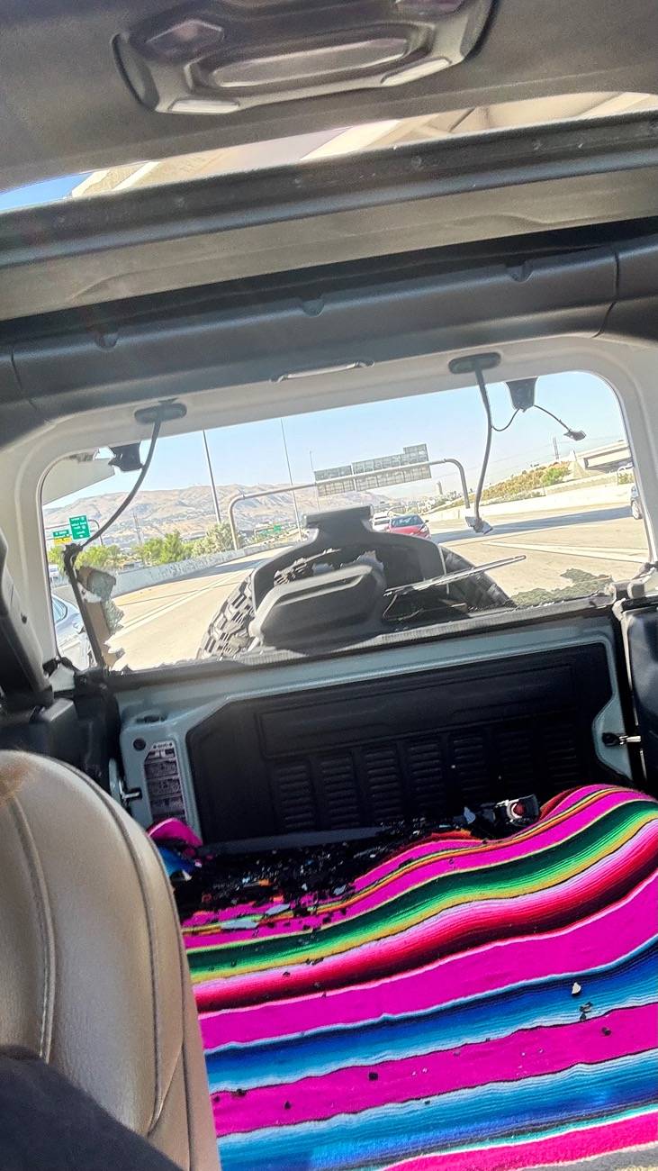

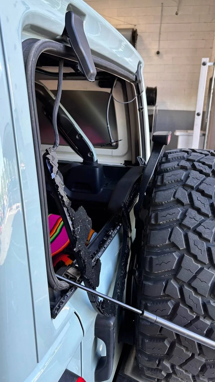

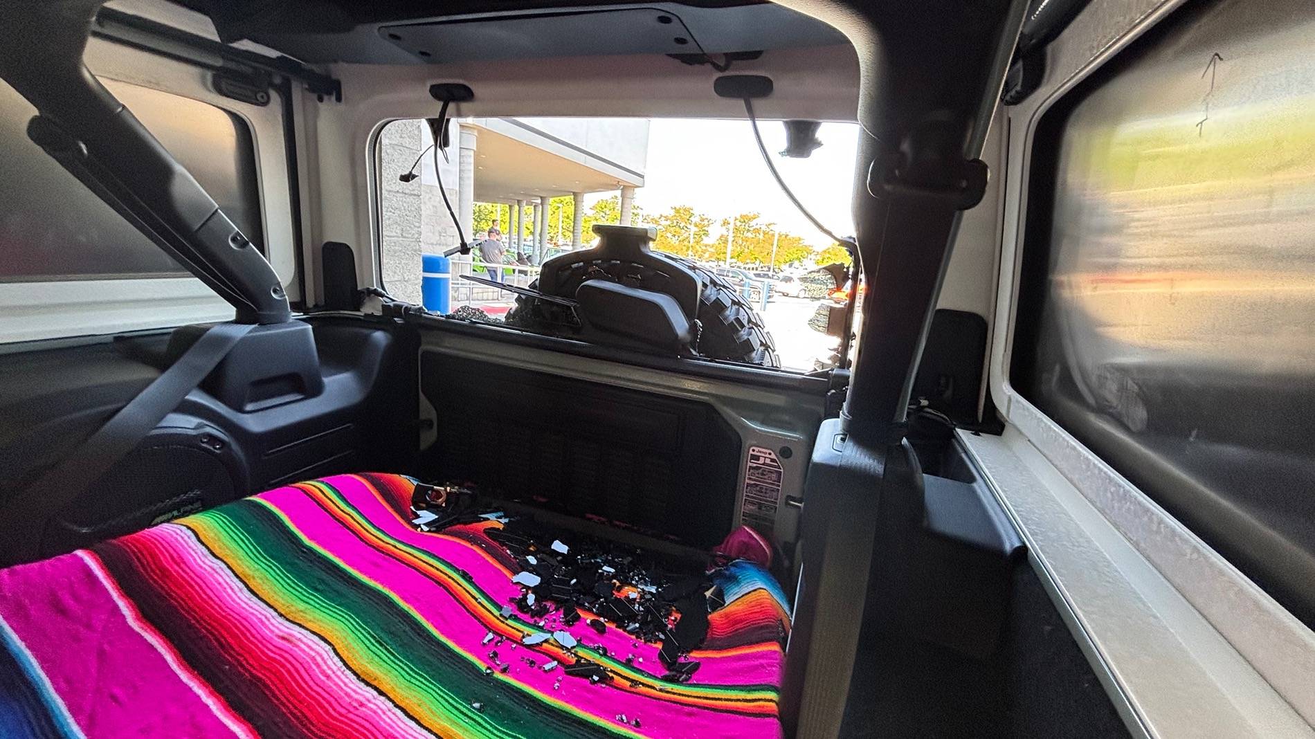

First post. Love this Jeep. Long time forum creeper. Joined yesterday. While driving to work today had cruise control set at 68 top back windows down. I hear a loud explosion and look behind me. There’s no window. Glass everywhere, parts hanging. Stopped at the Jeep dealership on my way into work - service advisor chuckled and said this will be an expensive repair for you. I asked would this not be covered under warranty. He told me not to hold my breath. $2000 repair. 2023 diesel rubicon w/sot. 40k problem free miles. Have not been to the dealership once. It does feel nice having the air blow through - I thought about removing the rear glass. This was just a quicker way to do it. Just out of curiosity how many people have experienced this?

This has happened to several other Wrangler hardtop owners. I do not know the cause. I suspect it has to do with internal stress in the glass from the tempering process.

This looks like the window was up while driving and smacked the spare from a bump. A widow blowing out from pressure does not leave that much glass in the vehicle. I have never seen a Wrangler window blow out from pressure, I have seen them slam down on the spare and explode.
Edit: Ok, so looking closer at the pics. The window was definitely closed. I would also have pushed hard for warranty, but the dealer has no way to verify that nothing struck it, so I can see why they would deny a claim.

You can see the window seal closed against the tailgate. I never drive with it up.
