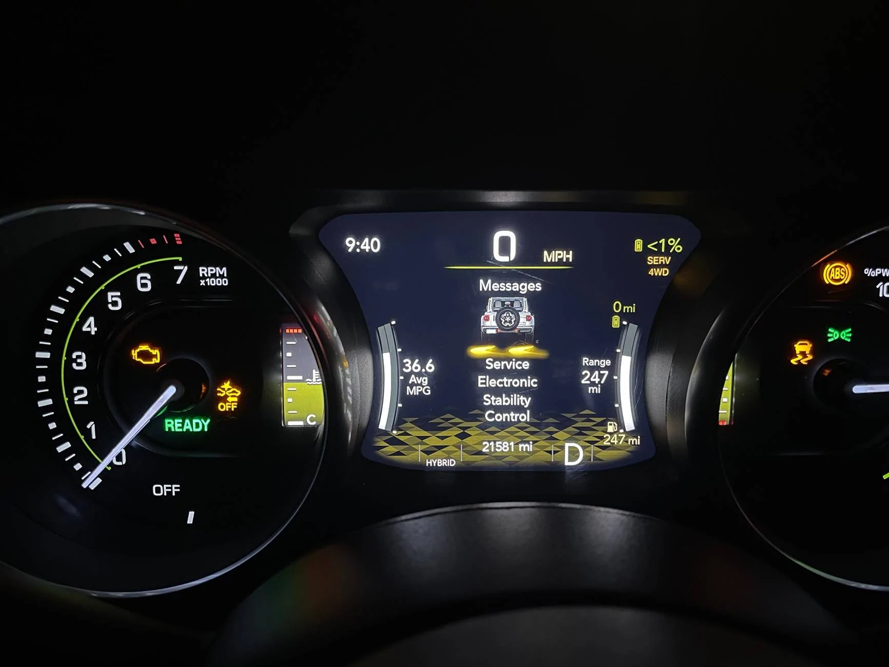

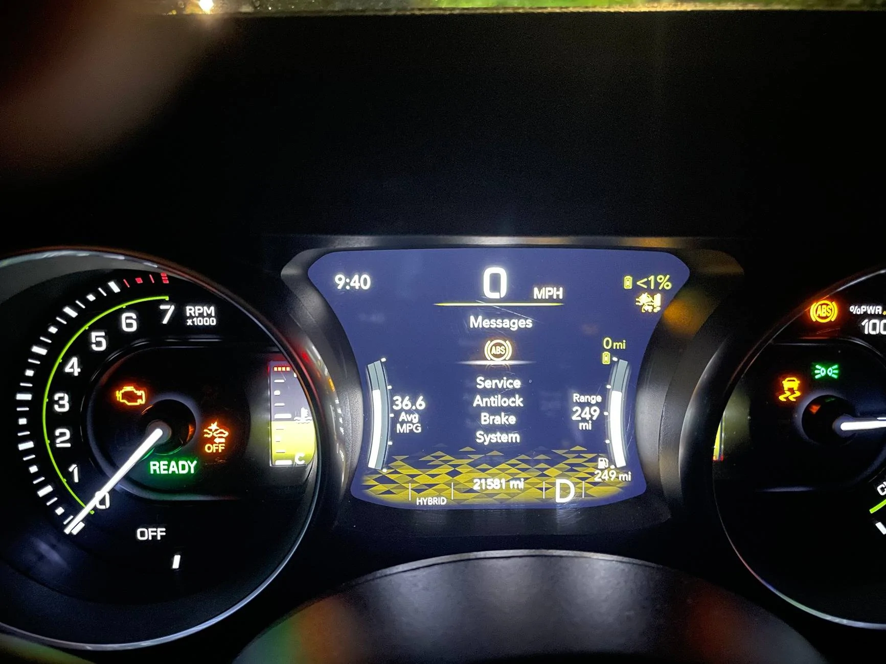

Just replaced new axle shaft and problem is fixed. But after replacement I got on dashboard "Service Electronic Stability Control" and ABS "Service Antilock Brake System".
Any idea how to fix it?
Just clear the code and see if it comes back. if you had the ABS sensor unplugged it will throw a code.

Do you know how to clear the code?
Thank you.
if you don't have a scan tool you can go to a parts store and they should be able to clear it for you.
when I had a code I disconnected the battery for 15 minutes and reconnected it and the codes were gone but I don't have a 4xe.

Check to make sure you didn’t leave the sensor unplugged or damage it during the replacement. You shouldn’t have any fault codes as the replacement is all done with the key off and it won’t check the circuit until powered on.

Probably sensor as other pointed out. Check it is properly seated and connected. Before replacing pull the code

Sensor plugged in properly. I got a code U1412 which is indicate that issues with wheel sensor. I guess it was almost destroyed because the crooked axle kept catching on it.
