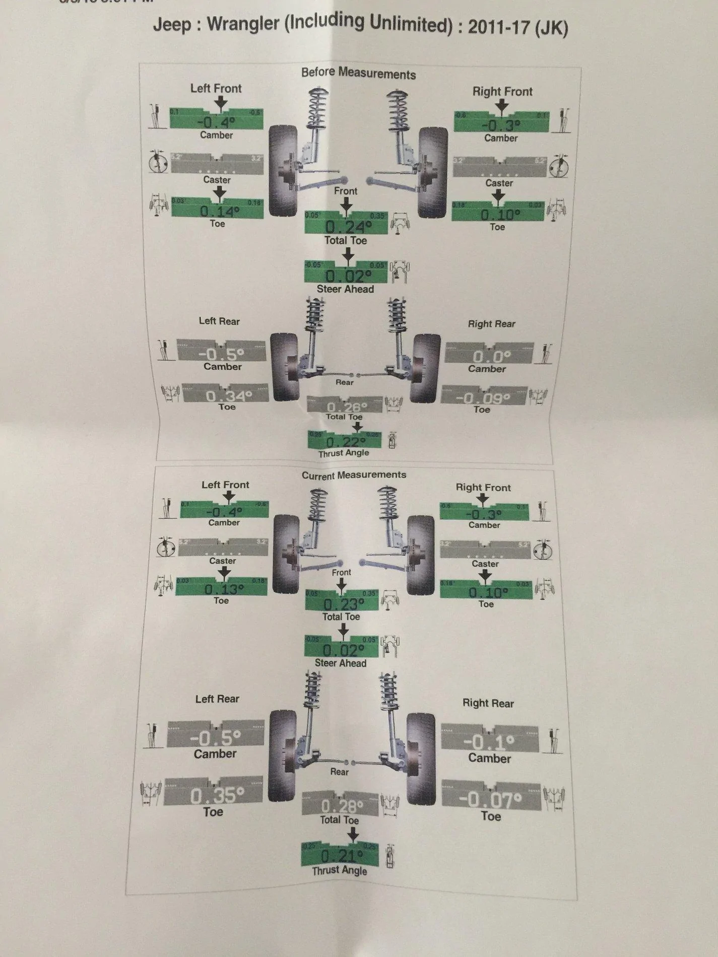

Road crown is there to help the water drain off to the sides, that is why it is raised in the middle, unless it's a sharp turn. It affects vehicles with wider tires more than others.

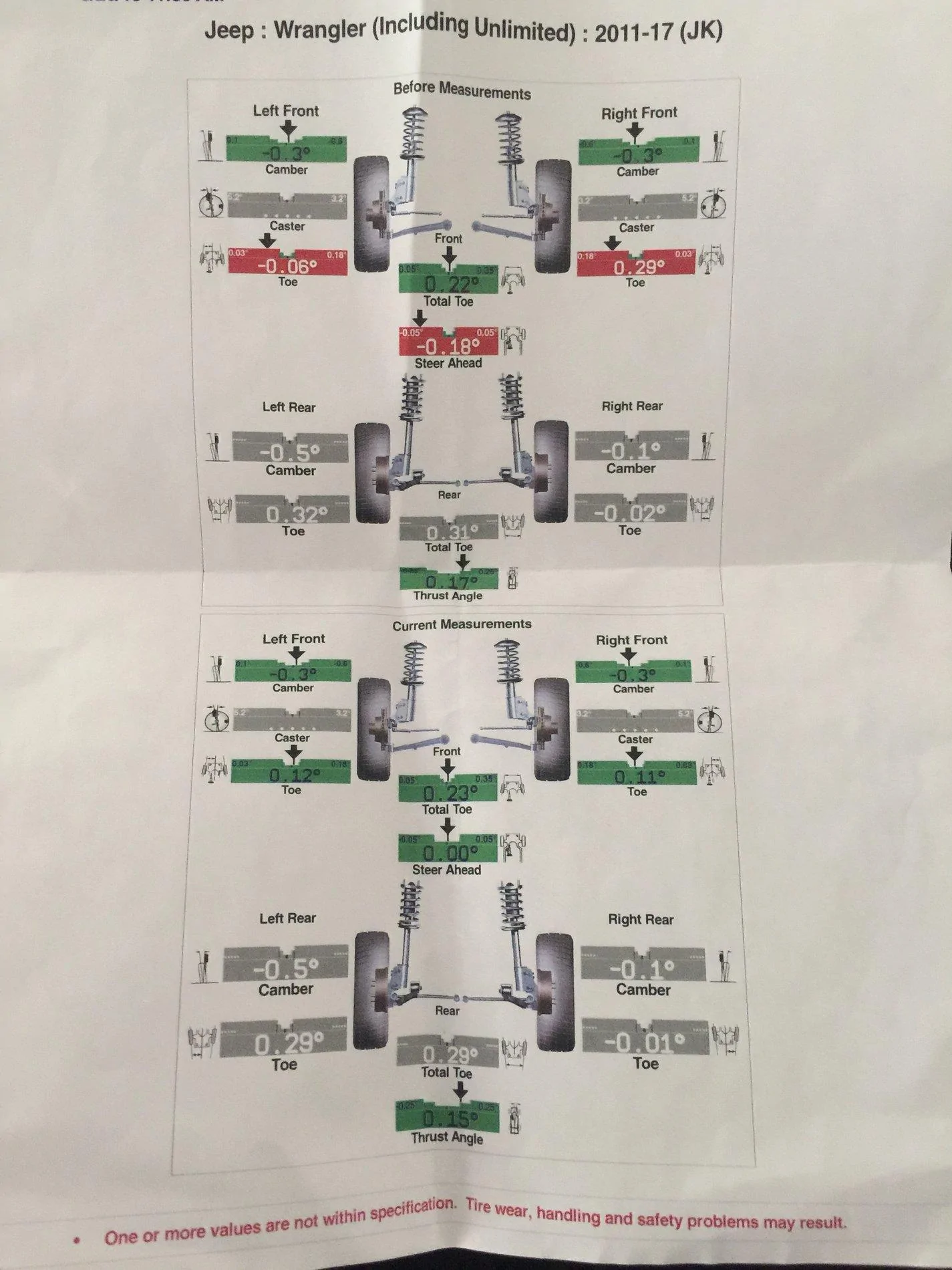

Tracking. Same problem here. Just picked it up yesterday in Florida, drove it back to Louisiana and fought it the whole way. I was thinking aftermarket steering stabilizers and upgraded sway bar to help with the pull and jarring? I’m gonna take mine to a local alignment shop and have them check it and see if they can straighten the steering wheel

Yo the answer is here to straighten the steering wheel. Just use the directions given in this thread to adjust the drag link. It’s mad easy yo.
