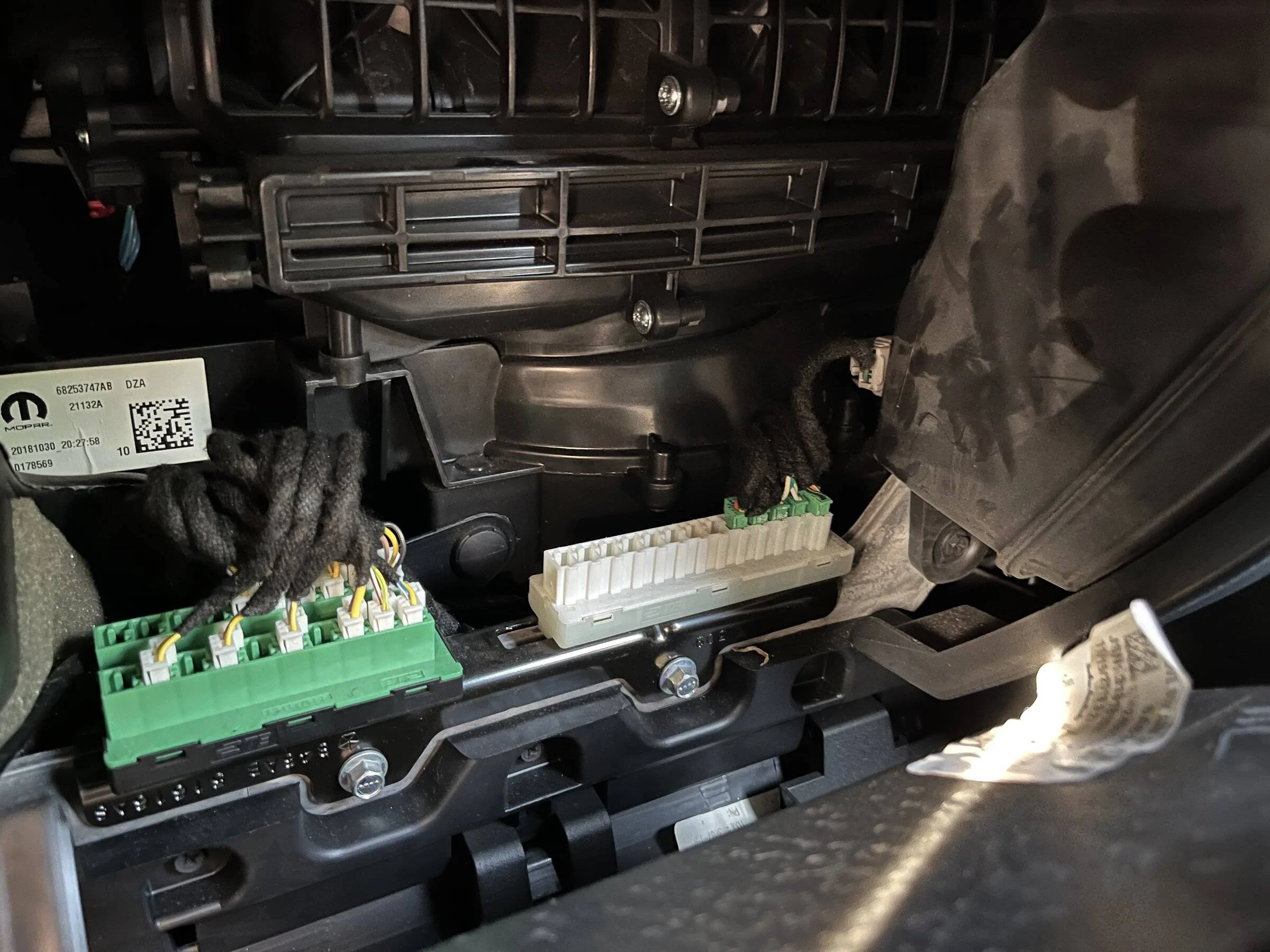

After reading various other “Service Shifter” threads, I took a look at the wiring harness behind the glove box.
When I touched or jiggled the white harness on the right, I was able to replicate the issue. I had the Jeep running and when I pushed on this harness everything went haywire.
Jeep Wrangler JL Electronics freakout while driving 74C2749B-3FCD-440F-B6A9-280BEBD57150
there is also a little white plug on the far right, which when I touched this the Jeep went above and beyond nuts and would not shut off. I jiggled it again and the alarms stopped and I was able to shut the Jeep off. Not sure of what consequence any of this is…

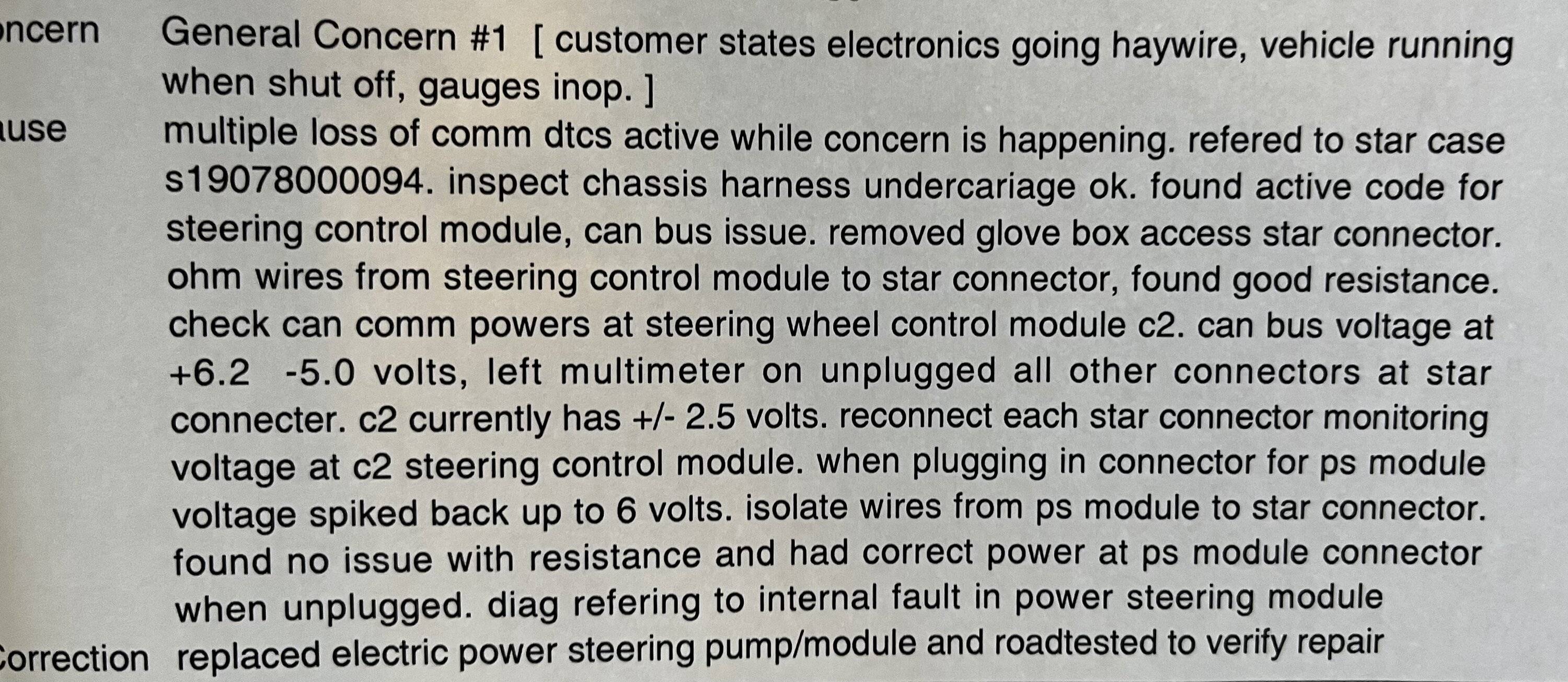

It appears that this 3 month long ordeal is finally over. I got the Jeep back today. It was ultimately traced back to the Steering Control Module, which was replaced and road tested for 2 days with no additional issues. I have the Star case I can post for reference. I’m hoping that this is finally the end of it!

This is the write up I have, referencing the star case. Taking it for a long business trip today, so we’ll see how it does.
