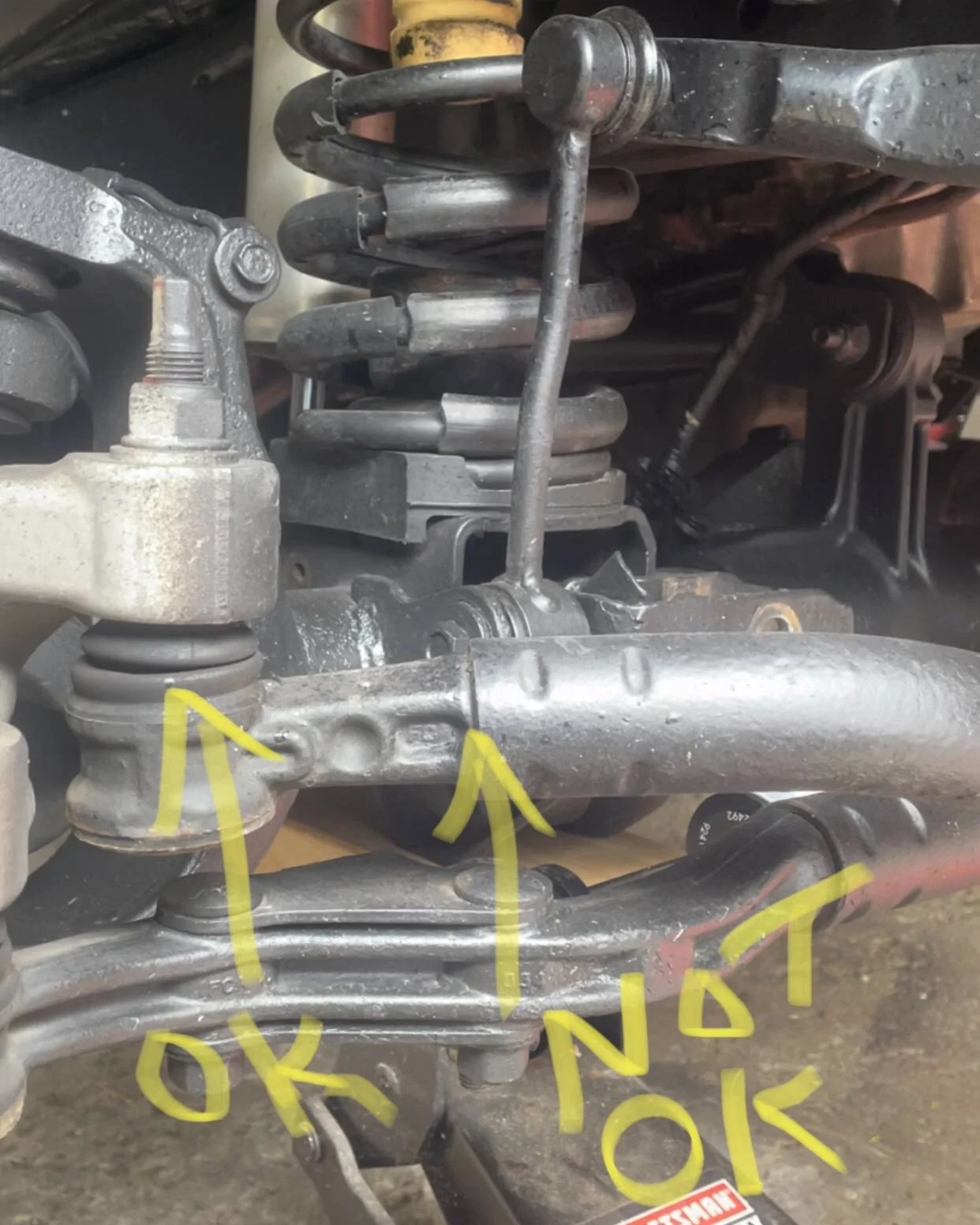

New track bar arrived today! In the process of installing it right now. Just checked the drag link and noticed a slight play as seen in the video below. Is this normal?
The movement of the joint is ok, they’re designed to rock back and forth, but I thought I saw some movement in the pressed joint. I don’t like that…..

Hard to tell on my screen, but that doesn't look good.
There’s no movement on the pressed joint. I just double checked and confirmed there is no movement other the slight up and down movement. I’m gonna drive over to the local dealer and check one of the JLs there to see if they have the same movement.

Just checked out 7 JLs. 5 of them had the same movement as my drag link while the other 2 did not move at all. I’m going to assume it’s normal, especially with @Roky’s word lol
Now here’s to waiting for a replacement track bar since the one arrived today was defective:facepalm:
It’s hard to tell from that angle. How much of that is slack in the joint? Rotation is normal.
