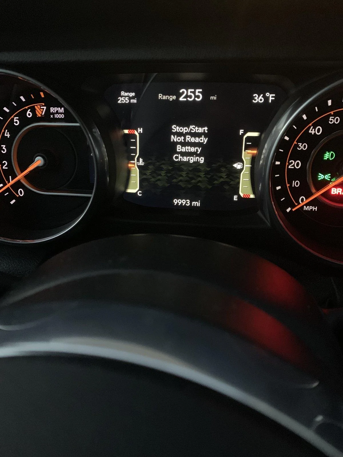

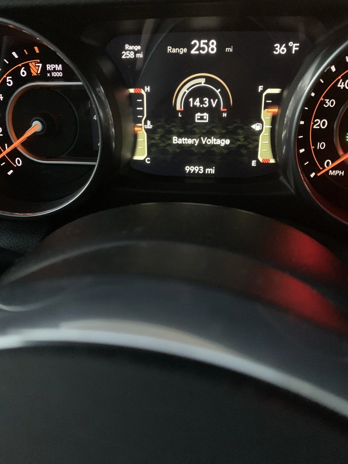

Good idea. I had a similar problem start about a month ago. I was getting the message: “Stop/Start Not Ready Battery Charging”. Battery voltage was showing between 14.0 and 14.4v. No other symptoms in the Jeep. Dealer discovered a loose ground plate, and a bad main battery. Replaced battery under warranty.
No other symptoms on the Jeep, but...I spent a ton of time last summer troubleshooting why my Dometic fridge wouldn’t run all night in a brand new Jeep like everyone else’s. Now I think I know why. Doh!!!
