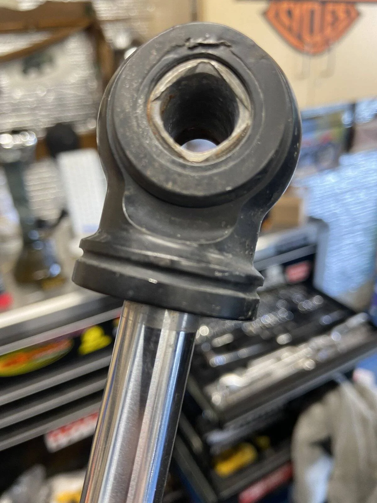

So here’s my similar experience and what I found to be the issue.
first off, my setup:
2021 JLUR Ecodiesel
Teraflex spacer lift with shock extensions
JT Rubicon Fox shocks
Fox stabilizer 2.0 Performance Series
Adjustable front and rear trac bars
37x12.50x17 on alum wheels
So after I went to 37’s this week I experienced exactly what the original post described. It was like DW was imminent but didn’t quite happen. I’ve rechecked anything I have installed and all seems tight and where I left it. I thought maybe caster angle, and even tho it isn’t suggested in the teraflex kit I looked into longer lower front control arms. I went with the mopar ones found in the 2.5” kit as they were cheap, avail overnight and there must be a reason why they use them in their kit so I figure why not. I stalled them, torqued to spec, and went for a drive. No joy. In fact, it almost felt worse.
I rechecked everything again and was leaning towards ball joints at this point as from what I read some people had issues in the earlier JL’s with them. But, for a quick test I decided to put my OEM steering stabilizer back on. Took it for the exact same drive and the problem was gone. No matter how hard I tried I could not produce the same wobble. Did my usual 100km commute to work this morning and zero issues.
So here’s what I found. When I was reinstalling the OEM stabilizer the steering side bracket had bent inward as the fox unit must have a shorter bushing and sleeve. I had to bend the bottom side down to get the OEM bushing and sleeve in and get the bolt through. Not a big deal and not the first time I’ve seen that with any kind of shock. The bigger issue tho was that the OEM bolt which fox says to reuse is a carriage bolt and the squared bit presses in to the fox sleeve and deforms it a bit (pic below). I figure this is where the problem lies. It’s either that or the heim joint at the axle side bracket is shot but it doesn’t appear to be, it pivots as it should and by hand I can’t get any side to side movement. The stabilizer itself seems fine, it takes some serious force to move it in and out by hand where the OEM one is easier to do. This fox unit came to me used, but maybe a year old.
I contacted fox tech support and while they are puzzled by the carriage bolt doing what it did, they still consider bushings “wear items” and would not warranty them. I have the part numbers for the bushing, sleeve and heim and have them on order, they were like $9/each for the bushing and sleeve and $40 for the heim so not a huge deal.
Anyhow, thought I’d share.
2021 JLUR Ecodiesel

There has been a few instances where the stock stabilizer corrected the issues. MC has actually taken theirs off the site and recommended using the factory one. I honestly don’t think the stabilizer was moving at all, I think there is some harmonics in the Jl and the dampening force needs to be “just right” too much and it causes issues and too little does.
Interesting. I’ll have to see how this plays out after I replace the parts on the Fox unit I have. The sleeve is definitely deformed a bit though.
