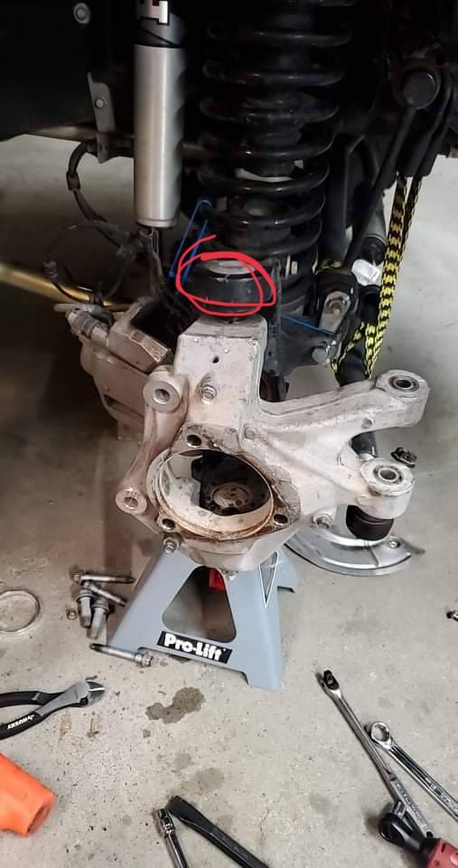

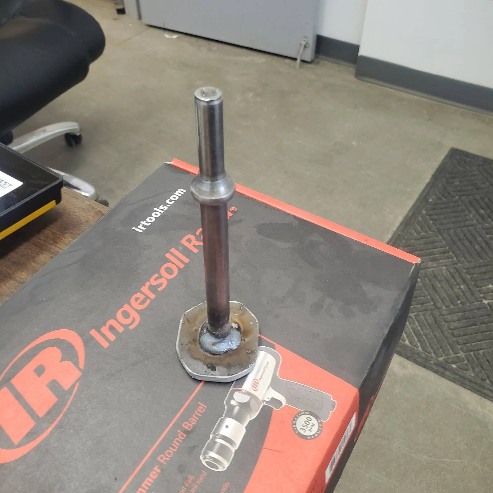

Well I started to disassemble the front axle to prepare for my new Dynatrac ball joints which should be here tomorrow. But this is turning out to be a bigger headache than I expected.
First the brake rotor wouldn't come off. Second, the unibearing didn't want to budge either. Now I'm fighting the knuckle and it's being a bitch. PB blaster and heat didn't work. A dead blow hammer about 10,000 times hasn't worked. Now I'm going to try an air hammer with a blunt tip. My only concern is using an air hammer on aluminum knuckles.
Anyone here any other suggestions?
Pickle fork?

After a few more cuss words, and some threats to trade in my Jeep for a new Ford Bronco, the knuckle came off. The driver side came apart a lot easier and only took me maybe 20/30 minutes to have it all apart.
I'll have to take some videos of my old ball joints but there is no vertical movement in them, however they do move extremely easy side to side. If it wasn't for the rubber boot recentering the stud, at least 2 of them would flop all over the place.
The new Dynatrac ball joints are STIFF. They DO NOT move at all. As stiff as they are, I think they even helped tighten up the steering some, although I didn't have any loose steering before there is some improvement.
But.... in the end the Dynatrac ball joints appear to have done the trick. Everytime I make a change on the Jeep, I drive the same 5-6 mile route around town so I can assess if the changes made a difference. Besides a tiny bit of bump steer, the wobble/shimmy that I've been experiencing for the last 12k miles seems to be gone. Which means my ball joints were bad with only 10k miles on the Jeep in 2020 when I installed the lift and tires.
