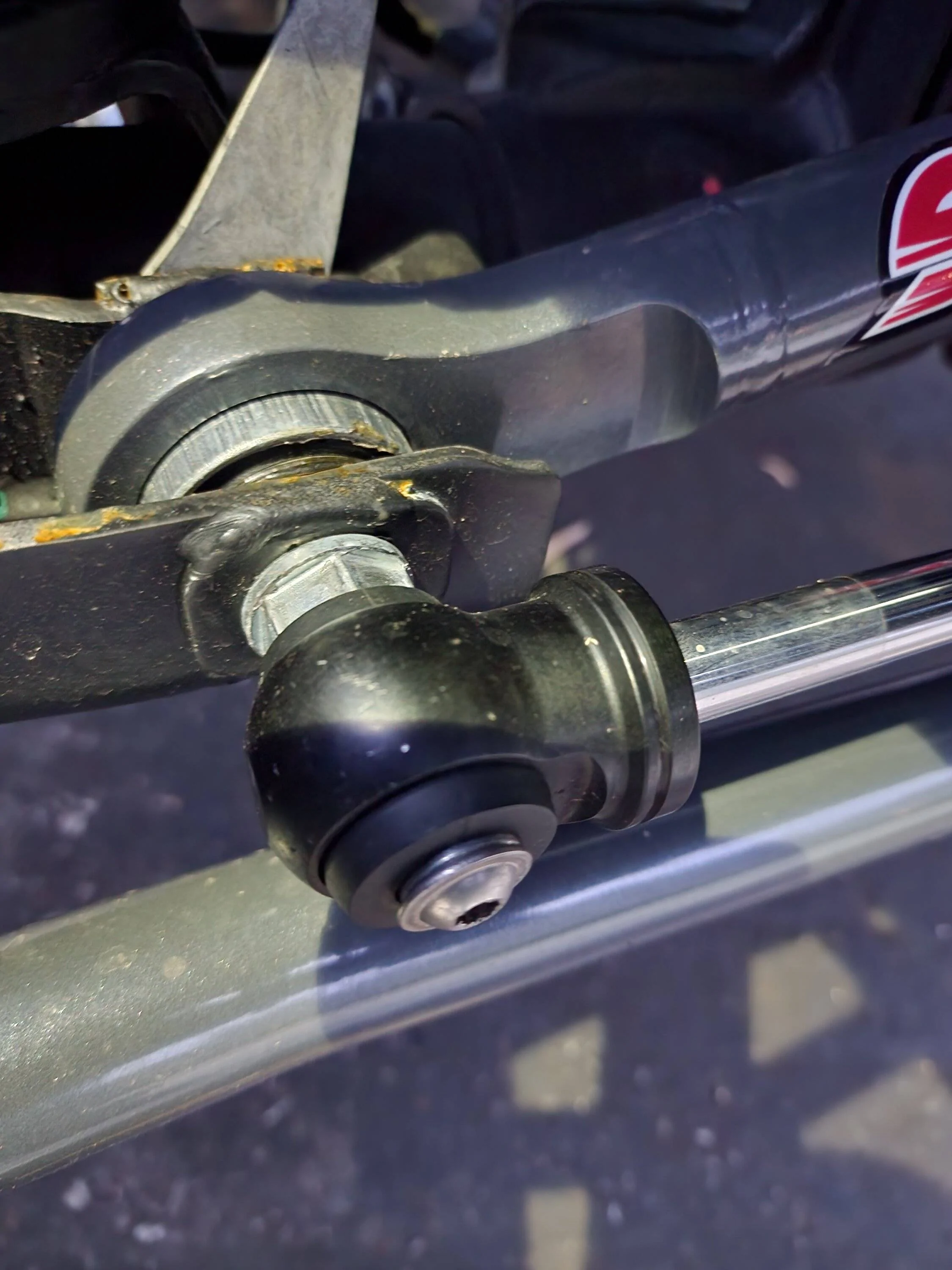

UPDATE: I found a significant amount of play in the knuckle end of the drag link. Could this be causing my issue? I can physically grab the drag link and feel and hear play in the joint.
The tie rod and draglink are ball joints, its normal for them to rotate back and forth and circular. it would be bad, IF you can move it up and down on the ball, or if you turn the steering back and forth and can see the steering moving and not moving the knuckle.

UPDATE: DW is GONE! (Fingers crossed). Here was my process of diagnosing/fixing:
1) Tire Rotation/ Road-force balance & Alignment. (worked for a bit, but came back within a couple weeks)
2) Replaced track bar with aftermarket one and re-torqued all suspension bolts related to the front suspension with Jeep on the ground. (felt better overall, but DW still present over specific types of bumps)
3) Replaced ball joints with Teraflex HD ball joints, installed Teraflex/Falcon adjustable steering stabilizer, and longer sway bar endlinks (to compensate for lift)-- DW GONE! Not sure which one of these had the biggest impact, but I would agree with others that it's the ball joints. The stock ball joints felt like noodles compared to the Teraflex ones.
