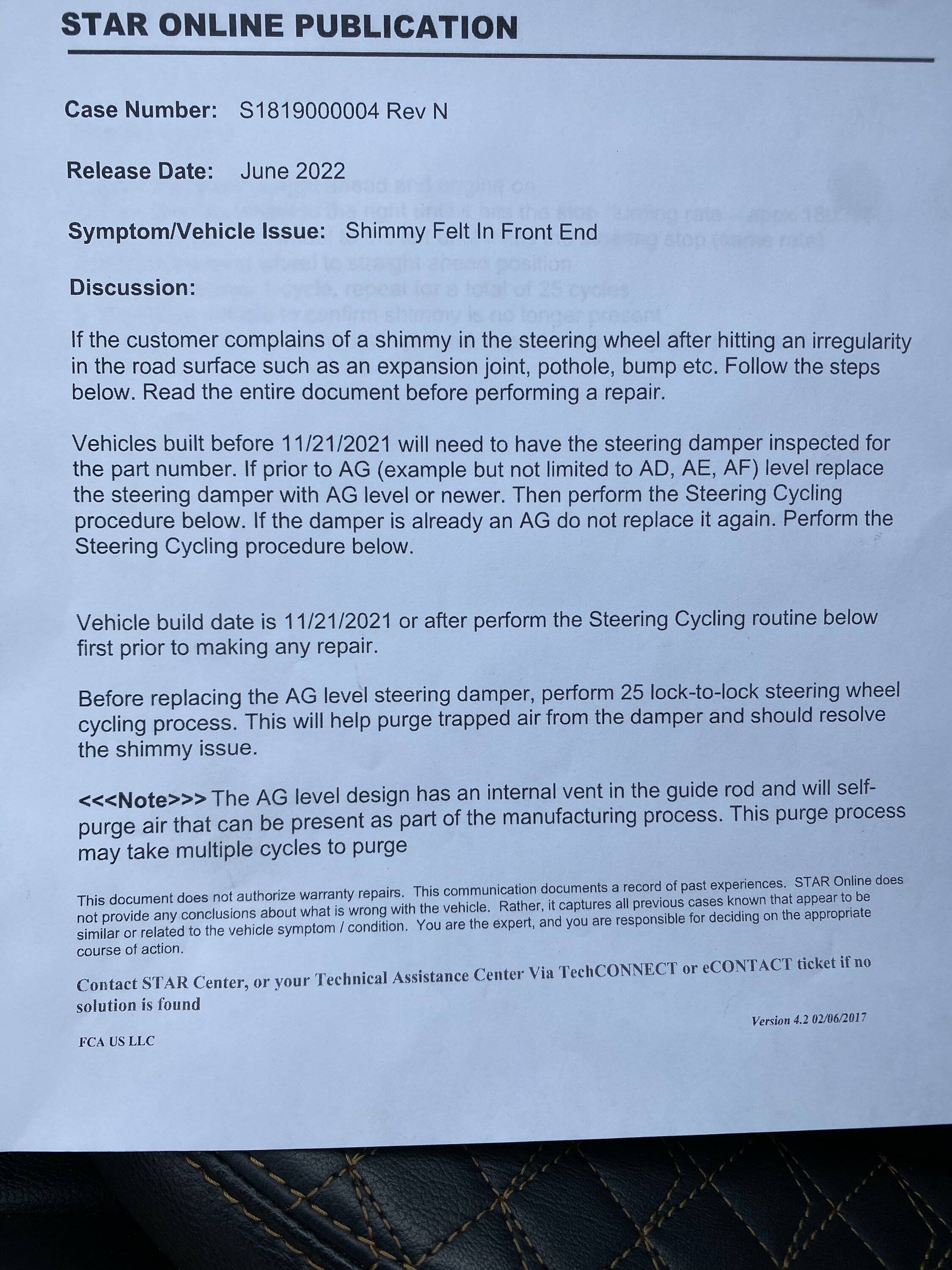

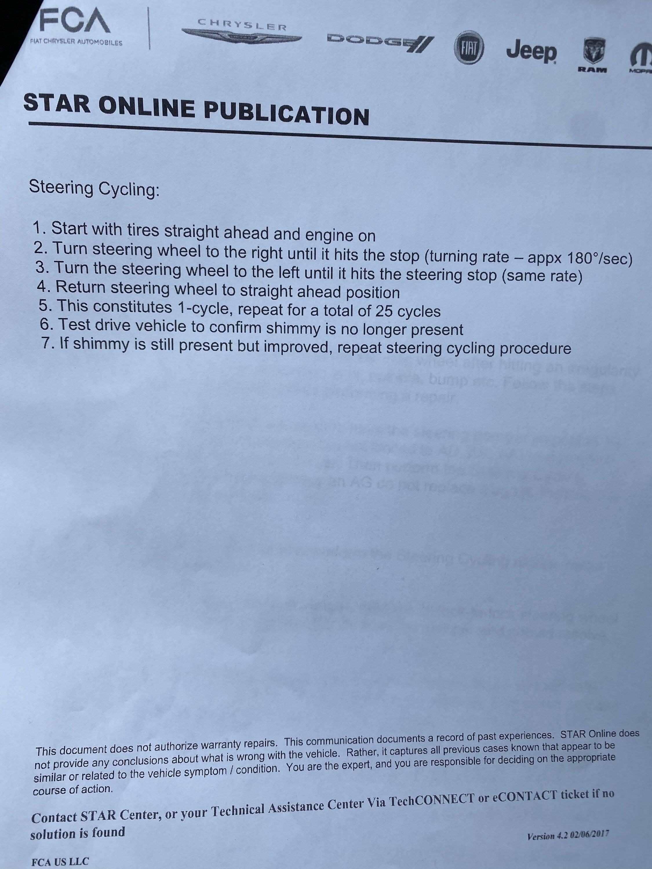

... Should have realized that everyone here is correct in that it’s never the stabilizer ...
Just FYI, in my case it was. Totally different setup than you tho, completely stock JLUSS.
I started getting moderate death wobble at diagonal bridge expansion joints when it dropped below freezing.
Someone here posted this. I scoffed at it, but tried it anyway. Totally fixed it for me, but again a lot less mass on mine to flop around.

Thanks. I knew about that and tried it. The AG damper has an up-down fore-aft sticker on it and a revised collar and bolt to make sure that it is not installed upside down. With the extra weight of the 37's and the offset of the wheels, it has probably increased the wear on the ball joints. Plastic bushings in the OEM joints probably doesn't help either.
