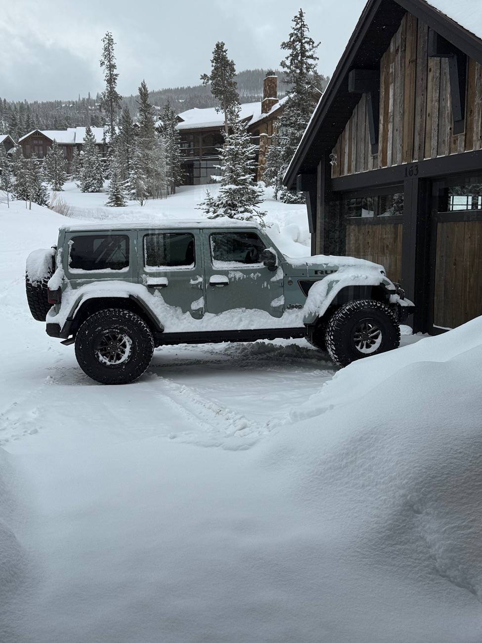

Just an additional comment. I have been driving 4x4 vehicles in and around Colorado since the 80's. I agree with alot of what has already been said. 4 wheel drive is great for going forward in snowy conditions, but you have to know how to slow down and stop. In 4 high the extra axle turning does help in deceleration, not stopping. Anyways.
Finally spent a good week over the Holidays on the MT Baja Boss A/T tires with 3 feet of snow in the mountains in a week (Not Tahoe or Big Bear dump, but big for Summit County). I drove in every condition from side road axle deep to 3-6 inch on side roads and heavy snow/ slush on main roads. The Mickey Thompsons were awesome. The 392 4High Auto does take some getting used to, but handles most mixed conditions well. Did use 4High Part-time several times and that is the feeling I am used to from my previous Jeep JKU Rubicon/X.
The MT Baja Boss A/T are snow rated:
  • Severe Snow Service Rated with the 3PMS Symbol certifies that all sizes 12.50 (315) and narrower are severe snow rated
  • The 37's are 12.5 wide and have the 3PMS Symbol
