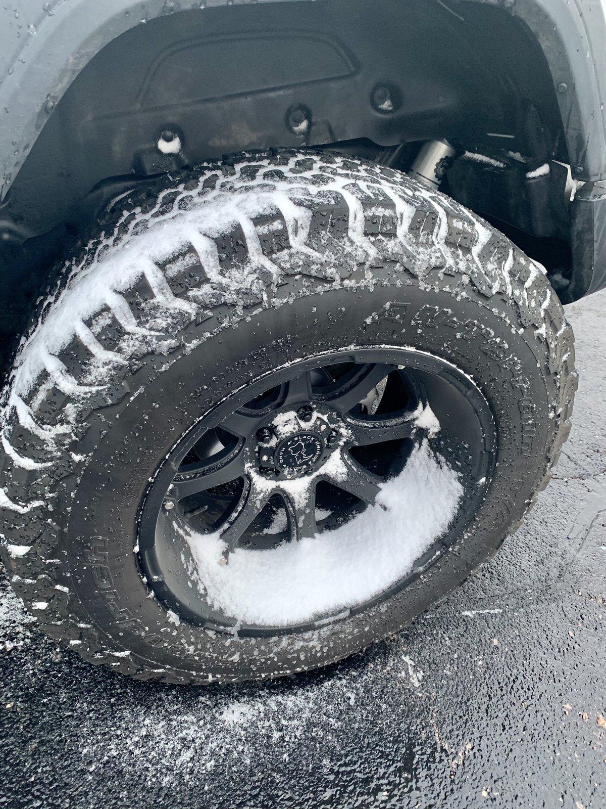

Which tire are you running?
In my experience, tire brand/type matters more than width. I've run some that were downright scary and wanted to hydroplane in a heartbeat, and others that are rock solid in foul weather.
Tires like the BFG KO2, General ATX, etc. that don't have circumferential channels to allow water to evacuate quickly are particularly bad. Tires with higher voids and open channels that can push water out fast tend to stay planted on the road better, especially if they have siping.
Yep the KO2s, thanks for the info jeepers!

When driving in the snow today hit some slushy spots and Jeep started to float on top of slush to one direction. Is this normal for wider tires mine being 35s 12.50. Bit scary was going same speed as everyone else. First Jeep here..
Yes indeed.. For snow, you'd really want to have narrow tires, believe it or not. The same could be said, to a lesser degree, for water on the highway when dealing with hydroplaning, though weight can overcome that to some degree better on water, vs snow.
