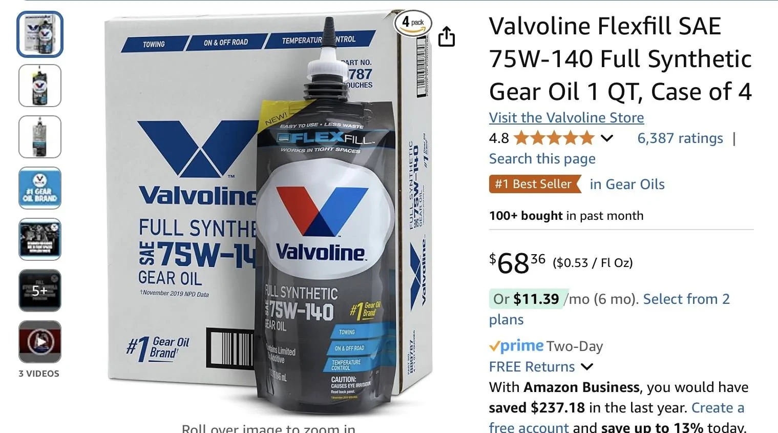

75w140 GL-5 for front and rear on my JLUR D44s.

Just use 75/140 for both. Makes buuing gear oil easier and is what Dana (not Jeep) reccomends for the axles. You might see a 1% drop in fuel ecoomy, but I'll take the manufacturers advice.
I will add, when I did my first gear oil change at 40k the origional fluid was black and a bit stinky. Just chsnged again after 80k miles and it looked brand new
