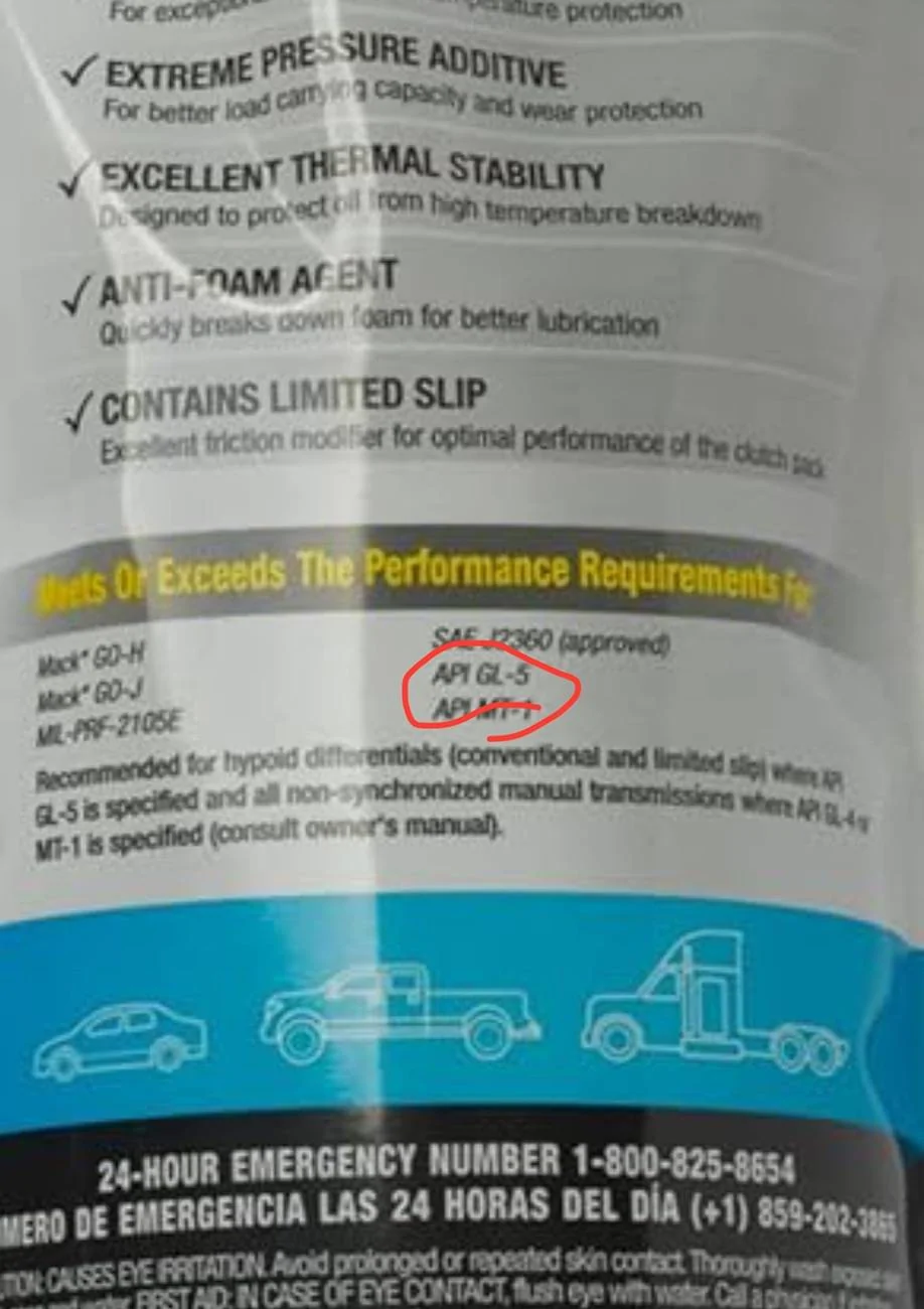

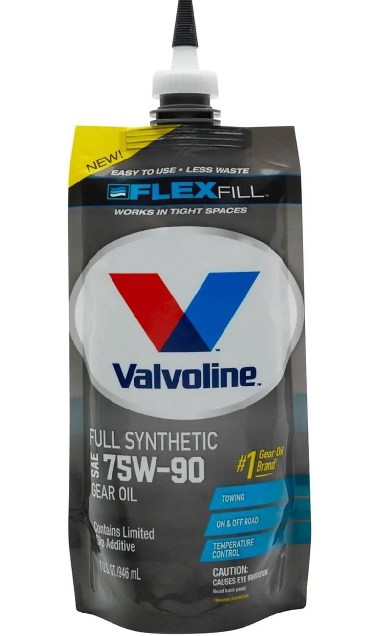

Would this work in rubicon?
https://a.co/d/cuzQONi
My owners manual says:
Front diff 75W85 GL5
Rear M200 75W140 GL 5
Rear M220 75W85 GL 5
My Rubi came with M220 rear diff. I would use the Valvoline show as long as it is listed as GL 5.
Along with discussion of motor oil, tires, etc., there will be others that disagree but I would use the 75W90.
Edit; I would use a synthetic 75W90 from Mobil 1 or Pennzoil, etc. in addition to the Valvoline.
