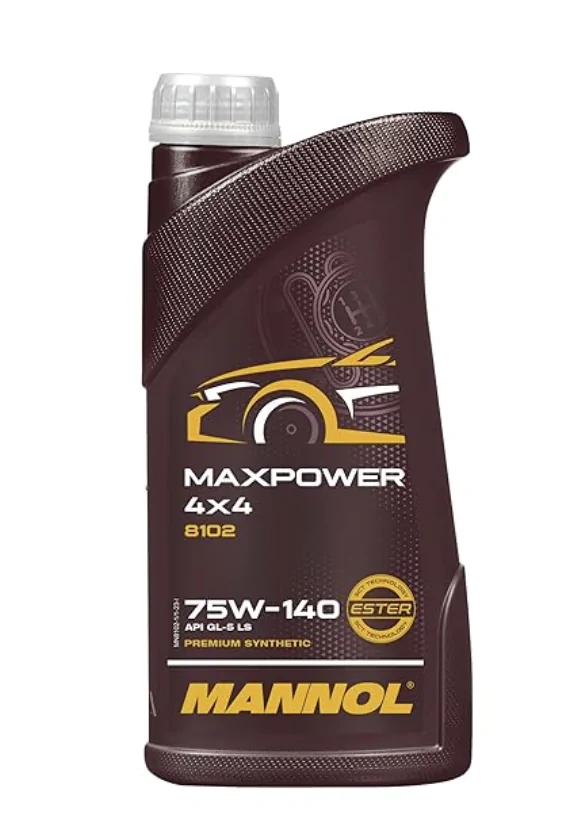

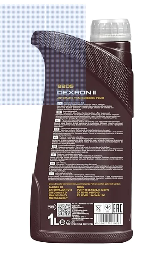

Planning to do the diffs on new to me Rubicon 2022 4 door. here in India I am getting Mannol 75w-140 synthetic. attaching a picture. just wanted to know if this is ok?
Jeep Wrangler JL Differential Oil Screenshot 2025-12-16 at 8.17.52 AM
Jeep Wrangler JL Differential Oil Screenshot 2025-12-16 at 8.18.00 AM
@virkdoc
You have a Rubi, so you do not need.... you would not need to use additive.. but, do know, there is no problem using a gear oil in your Rubi that already has additive in it. I'm unclear if this product actually has an additive though they hint at it..
So, yes, it would be aok to use.... DO use 75/140 in both front and rear differentials. DO have 4 bottles on hand before you proceed with the deed.

@virkdoc
I couldn't find any reference to limited slip additive on their webpage.
MANNOL Maxpower 75W-140 GL-5
@roaniecowpony
I read this in the product description... "specially designed for the lubrication of all types of differentials, including excessive friction differentials where the oil "Limited Slip Oil API GL5” is required. It was developed for hypoid, bevel and spiral gears."
Sounds like it has.... but....
Regardless, the Rubi does not need additive and the OP has a Rubi so the point is moot.

Thank you. We have to go in to change a sensor which is causing my rear diff lock light to keep flashing. i read across the forums about changing the sensor. So will do front and back diffs together.
