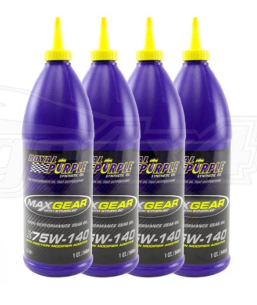

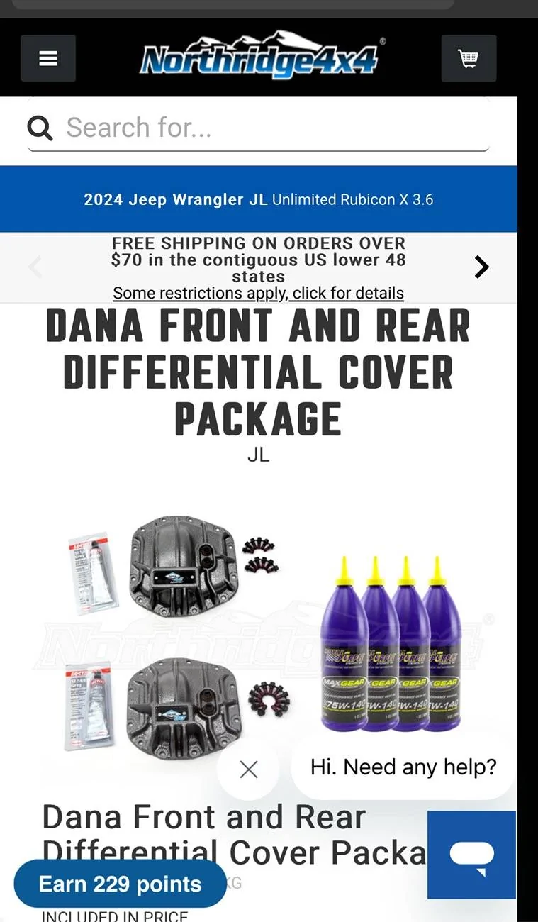

Interesting northridge sells the Dana diff covers with royal purple 75w140

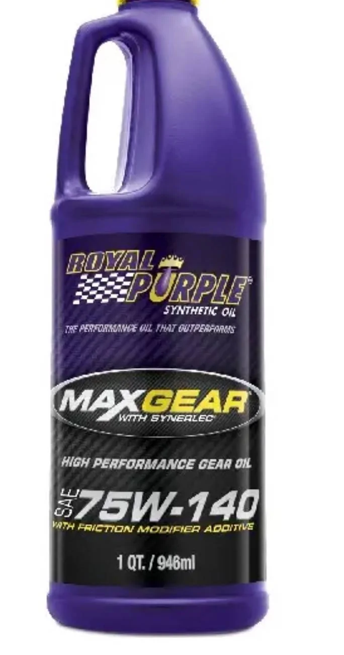

this is whats in my axles. royal purple 75-140

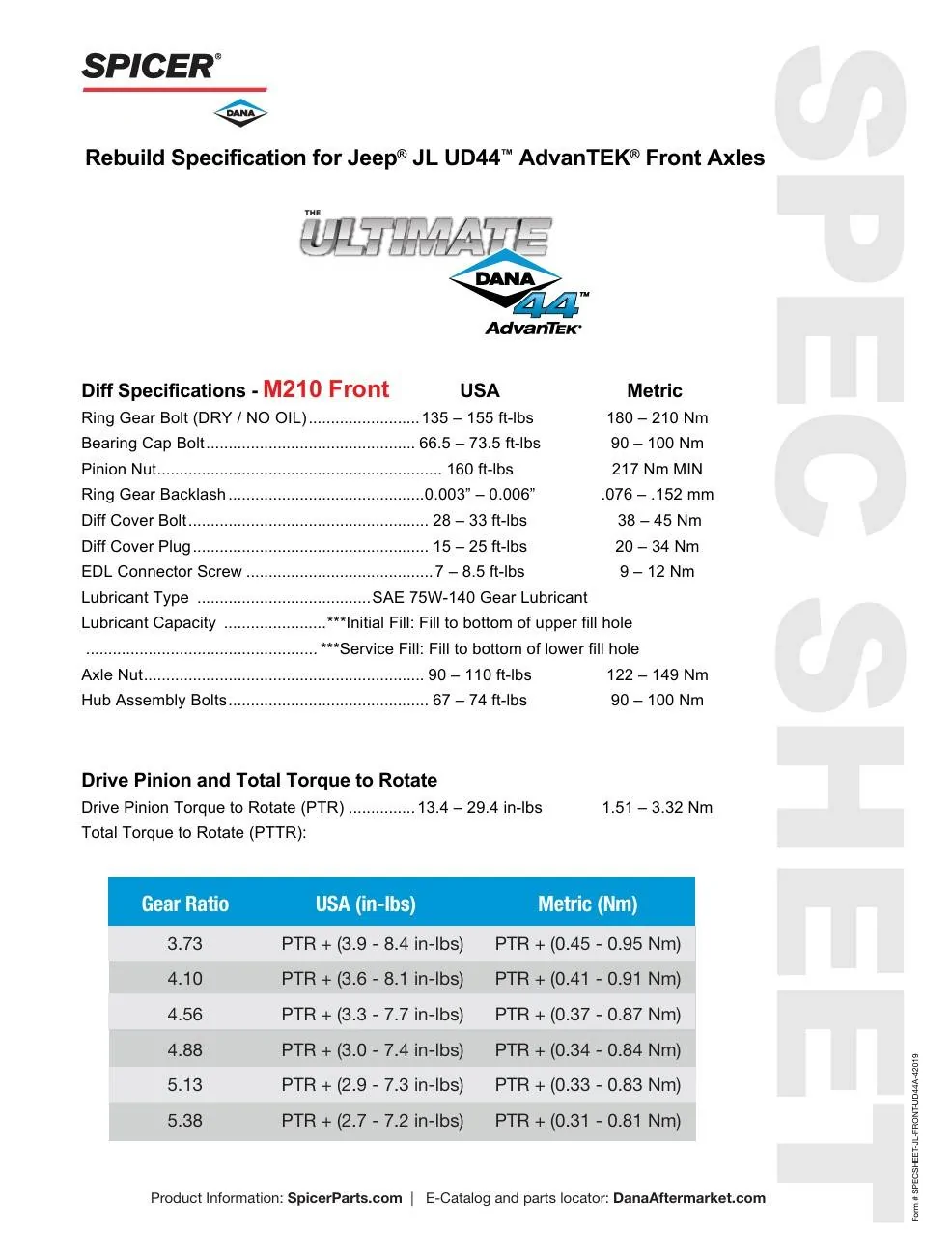

When you install tires not equipped by Jeep and/or use it in extreme conditions, you are subjecting your axles to conditions beyond what Jeep tested when they selected and evaluated the gear oil.
Dana selected and evaluated gear oil to perform at the maximum stresses they rate their axles for.
Choose what you like.

The thighs clearance argument is not holding on that one ;)
On the other end: the engineer know best may stick lol

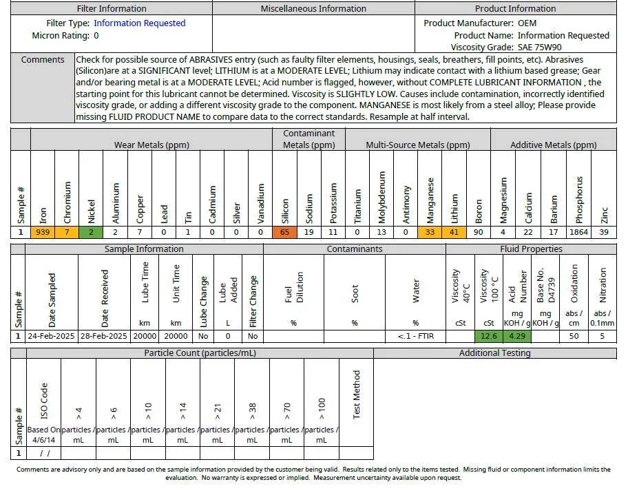

the oil was dark also on my side at 12k miles. Iron was at 939 but this is the factory fill so expected. Lab instructed to continue running the oil.
Since this is factory fill I will replace soon, already go the oil just wait for a warmer temperature.

can you post the other results on the analysis? thanks

There's zero arguing those statements. 😉👍
