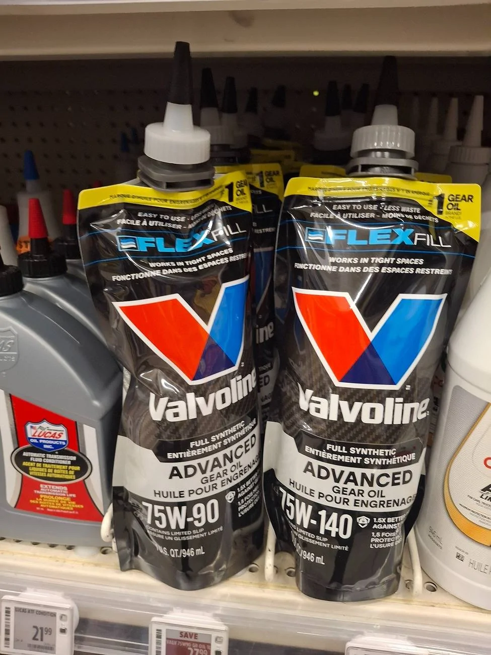

Just changed both front and rear 3 weeks ago, went with the Valvoline. Found the bags easier to use vs bottled Lucas I used a decade ago when I changed it in my old TJ....

There is thread somewhere on this forum that goes pages after pages talking about this. I will be putting -140 on both diffs, that spec comes from Dana. Same Valvoline one, easier to pour
I remember those days. When I saw they started doing the bag I wondered why it took so long to come up with that. It’s a SMH thing for sure. lol
