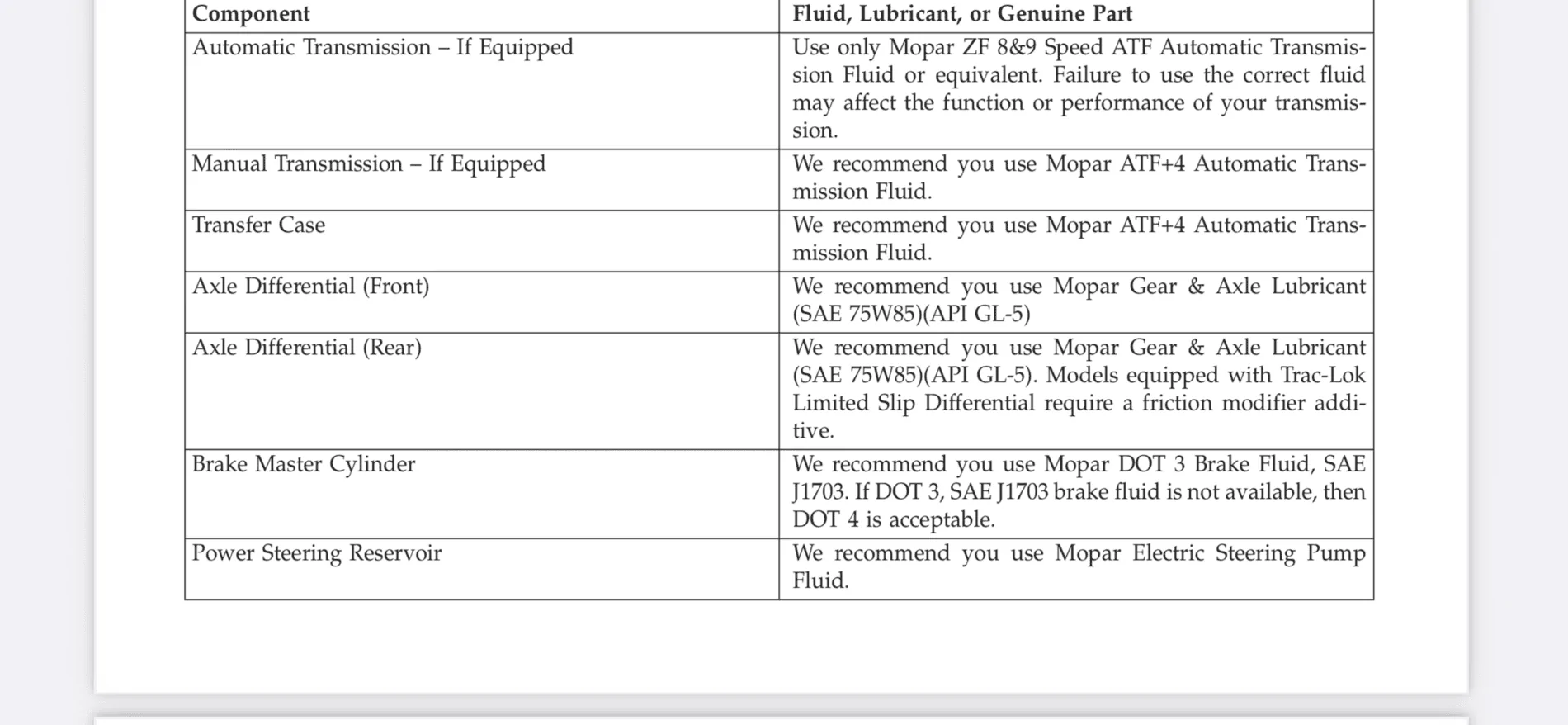

I’ve struggled with this as well. When I did mine I used 75w-90, as my manual doesn’t indicate to use anything but 75w-85. I have the M200 and tow a small utility trailer from time to time. I might try 140 next time, which is going to be sooner than later as I submerged my differentials a couple times last weekend. Attached is a snippet from my manual on my 2018 Sport.

That’s interesting. They must’ve added the use 75w-140 on the M200 in 2019 an up. Btw, based off of certain manuals posted don’t forget to use a low ash oil in your 2.2 Diesel engine if you have one.

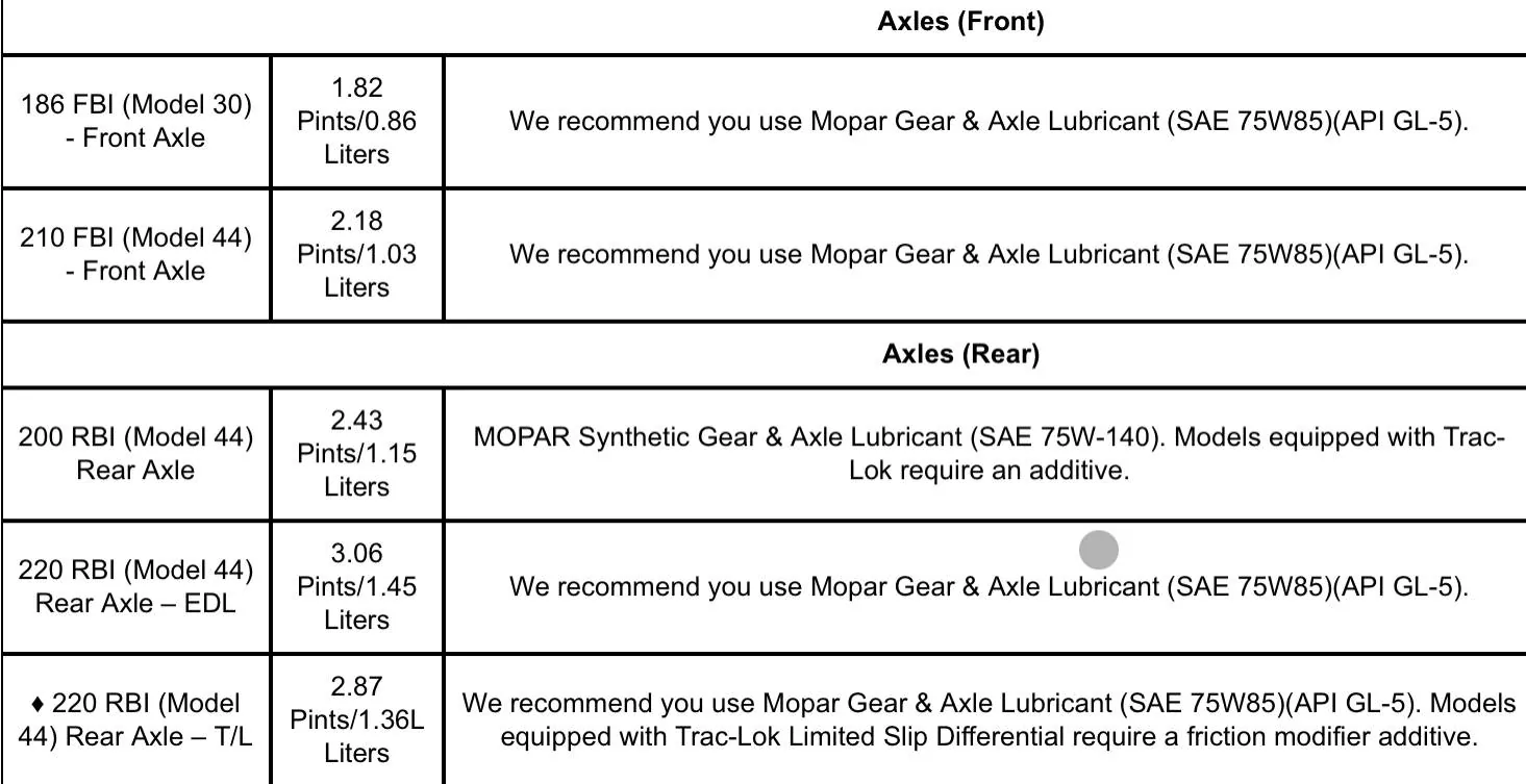

So heres what I went off for mine. This is straight from the dealer, easy enough to figure out what to use. I have 30/35 and used 75w-140 in the rear. Hope this can be of help.

Crap, I looked at that manual again that was sent to me. I’m using 87 octane in my Jeep. Am I supposed to use the (NAFTA) fuel selection of 87 Octane or the (Export) 91 RON?
