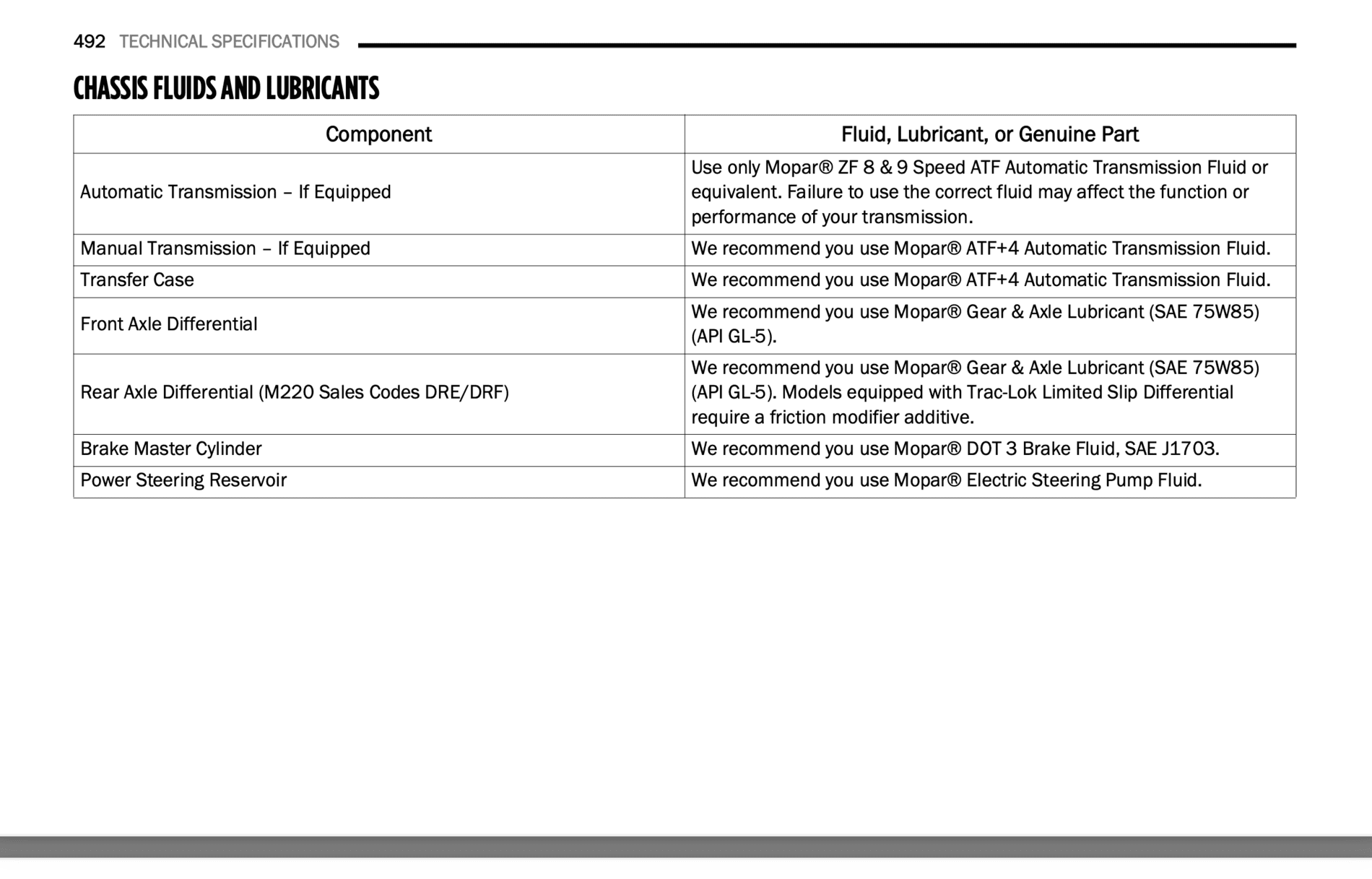

I'd love to see what the Gladiator's manual says, since it has a higher tow rating.
Here is a 21 Gladiator owner manual.

PS, why don’t you look at what Dana recommends for the 220. I’ll give you a hint…
Link? I can't seem to find it. But unconstrained by Cafe, I'd bet 75w140 for towing and 75w90 for light duty.

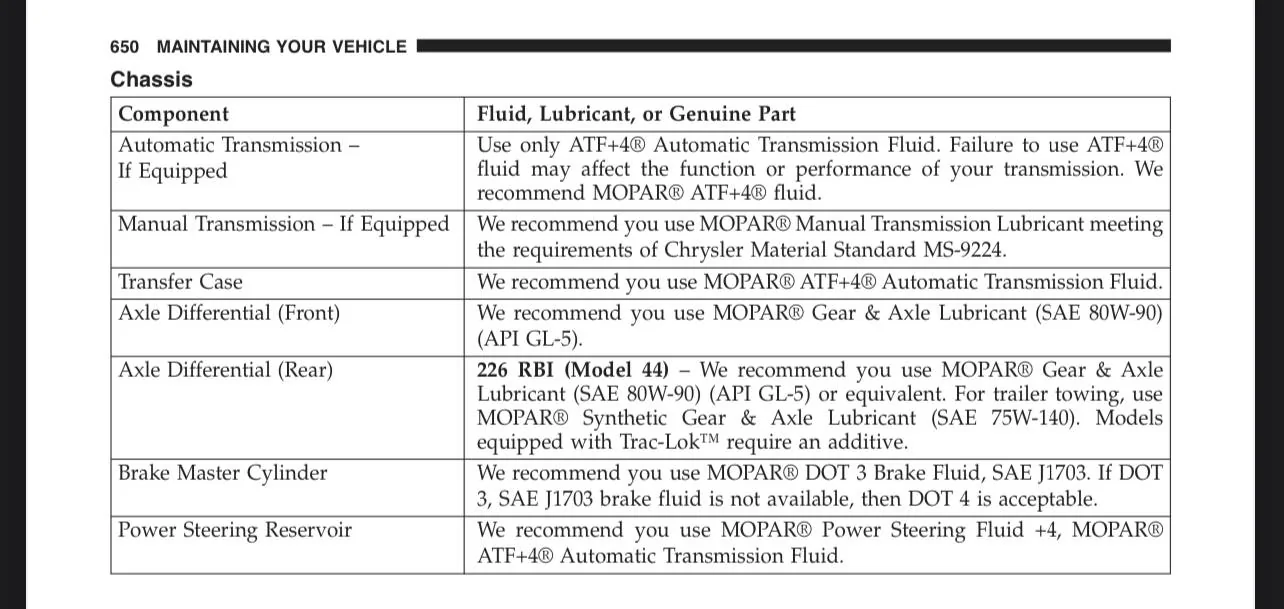

While it doesn’t on say it in my JL manual.
The Manual on my 15 JK rubicon 2 door did recommend 75w140 when towing . I REALLY DO NOT THINK the axles are made out of different materials LOL. I’m running 37s and it’s hot as balls were i live so I will be switching to 75w140 like I did with my JK. Never had any issues
now you can decide on your own why they’d recommend a thinner weight oil. Remember the v6 on the jk was once 5w30 then 5w20 and now we’re at 0w20 on the same engine ????

Thanks! And there it is. 75w140 all the way, not even a mention of anything else. To my knowledge, all 75w140 is synthetic, too.
With the heat generated by these axles as compared to other axles of the same size and with the reduced oil capacity of these axles versus the previous generations it makes little (read that no) sense to run anything less than 75W-140 in them. Fuel economy and axle longevity do not go hand In hand.
PS...75W-140 is synthetic. I have never seen a conventional version of it in the wild.
