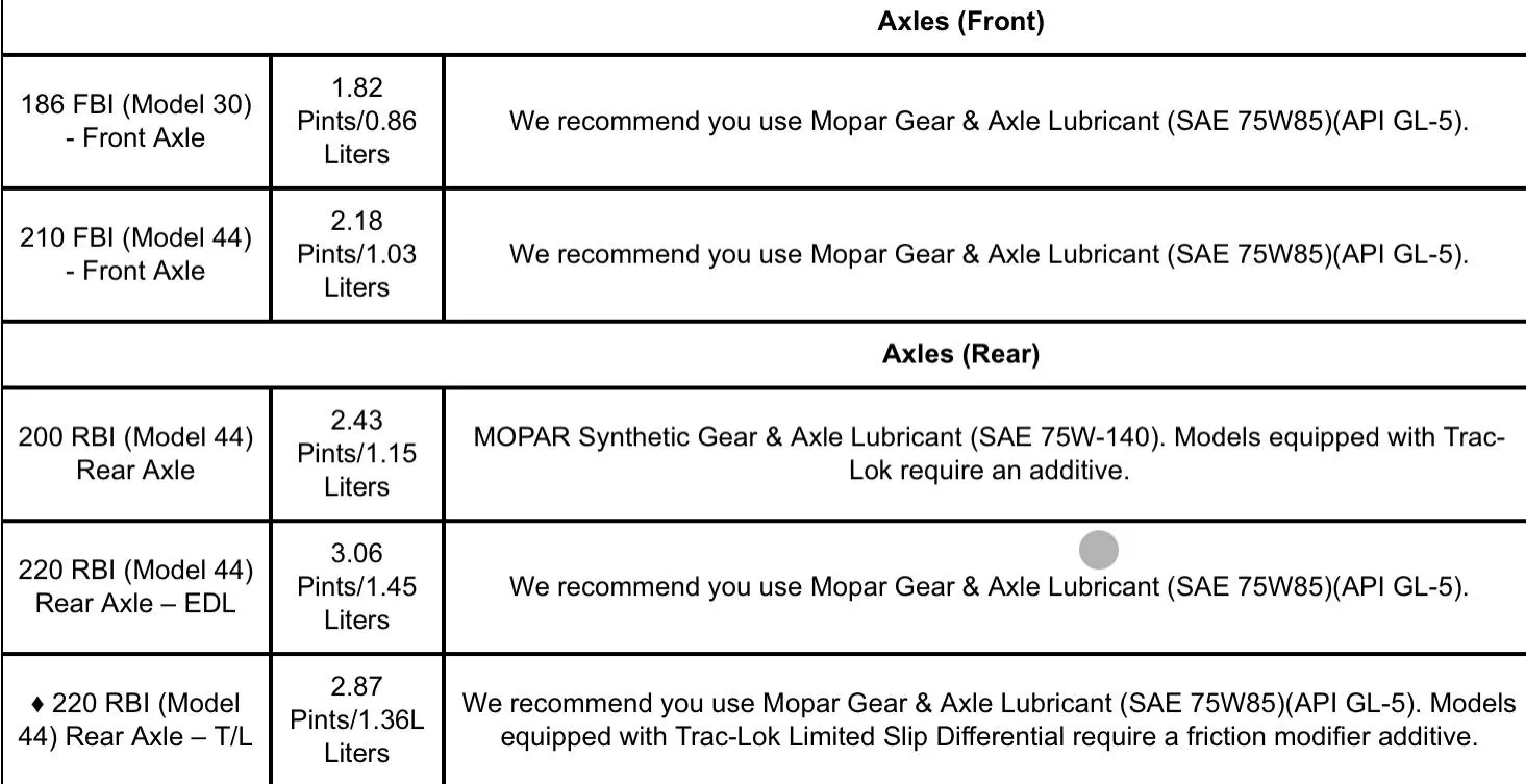

So the information I’m looking at isn’t in a manual, its in a database. This is Stellantis Jeep information. These are the specs I went by, this is not from the manual i repeat. My car manual doesnt show this info.

So, again not being an ass. I’m sure plenty of eye rolls happening. Not trying to fight with anyone even though it looks like I am. One guy ticked me off telling to kiss his ass for no reason. I Haven’t called anyone names. I’ve read all the owner manuals now from 17-21 and only the JK manual says to do that?

And it doesn’t say to 75w-140 if towing. Unless I missed it somewhere. It only says to use it on Dana 35’s.

Not sure what youre getting at? I understand its frustrating, but ive provided for you Stellantis data, if thats not good enough, I’m not sure anything ever will be, and thats not being a jerk, thats just the truth. People in these forums want to share their opinions but sometime too real hard data is being shared, like what i posted. My data is for the JL models.
I never said to use it for towing. It is true though that that weight is better for towing, as easier on the diff. But if youre an OEM guy and you trust the research that Jeep did and thats what you want to follow, then thats what you should follow. There’s nothing wrong with That. I would use what it says you should use int that photo, if thats what you’re comfortable with.

If anybody wants to use 75w-140 any any model of diff they have they can. The point is that saying to use it if you tow is misinformation. You should use it because based off of your own research and opinion it is what you feel is best for your Jeep. Me personally will do what the Jeep service manual says that was just posted.

I agree, i think you should use OEM if thats what you want to use
On the other hand, i did my research and chose to go with the 140 weight oil for towing. NOT because the dealer says to, but because based on my research I chose to.
