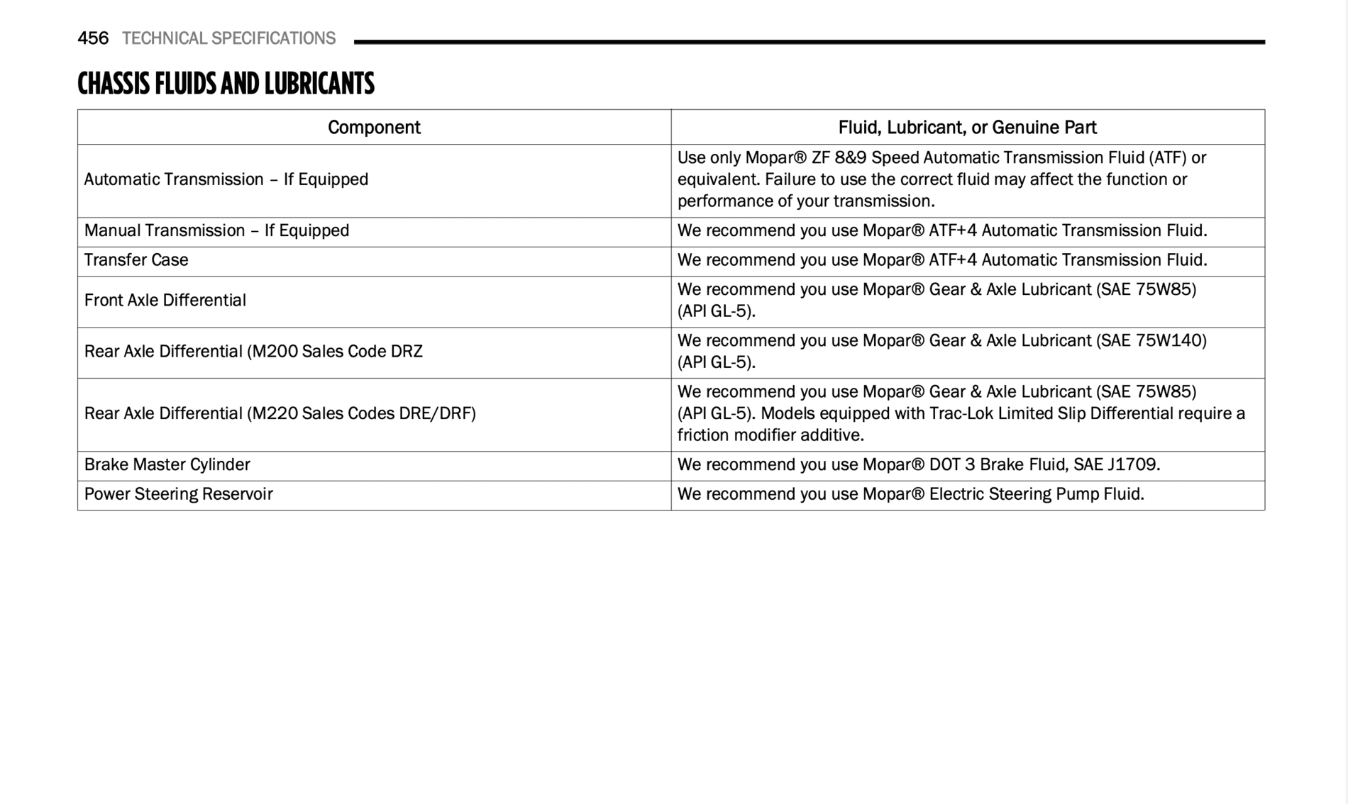

Okay, so I have read almost every post on this thread. I have a 19 Rubicon. The manual states 75w-85 for front and rear. I have read several people say if it has a tow pkg to do 75w-140. No where in my manual does it say to add that if you are towing. Please show me where it says that or explain why you are using thicker fluid that is not recommended? My point is I have put 75w-85 in front and rear on both of my services. What is wrong with using that 75w-85 in rear like the manual says?

Off road use. Going to Moab in Octobe, and no towing. No where in my manual does it say that. Must have amended in for 20 or 21 models.

So, I checked the manual on a 2021 Wrangler, and it says the same thing. What am I missing. Not trying to be an ass. I'm keeping this Jeep forever. She's my baby. Hell I even tell her goodnight before I go to bed. I want to do what's best for the vehicle. So, I'm just curious why I would use something besides what manual says? Someone posted a manual a minute ago, and it got deleted. Not sure it was for a Wrangler though. It showed specs for a 2.2 engine, and Wrangler doesn't have 2.2 Diesel, at least not in US. I think that manual is for the U.K. version.
Nothing wrong if not towing.
Thank you. Why put the 75W-140 if towing? It doesn't say to. I know we all have things we do that others don't. Hell, I still change my oil every 3,000 miles. Everyone says I'm nuts, but I still do it. I'm fixing to change my front and rear diff oil next week. If doing the75w-140 is advantageous I'll put that in.

As per factory service manual page 539 JL Wrangler: We recommend you use Mopar Gear & Axle Lubricant (SAE 75W140)(API GL-5). It is unto you to decide. The reality is it's not going to make a bit of difference.
That's only for the M200 rear diff which is the Dana 35. I have the 44.

that manual is for U.K. Jeeps. That’s why it shows a 2.2 Diesel. The Manual pics I’m posting are US. No where in the US manual does it say use 75w-140 for the Rubicon Dana 44. Only for the M200/Dana 35 does it say use it. I’ve looked at all the US manuals from 18-21 and no of them say that. I’m not saying 75w-140 is good or bad. I’m just wanting to use the best fluid for long life, and I’m assuming what they put in the manual is that. They test vehicles with fluids and want you to use what’s going to save them warranty repairs. If 80w-150 was the best they would’ve put it in my manual. Maybe in the UK something is different.
