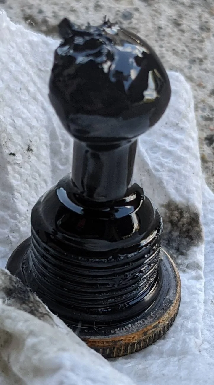

Back to the rear.....there were A LOT of iron shavings on the magnets. With the ARB cover, there is a drain plug with a VERY powerful magnet, along with the stock drain plug and its magnet. Here are the pics.....
Stock plug:
Jeep Wrangler JL Differential oil change PXL_20210829_213318069
And ARB plug..... It is not ball shaped. That's just a ball of iron shavings!
Jeep Wrangler JL Differential oil change PXL_20210829_214349424

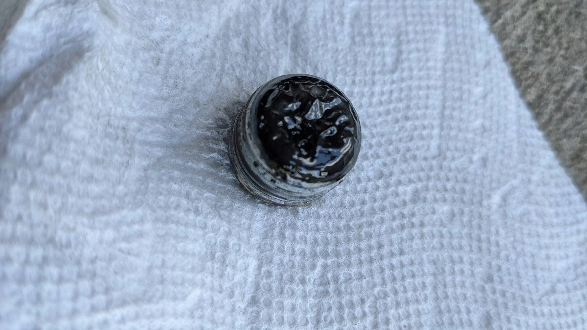

I had a few shavings in the front, but none in the rear. The front is attributed to the DS axle shaft issues that I was having (some galling on the pilot shaft). Subsequent changes (I have performed two total thus far) had very little metal on either plug.
Front:
Jeep Wrangler JL Differential oil change Front Plu
Rear:
Jeep Wrangler JL Differential oil change Rear Plu

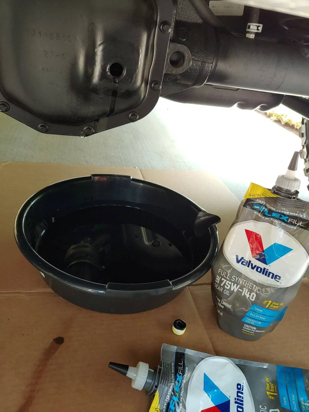

Well you guys talked me into doing this and it was super easy with the pouches and took 30min max. I have the Willys with the LSD so wanted to get this done sooner than later. Thanks again to all you forum members! Btw the Autozone by me always seem to have these gear oil pouches in stock and multiple weights.
Jeep Wrangler JL Differential oil change 20210823_123552
