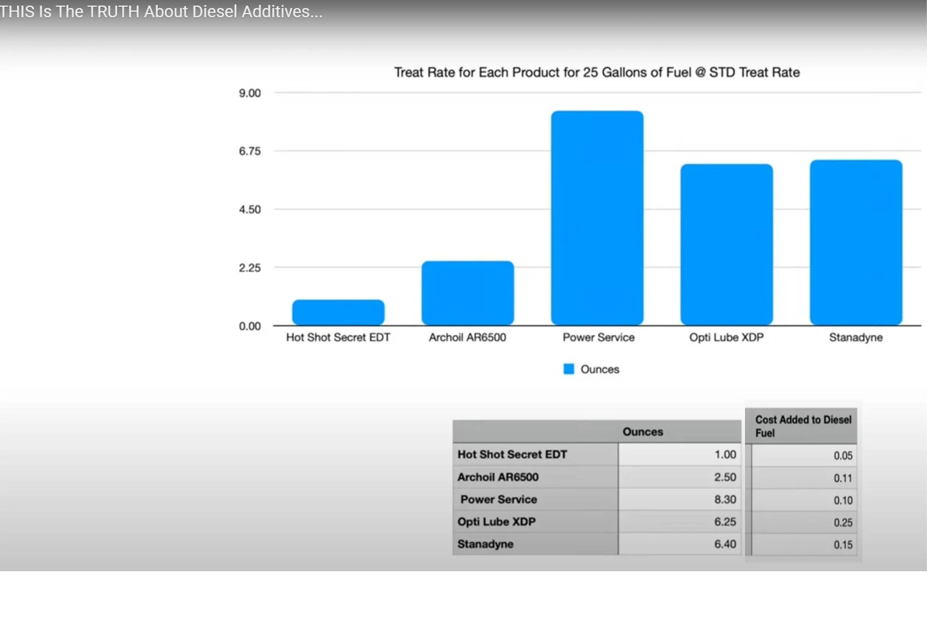

My opinion is similar in that having just some additional fuel lubrication is good enough to lower the chances of the CP4 failing. The other major concern for our engines is degraded lubrication of the crankshaft journals due to contamination from the emissions system.
But as I was watching the video, I kept wondering if the treatment rate made any difference. I'm no expert but I wondered if EDT's lower performance might have something to do with the lower (and cheaper) treatment rate. The top performer calls for 6x the EDT rate at 5x the cost. If I doubled the dosage, would I get more protection?
My last purchase of EDT, including tax, works out to 2.4¢/gal of diesel. It's easy carrying EDT's small bottle with integrated measuring cup to add 1/2 oz every fill up that's typically around 12 gal.
Jeep Wrangler JL Diesel engine additives test Fuel additive cost comparison
This was my thought as well. I use the performance dose of EDT which is essentially double. I wonder what that would do. Guessing I'll just switch to the XDP and put the 4oz in every fill-up.
