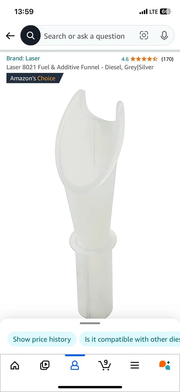

So totally stupid question… how do you get the additive into the tank? Neither of my funnels will go past the metal stopper.
Learned a trick from another EcoDiesel owner on this site -- I just put it into the filler neck opening -- upstream of the nozzle discriminator. There's a small hole there that allows it to drain into the tank.

Hmm I don’t think I got one with mine. At least I know what I need now. Thank you
*edit* found it, you’re awesome thank you!
You can one at Amazon very cheap.
You may also buy on Amazon a spare one.
