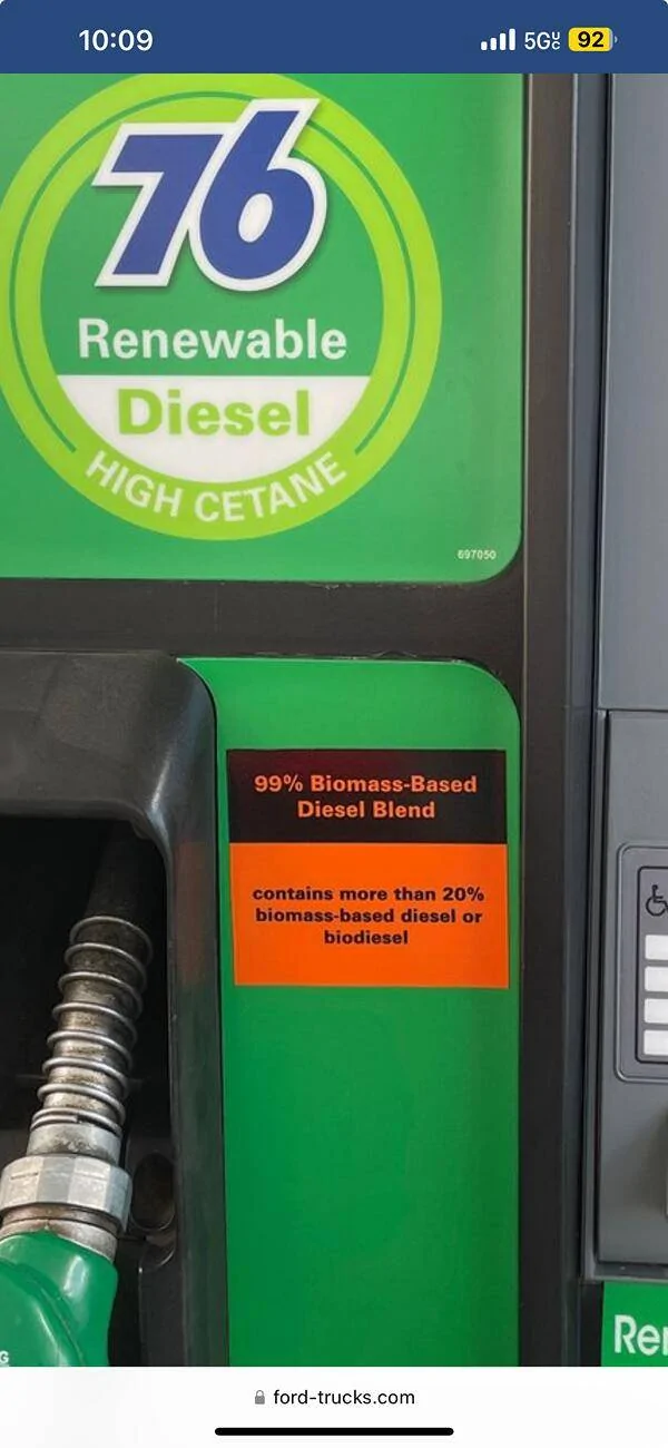

I’m not talking about a label that says B6 to B 20. I said some labels may contain language that doesn’t specify the quantity. This is the problem I have at some of the stations I fill up. That’s why I said MAY. At my local 76 where I get my renewable diesel it has that label.
from the label, how much buy diesel does this fuel have?

You cannot rely on the label alone as 100% certainty with the biodiesel content primarily from small operations. With large top-tier companies such as a Shell Chevron , Mobil etc., they’re labeling is gonna be far more reliable than low cost private brand station. I posted a label for Ratbert and you can see their in this case it is not clear. I have a Shell station that says that does say B 20 and since it is Shell there’s a high probability that it’s going to be accurate. The problem is that it’s not renewable diesel.
Now the other major problem with biodiesel from the pump is that it absorbs a lot of water. It also has a microbes and allergy as another problem. This is especially a big concern with the smaller private stations that do not have the same quality control as the others mentioned. This is why it’s a benefit to control the lubricity yourself and stay away from biodiesel.
Your also don’t like Cetane which you get from additives. You were saying it was a waste of money? The minimum requirements federally is 40 Cetane California 53. Renewable is 70 and it goes as high as 90 and the difference in how quiet and how responsive it is was very obvious when I use higher Cetane. It starts easier and creates less soot as well.
The thing that’s by far the worst is your use of Marvel mystery oil and a shortening of the life of your DPF and SCR by using it.

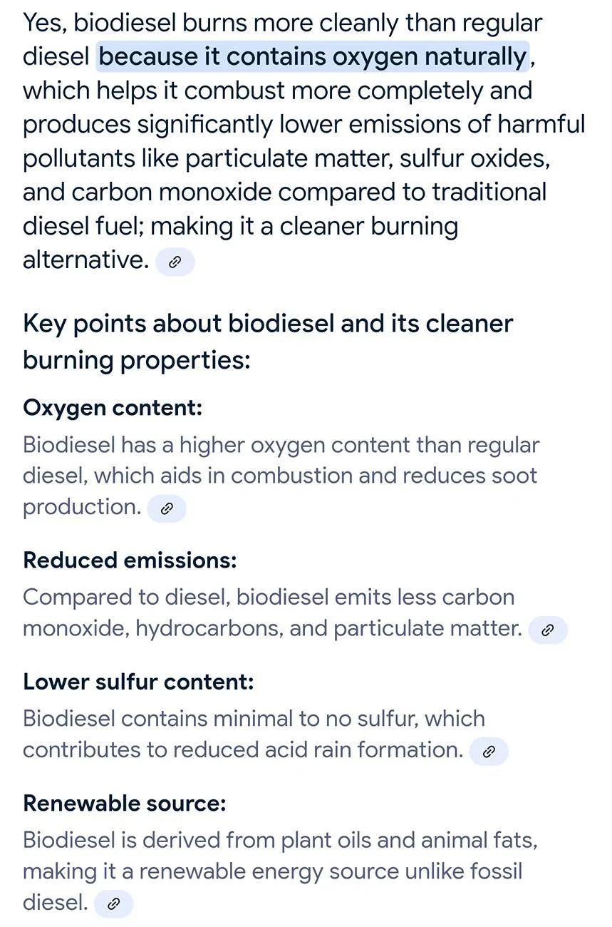

Actually one of the things I was reading last night, which I didn't feel the need to share because my post was already long enough, biodiesel actually burns more cleanly and wholy than regular petroleum based diesel.
So you're adding cetane to biodiesel fuel to make it burn more cleanly? Talk about overkill.
https://www.google.com/url?sa=t&sou...gMkKegQIRRAE&usg=AOvVaw0hliMeKmRjXSDrL6cgHtp7
Jeep Wrangler JL Diesel engine additives test 1000008263
It would be nice if you would provide some evidence for your preposterous claims. I'd love to go back and forth all day with you, but if you don't have anything other than your opinion, there's really no point in debating this subject any further.
"Absence of Evidence is not Evidence of Absence” - Carl Sagan

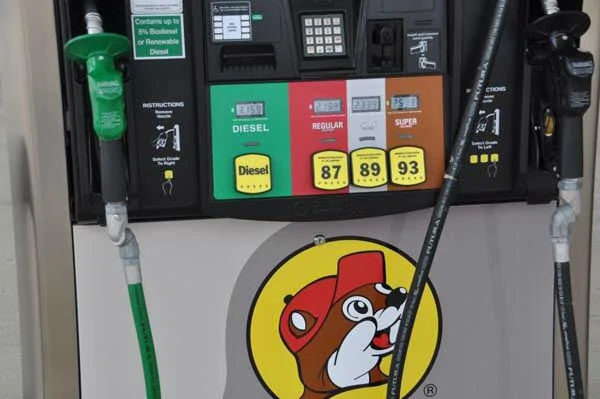

The maximum you can run that is approved for the EcoD is B20. Bio also has less BTUs of energy over petroleum based diesel as well but yes it burns cleaner and adds lubricity. One reason that it burns cleaner is that it has more Cetane 45-65, compared to petrol #2 40-55 Cetane. If Bio is in there though, keep in mind its a small percent that will give you the cleaner burning/slight higher Cetane. The cons are you need to be sure that the you know how much is in there and that is the problem when especially when your dealing with small private stations were the water and microbes/alga is a major concern. Some dealers after HPFP recall provided a pamphlet from Stellantis ask to use 5% Bio and only 20% in emergency and use the fuel in 30 days or less. The nice thing about renewable is that it doesn't have those problems and can be stored for years. Hospitals and Government generators have moved over to it for that long storage life.
I saw this pics from Bucees which says UP TO 5%. It could be ZERO % lol. There is no minimum % by federal law. I understand your trying to save a little $$ per gallon by no additives but I think its penny wise dollar foolish. Its $10G if the pump has a total melt down to replace everything. Its .10 cents a gallon to run EDT at full does. Also, don't forget if you raise Cetane you get back a bit with the MPG not to mentioned the good ones have the detergents to clean injectors and combustion chamber. I use Redline 85+ Catalyst plus 1oz per 10gallon Hotshots LX4 lube. I'll be going to Optilube once Im out with a blend of Boost and XL Extreme. I don't need antigel but if I did I would run the all in one.
Jeep Wrangler JL Diesel engine additives test 1738766322515-pv
Jeep Wrangler JL Diesel engine additives test 1000008311
I don't know why you're still talking about cetane nor lubricity, it's already been proven biodiesel is the best. I mean if you just want to debate with someone, then go bother someone else. I got better things to do than run around in circles with a broken record.
Have a good day. :facepalm:
